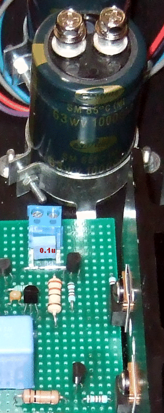

For the record a 100nF decoupling cap is a requirement in this confuguration. I wish I did a distortion plot vs. frequency before to compare. I will do it at some point.
The speakers have completely dissappeared and the soundstage blew open to put it mildly. High frequency high energy like cymbals have taken on a very real presentation.
They were 200B K72.
What did you use? 5mm PP? Quite long common cables till the regs now, should have been blending with enough inductance, even bringing RF inside. How long, 1m+? I use 0.1uF there too but with just up to 10cm twisted pair from the filter caps, nothing really changed.
I only had 100nF MKT's. So I used an Axial PP from Cornell Dubier. I am using a 1M XLR for power feed. 20 awg wire.
Small size mainly matters. Also 10n from RCA input ground rings locally to chassis clean up some muck if riding on the TT cable shield before it enters the circuit's input ground point. Audibly so in some cases. Adding more depth.

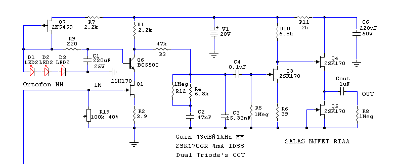

I have mixed news but I still want to jump in with both feet. Today I received 250 2SK170GR’s from Bangkok Thailand. I thought that they were going to be BL’s. They are not.
This journey is about learning to use JFET’s and measurement software. I hope the GR’s will work. I thought I would ask before I start to sort by current.
My cart is a Ortofon OMB 10. My present RIAA preamplifier has about 40db of gain it feeds into a buffer line stage followed by a stepped attenuator and followed by 6BQ6GTB tubes with 5000 : 300 output transformers. This plays into Sennheiser HD600’s headphones. There is about 20db of headroom on the attenuator at a comfort listening level.
Should I keep shopping for BL’s? Or look for highish pairs from the GR’s?

Hi DT, what's up? That PDF you got its good but a bit long in the tooth for some better tunings. When you will have some enough Jfets and having noted down your pairs, you will tell me about those, and about the cart to use, plus system gain and I will give you best values circuits. Its not easy to make a low noise high gain circuit perfect on first shot, but all made it in the end. Its SE no loop feedback and has its precision care demands also.

If they are genuine items we can design for GR when not looking for top gain and MM lends for that. Try your hand on this one. Use an LM317 reg firstly just to see if the FETs behave as expected for gain & low noise. The 100k input load trimmer connected as a rheostat will let you calibrate tone, since the omnipresent 47k load for MM is a myth.
