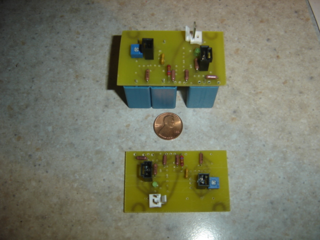

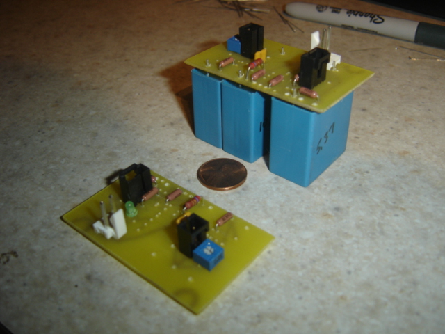

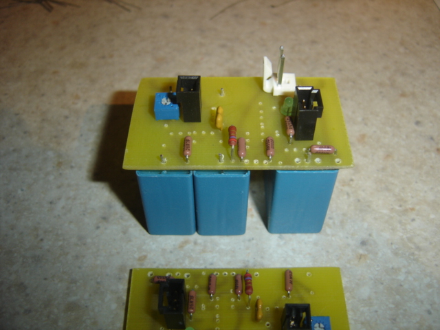

My take of the Salas Shunt V1.2
Thought I would post some progress made on the next upgrade to my simplistic jfet RIAA. In the photos you can see the assemblage of a V1.2 shunt regulator. This is as compact as I think I can make it. Polyprop MKP capacitors mounted underneath the circuit. Component size is critical and I made several errors in ordering so I am presently waiting for my next shipment of resistors before I install the FETS and BJT's. Both channels are matched to .1% so far. Can't wait to see if this thing powers up in a stable fashion. One of the dangers is that it doesn't work as there is not much room for corrections and addons.
I put a US penny in for size comparison
