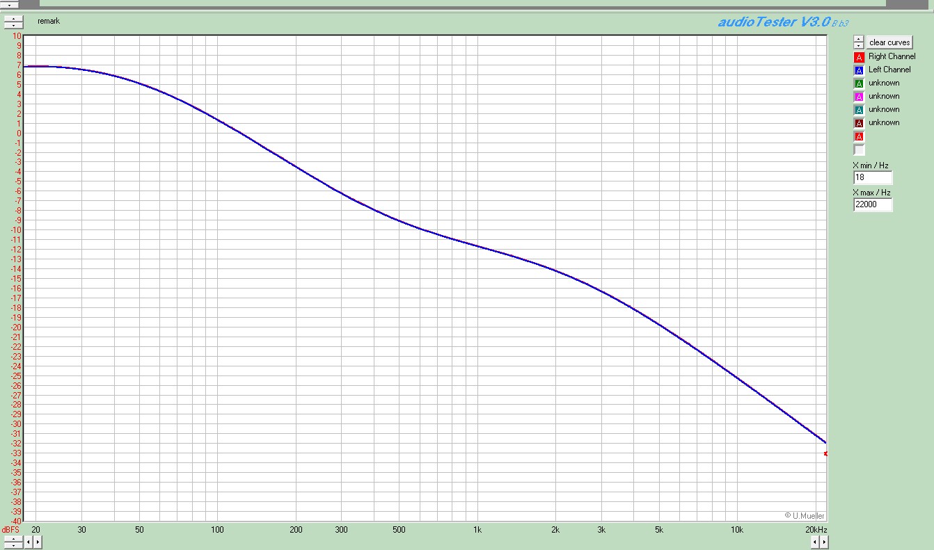

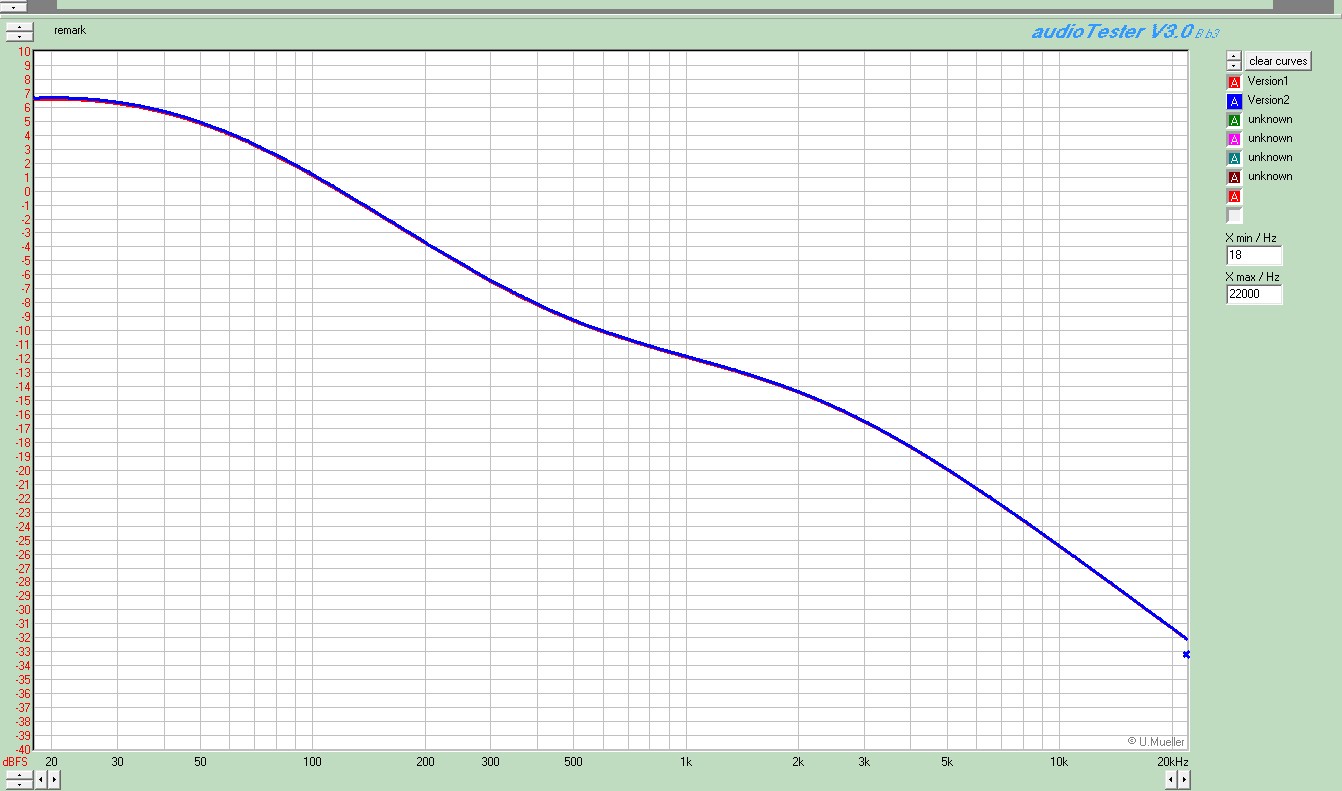

Will Test in a few. This is the RIAA curves at .30mV. They appear to have shifted upward. Red is Version 1 pc board and Red is Version 2. They are even more identical than before.

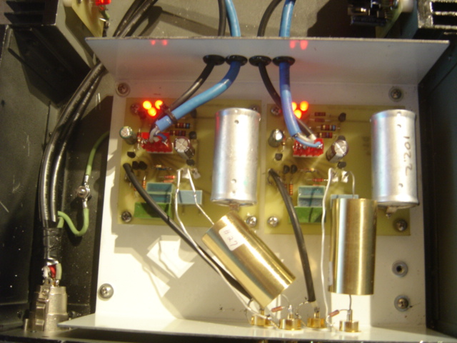

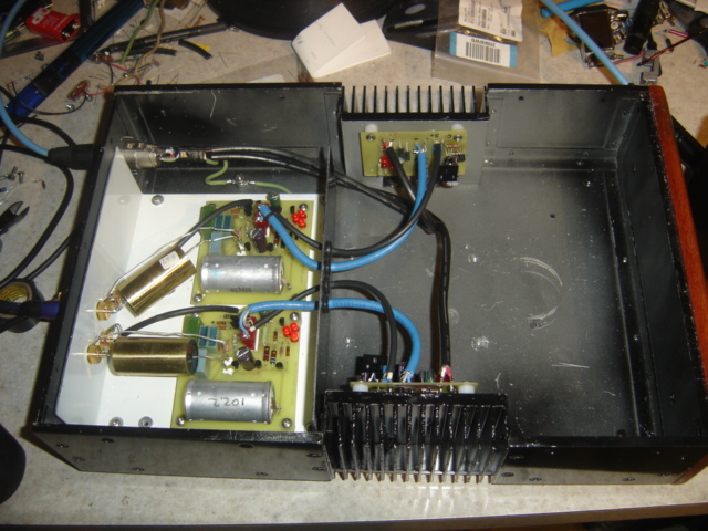

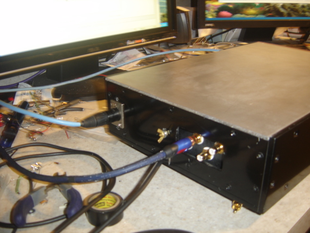

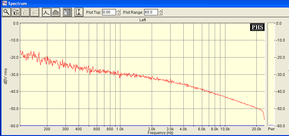

DT, this is a worth while build. I learned more on this build, thanks to Salas et. al. than I have on any other build. Especially in the measureing department. Precision is critical. The results are spectacular.
I will share my final graphs for a while, as I am going to listen now. Both channels are now version 2 of the pc board. The transformer and PS Filter are mounted on an external breadboard till I make a chassis.
Plots are 1Vrms = 0dBs.
Left = Blue Right = Red.
0mV and 0.3mV 1kHz
RIAA response graph. (Could not get more matched)

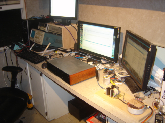

Also threw a few photos of my sanctuary. Needs a cleaning now.
P.S. If you notice the chassis is almost empty now.... Enough room for a version 1.2 Shunt Regulator;)

Excellent. You wouldn't wait for the R-Core after all.:)
*You could try those filter curves taken without the correction file too. Not sure how they tie when the card goes at low dB. If they were plus 1dB off in the highs it would have been subjectively very annoying too. You should centre the curves on the plot at 1kHz not 20Hz, as well. They normally deviate both sides edges where the card wimps out a bit.
R core will fit perfectly well in the PSU enclosure. I didn't want to split the chassis initially as I was waiting for the Ultimate RIAA to do that with. This is pretty close, I won't be shopping for a while.
Listening to a 1/2 Mastered version of Weather Report 8:30 live from Tokyo. I am about in the 5th row center. The sax was walking across the stage during a solo.
The system is pretty flat from about 20 to 20k with the MAudio. Another reason I stayed with it.

The Measureing Department
Hello,
The measuring department is half the attraction. I have a new to me bench courtesy of UC Davis surplus store, Pete Millett sound card interface, computer and Audio Tester 3.0 ready to go.
This seems like the project and good people to develop the tools and skills with.
