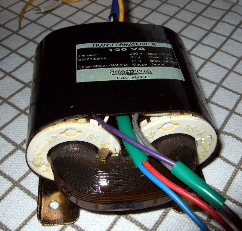

Indian? They were supposed to be "made in china", weren't they?
I also got my "made in china" (clearly labelled) split bobbins Hammond 229 for DCB1.... 🙂

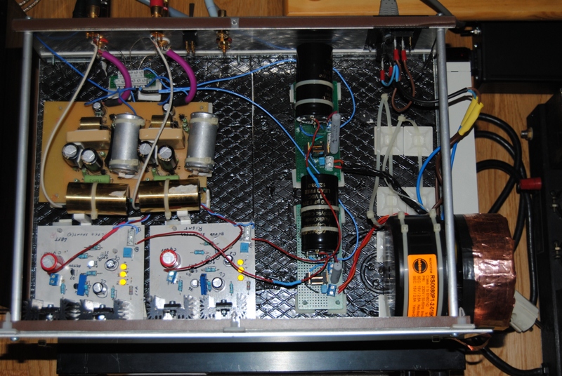

BTW, I'm in doubt how to orient it to get the minimum hum.... I guess I must show the iron, not the coils, to the pcb, am I right?

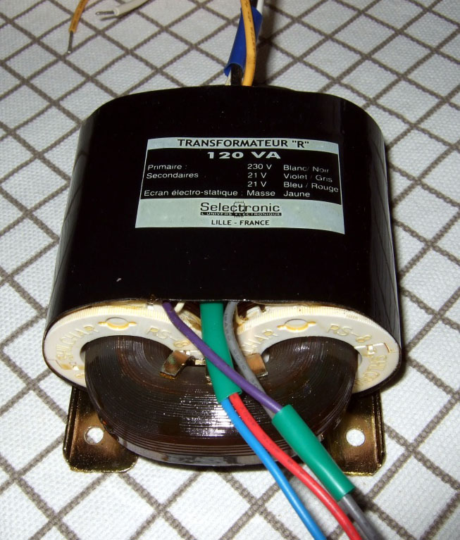

We figured out OEM, but its not China in the end. I see Indian electrical factory on the bobbins and on back of its base. So its different than the ones on Ebay.
For the Hammond I don't know from experience with it, but the corners should be most offending. I would try in length and perpendicular to the board. Happy new year to you too.

The company is a well known manufacturer in india - he had japanese collabration meaning very tight quality control from the early years. Surprisingly they started manufacturing R-core transformers first.

The list cost is good. 36 Euro for 120VA. I just saw a 100W Chinese one on e-bay for US$45. Bad thing is they don't arrange careful shipping costs within Europe at least. They used a box that it could take a tanker ship inside in my case. Could have been 1/6th the volume easily. The Indian factory looks learned. Here is their page about the R-Core they make.
