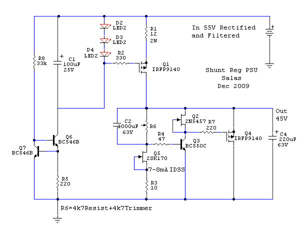

I believe that I need 1 double lsk389 more or 2 singles k170, looking for more njfets I have sgls K170V, one Idss 10,67 & the other Idss 10,76, I suppose that can use it?
Thks again for your kind help
Merlin El Mago
You can use whatever 10-11mA matched between positions and channels. The 27R can be a 50R trimmer so to match your channels finer for output level around that original value, so to offset slight gain differences from less than perfect matching naturally.
Can this be done with "normal" 2sk170bl ?
I have some in that 10.5mA range
Can this version compete with the previous 56dB 37V version if used without the bypassing EL ?
besides the higher gain and working voltage, what are the main differences ?
Is there any kind of "special" dip switch ?
Of course. Mind you, isn't a matter of previous, but of different IDSS. This one will have 3dB less hiss though, since it is aimed for Low MC too. Double In-Line Package pcb switches plain vanilla as on your computer's motherboard will do. I would prefer pins and a nice solder joint non the less, if you would not bother not to be changing carts on the fly.
Well I suppose that instead an internal dip swicth can be done by a external toggle switch.
I mind is to suppres C10 so instead 63dBs ultra low gain MC will be 57dBs mid gain MC, that's possibility is very good for me due to the fact that I have several MS carts ultra low gain & mid gain
Don't be much afraid of C10. Its an SE phono full of capacitive coupling and ''creative'' passive parts selection cookery anyway.
