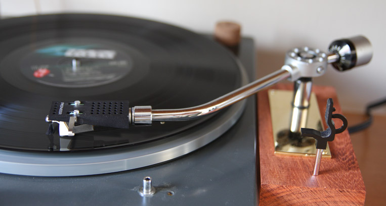

A pic of the old Lenco put in action again after collecting dust in the attic. The arm is from a garbage find Sony TT which seems to combine nicely with the Stanton 881S.

Salas said:
A very retro cool pic!! I like it. Did you get improvements with this set up over your last one? Enjoying less sibilance etc?
Thank you. It's true DIY :)
As you mentioned sibilance depends largely on setup -which is in progress- but it's better than before. Even with this after market needle the 881s is indeed a fine cartridge, although a little noisy. On two meters distance I can hear high pitched sounds arrive ahead of the loudspeakers. A thin felt isolation and tightning the headshell screws gave some improvement but still...
Next will be some experiments with Ortofon M20 moving iron, Yamaha CG6500, Yamaha MC-9, Piezo YM308 and an ADC ZLM.
