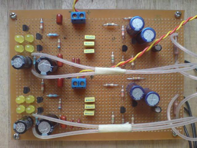

Trying to attach a picture of my built #1 of Salas RIAA. Hope it works

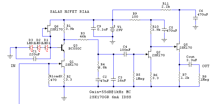

Sound fading away with higher voltage
Hello, I have built the RIAA and it worked well with three small 9 volt batteries in series. With the Shunt, and higher voltage (29 v), I find that the volume is much reduced. The sound is also distorted. The RIAA-stage is built with 2sk170 gr, idss 5.9-6.5 mA. The bl grade is difficult to get. What changes can be done?
Tham said:I am attempting to attach it here. Hope it work this time🙂
Very nice p2p! And you got nice enough sound with no special components! Value for money.😉

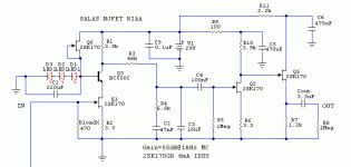

Re: Sound fading away with higher voltage
The Idss you built it with has directly to do with the voltage and loading values used. The idss range I mention on the schematics, is central to the design, and to be followed. Link me to the exact version you built and I will simulate it with 6.2mA Idss average so to let you know where is best to set the shunt and/or possibly change some resistor value. What is the output of your cartridge?
iwahn said:Hello, I have built the RIAA and it worked well with three small 9 volt batteries in series. With the Shunt, and higher voltage (29 v), I find that the volume is much reduced. The sound is also distorted. The RIAA-stage is built with 2sk170 gr, idss 5.9-6.5 mA. The bl grade is difficult to get. What changes can be done?
Hi Salas. I downloaded PSGR´s RIAA Document Beta2, and built the version with 48 db amplifying. The pick up is a Denon dl103, 0.3 mv.
Well, your choices are at odds with two things. One is having 2SK170GR and plugging them in a 8-9mA Idss BL recommended schematic, second is that your cart is too low for choosing 48dB gain.
Anyway, here are the values for your GRs, 29V shunt, and Denon DL103. Even the load resistor is OK as it is recommended. For the 46k, use two 92k in parallel. Take out one Led and jumper its position. You use 3. Make sure that your Leds are 1.8V each, and that your GRs are matched per position between channels. Use your strongest pair for first stage.
Regards.
Regards.

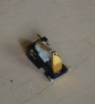

Yes, but to hear well at all with your DL103 you will need some gain meantime. Before you decide on a new one, remove 103's plastic body. Nude is a whole new cart. There are guides. Even a video on YouTube.

Salas, thanks for looking. I left some room for larger components for RIAA and the output cap but do not think that it will be sufficient for a FT-2 and so on. May do another one again later p2p on Teflon sheet when I get hold of the recommended components 🙂 .
That will be best. One nice and cheap with successful tone as you already have, and a bigger board experimental with parts one, so to compare step by step and tune in for that elusive synergistic uber tone! Did you add any gain to your T-Amp, or you feel its OK for your room after all? Killed the lights noise?
Salas, it is actually loud enough with volume control almost all the way up. Do not think I need to increase the gain of the T amp unless the system is moved to a bigger room.
