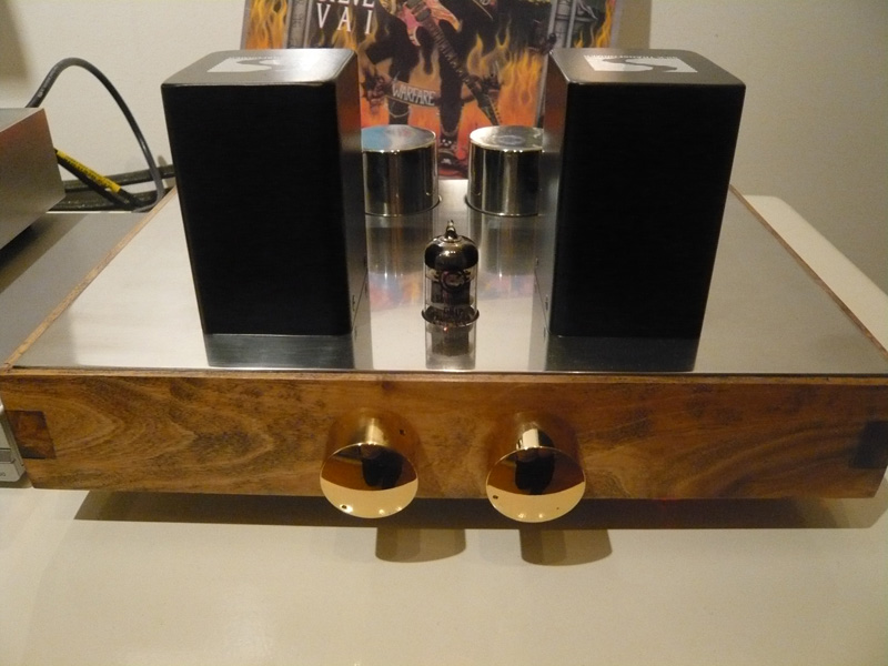

My preamp plays better than ever. It has less noise (still has some hum though), better dynamics, better soundstaging and the sound has a better "flow" to it. If I where to critisize the bass may be a bit thinner but though a lot more precise. The new reg replaced a tube-based reg where I used the 6N1P tube in the pic.
