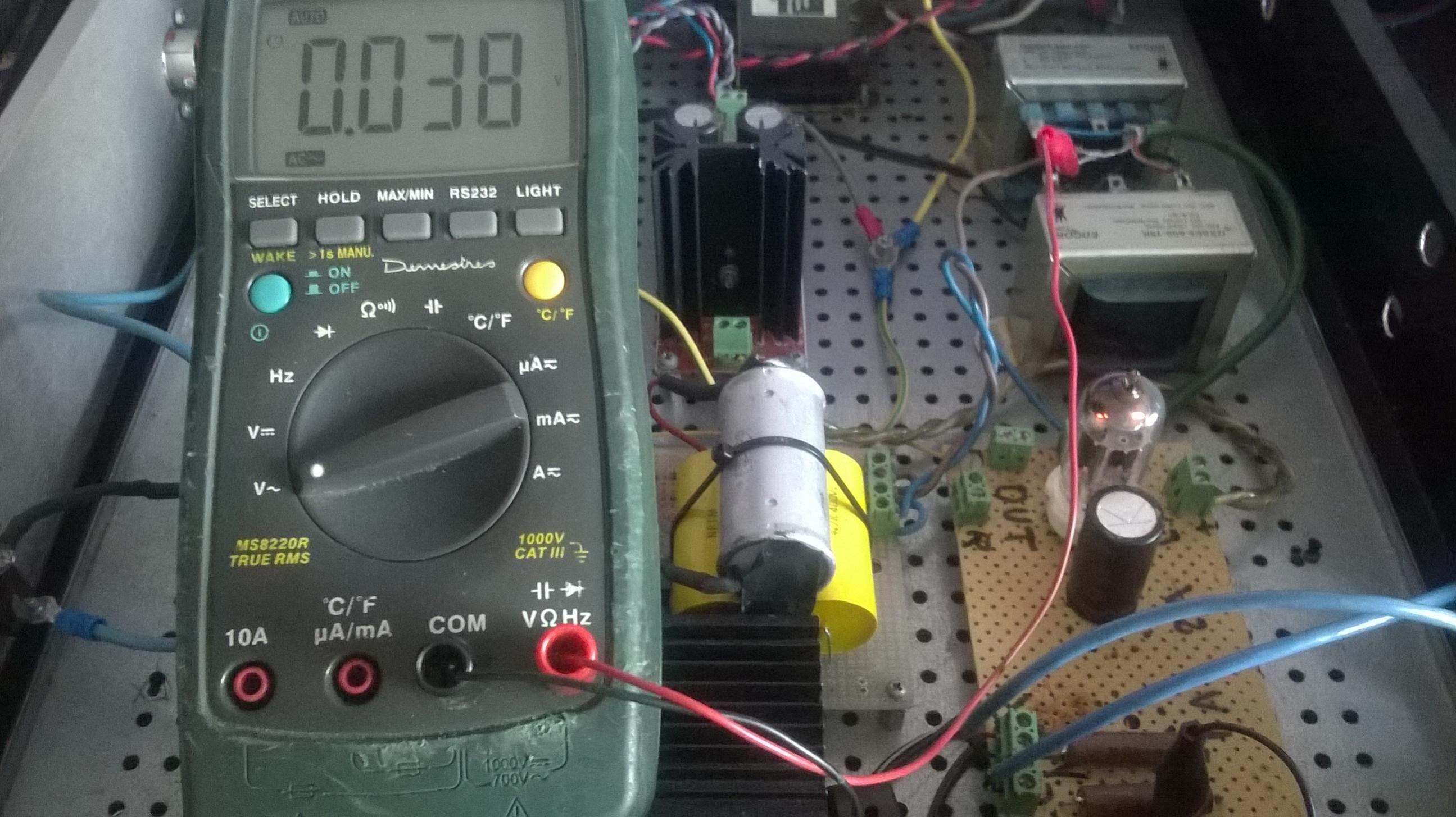

Hi Salas, after weeks of using the regulator without any stability problem, this evening the output voltage just started to fluctuate. Now it has aground 10 V peak to peak fluctuation at the output, the output is set at 270V. I have checked the FET and PNP transistors and they all seem ok.
CCS is working fine (I can very the constant current from the pot). Diode D3 is ok also.
Can it be the IRF840?
Is it ok that I have a common heat sink for both DN2540 and IRF840? Does it go into thermal disequilibrium?

It can be the 840 if it was working under much heat. About common sink if the MOSFETS are well insulated and the heat is not excessive it should be alright. I mean if it is a build's basic configuration problem and not a part's failure it wouldn't work well for weeks in the first place.

The temperature gets a bit hot... I’ll use a bigger heatsink and change IRF840.

Did you check its insulation to the sink has not gone conductive or measured if it shows few Volts Vgs or not? If not, its certainly broken.
I checked it and it’s ok. One thing that I forgot to mention... I don’t have any thermal paste in there. That might help a lot to reach thermal runaway. I’ll try to find some paste today in the computer shops around Dublin.

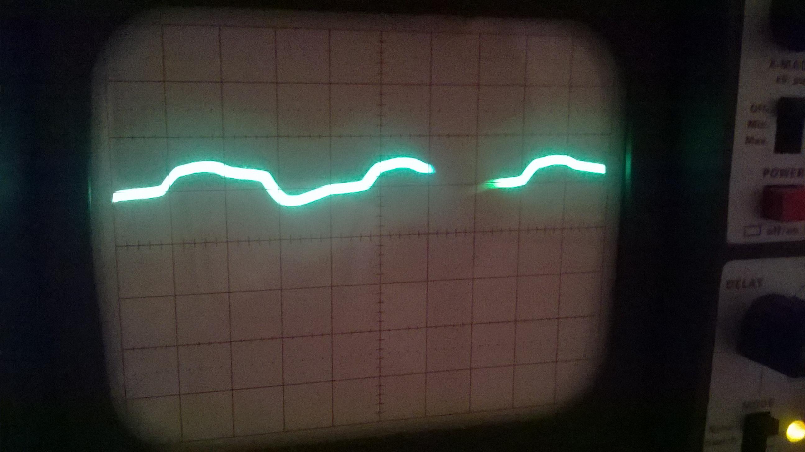

Better use the scope (with short ground probe tip attachment) to see what that AC indication is about in that installation. EMI/RFI on non-shielded probe wires? Instability? Hum?
Probe X10 to have bandwidth. Vertical set at the most sensitive, horizontal just go up and down to find something or not, but 0.2mS is a good starting point for wide view.
5 ms
Shows four squares period = 20mS = 50Hz = hum (can be groundloop or transformer field or whatever, PSU ripple its not as it would be 100Hz, review the build's arrangement, wiring scheme, and wires dressing)
