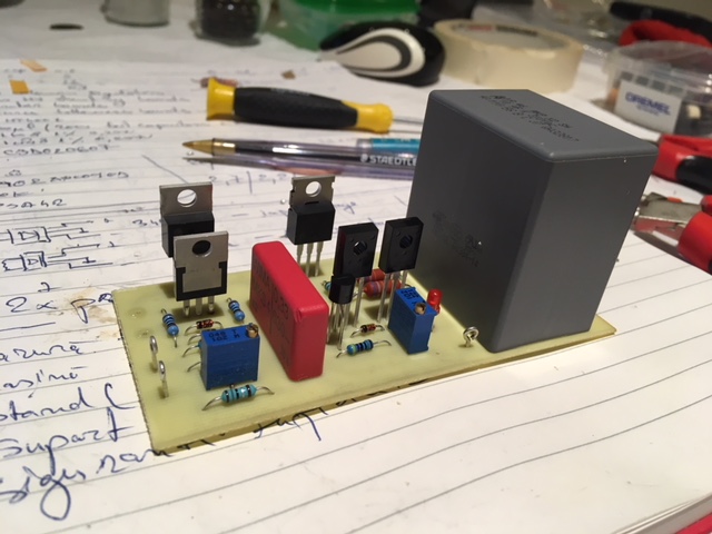

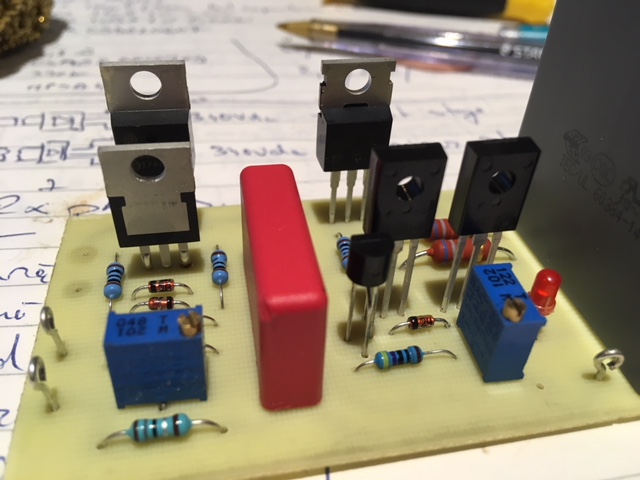

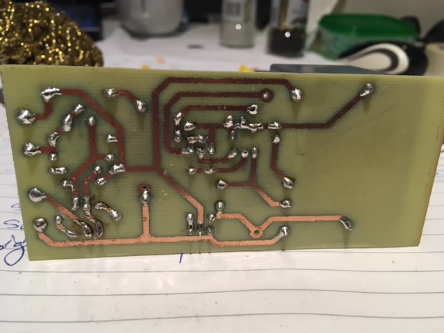

Hi Salas,
I have designed a PCB and built SSHV2 and I have a problem with it. I can't properly change the output voltage from R11 due to D3.
If I eliminate D3, everything is all good.
I have read as much as this this thread as my time allows and I found out about the schottky MBR1100.
I don't have this on hand... can I use any schottky rated at 100Vdc minimum and 2A?
Attached some pictures of my build.
Best regards,
Silviu
Best regards,
Silviu
Have you checked the D3? Have you solder it in the right direction (anode-cathode)?
You can use any power diode here. I'd use 5A or more though.

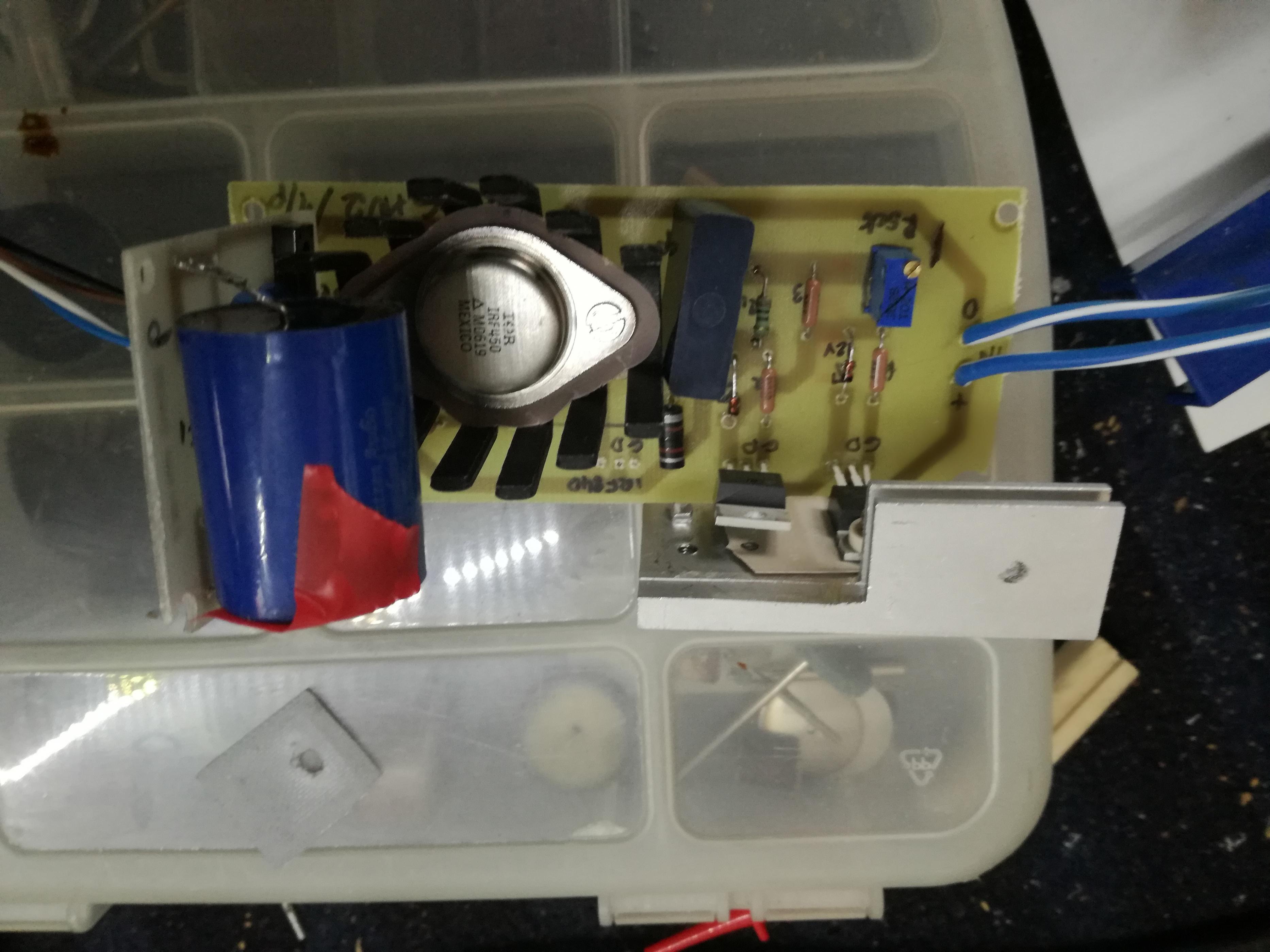

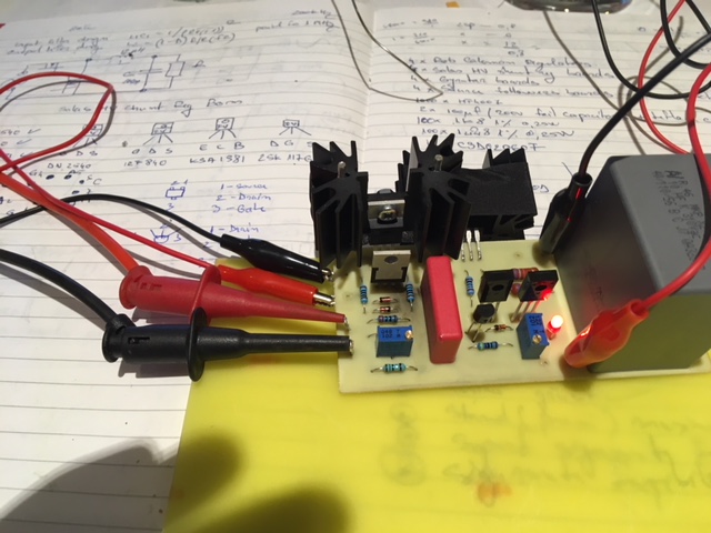

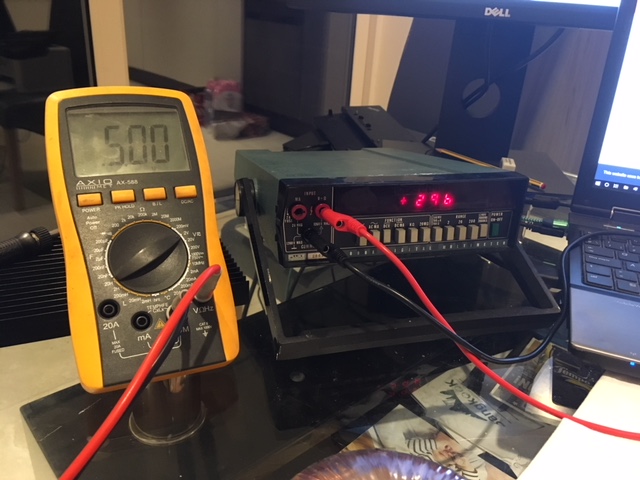

Hi all 🙂
first of all very thank you all for this project and all helpful information. I just finished my pcb version of Salas. IRF 450 instead of 840. Everything works fine, but I have few questions:
Vin 304.96VDC
Vout on dummy load 207,3VDC (stable after just few minutes); my target
Rdummy 11,47k Idummy 18,07mA
Vacross 10,26ohm 0,2252V --> I 22,5mA
Vgs IRF450 3,09V
Nothing is hot, first DN2540 has normal temperature (warm), IRF450 TO-3 case with typical heat sink little bit warm.
Is 98V not too big? Should I drop more volts on filter section?
IRF450 was used. Wrong choice?
You said 20mA own cosumption, here much more less or I cannot make proper calculation.
Any suggestion?

Regarding 98V drop across reg you may use less after you will up the CCS current if the DN MOSFET will become too hot. Depends on sinking.
It looks like you have good sinking for the DN but little for the 450.
IRF450 is slower (more pF) but robust and if stable not too bad for a substitute.
Calculation is easy. I_load+I_own=Set CCS. Although the reg can work to very few own mA, at about own 20mA it shows good output impedance. The more own (shunt) mA the better performance but will also warm up both MOSFETS more. You must make a practical decision.
