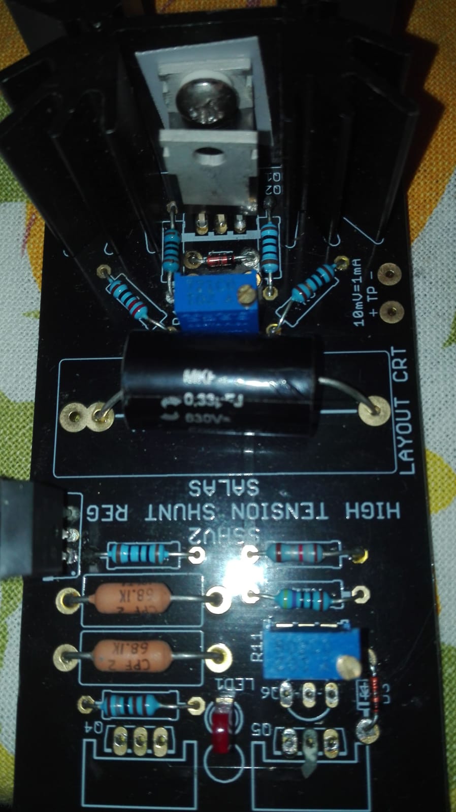

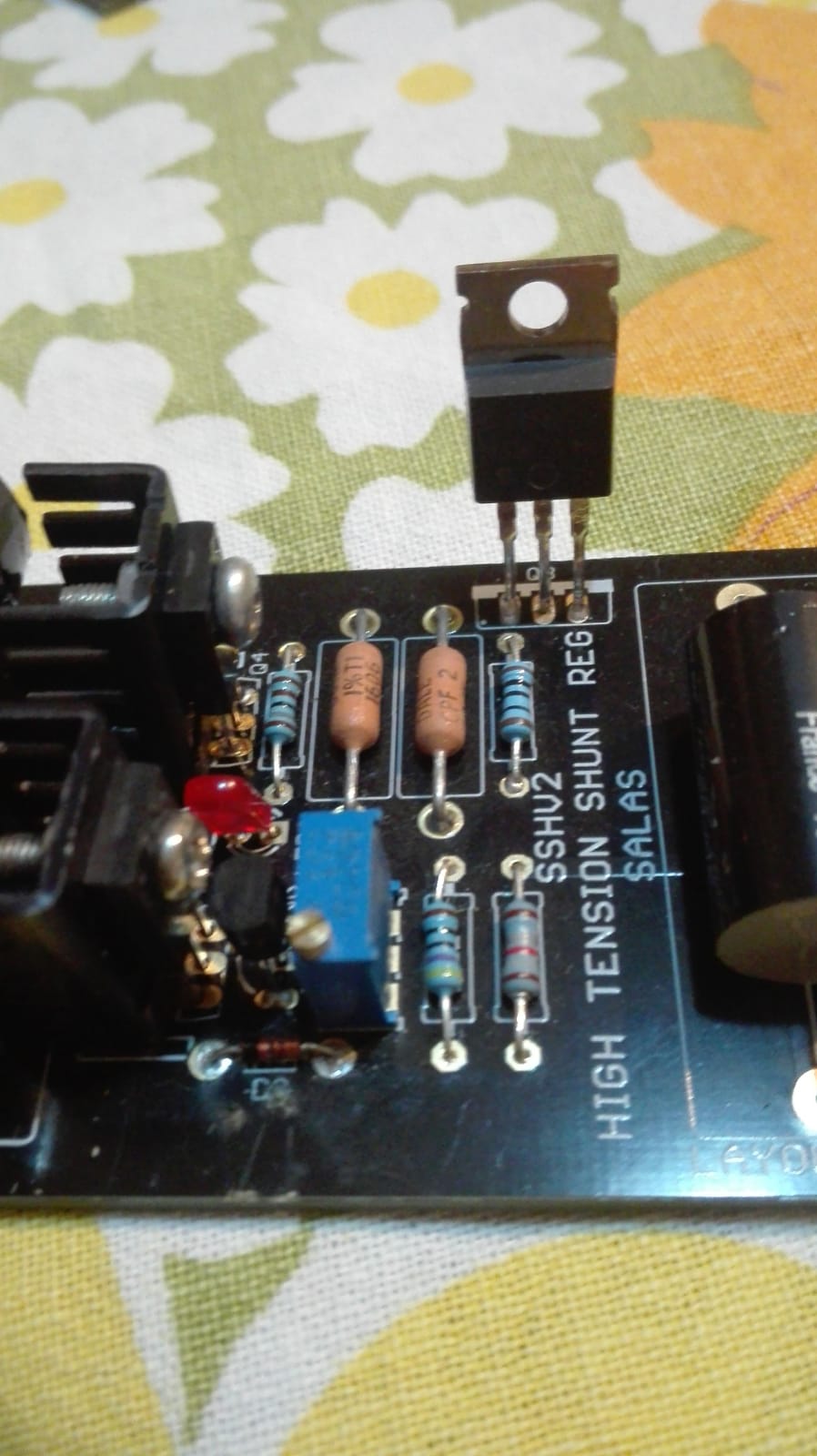

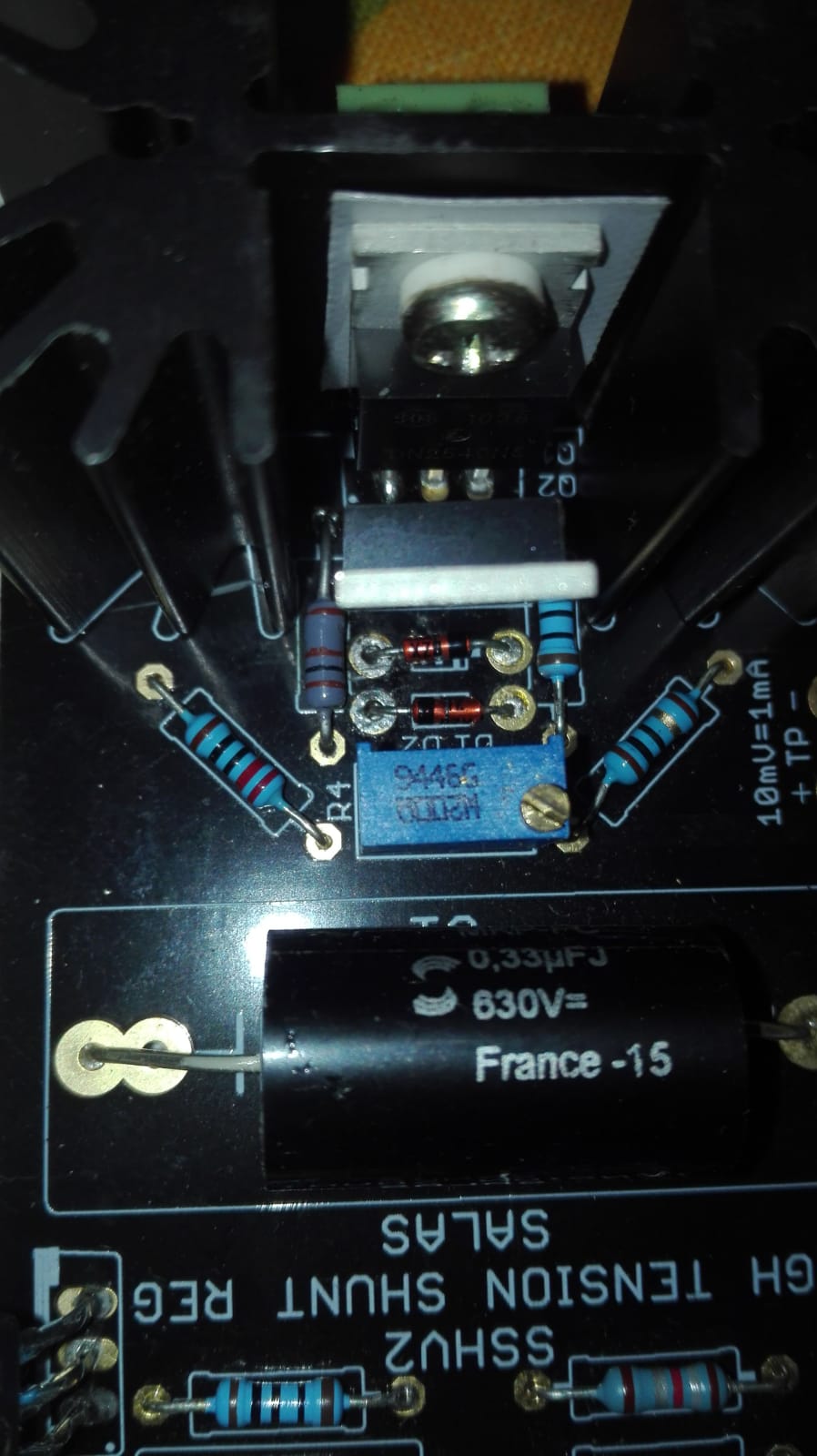

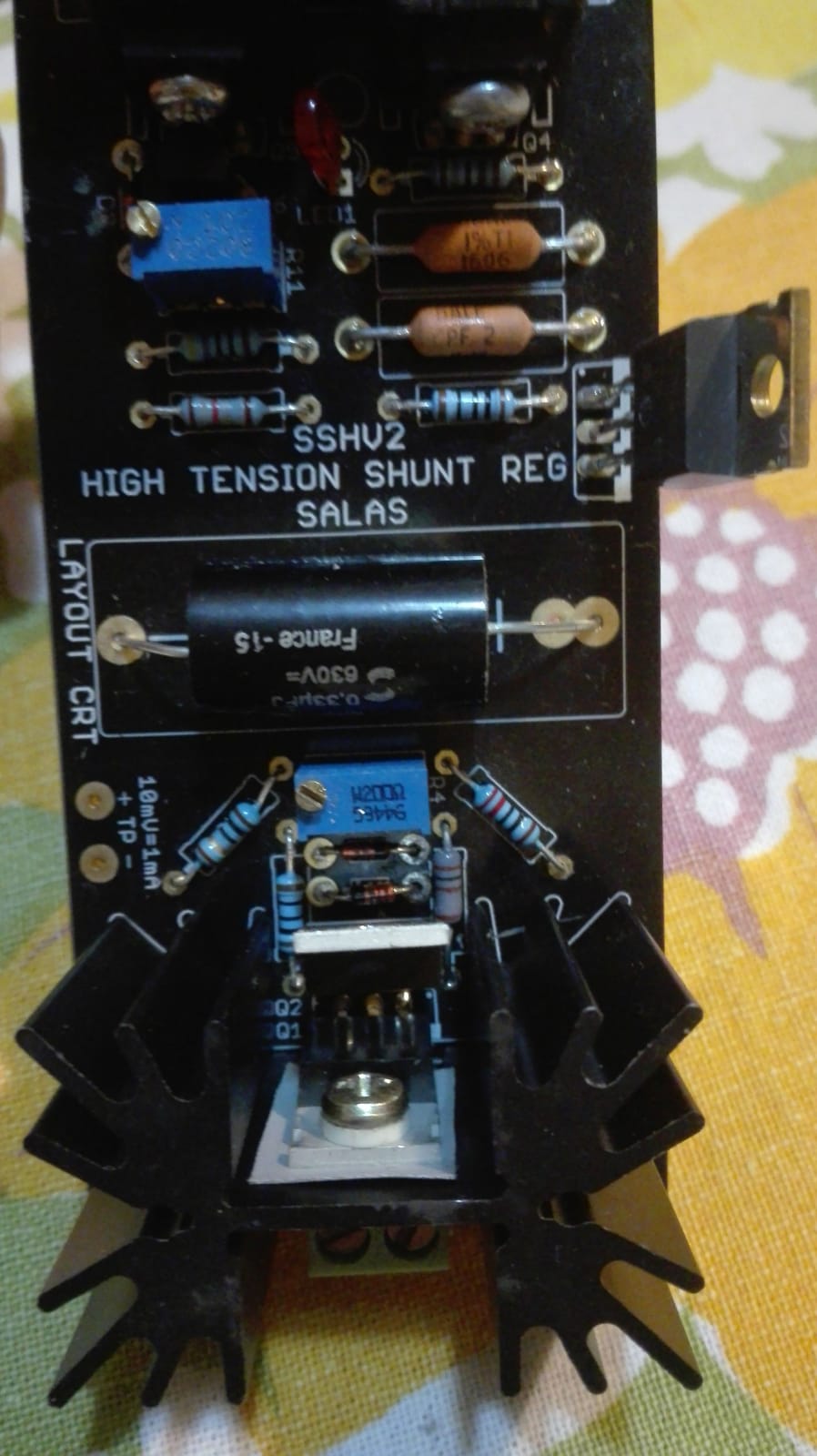

Hi everyone
a few weeks ago I can not make these cards work (those of Salas HV shunt).
For twice the resistance R1 is always burnt but I can not understand where I may have failed.
as soon as I can publish the photos of the cards
Would you have advice to give me?
Hi everyone
Burned R1 usually tells there is at least a burned Q1 too. What were the conditions? Info is needed to evaluate causes. In post #1 there is also a link on how to safely troubleshoot and repair the reg itself.
