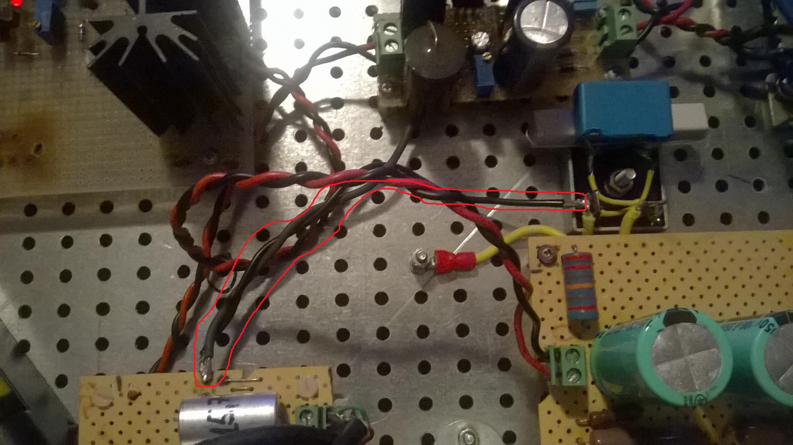

Still the same. I will try connecting signal ground to OPT shell.

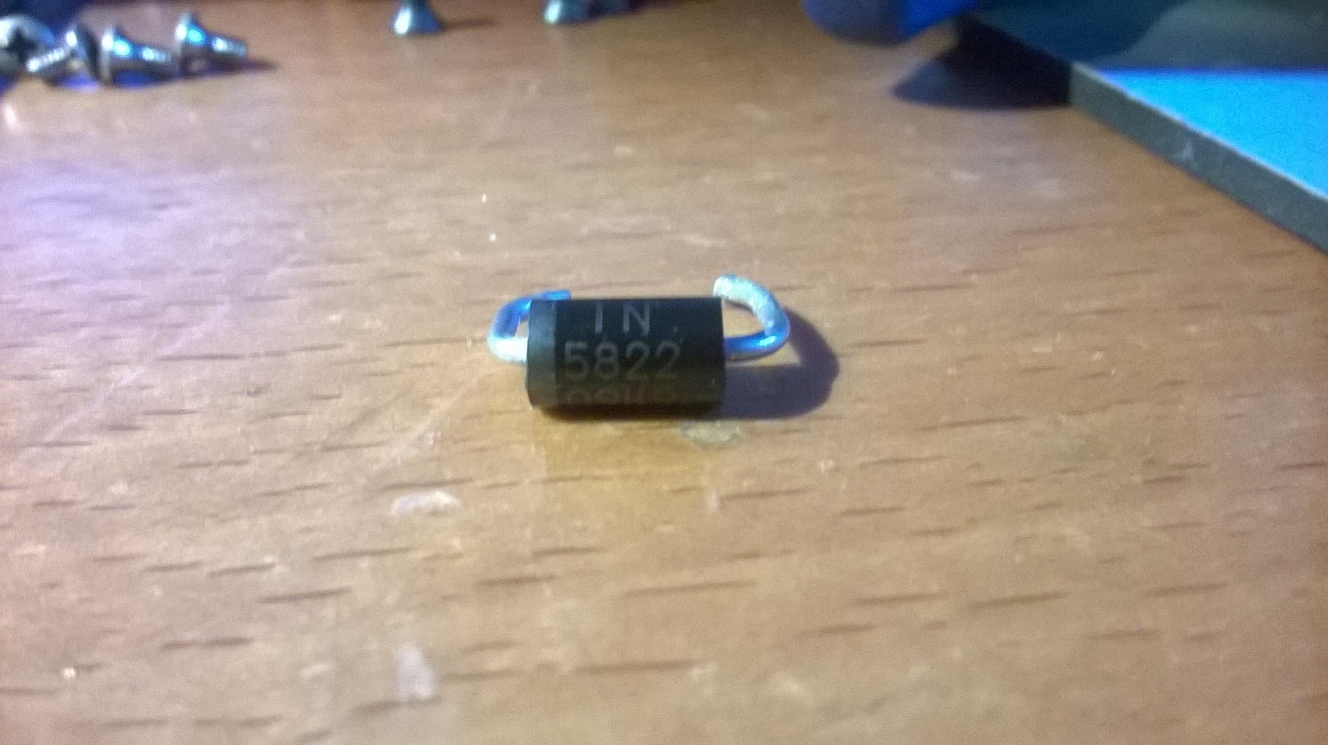

R1 Q1 are usually the victims, sometimes along Q4 or Q5, Q6, D3. Q3 not so often. There is also a safe troubleshooting example case link in post #1. If you will use a heavy duty Schottky diode for D3 you may prevent damage from further such shorting accidents. Replace D1, D2, with common diodes even if handier than specific Zeners in your stash as you are at it just in case they got a hit.
