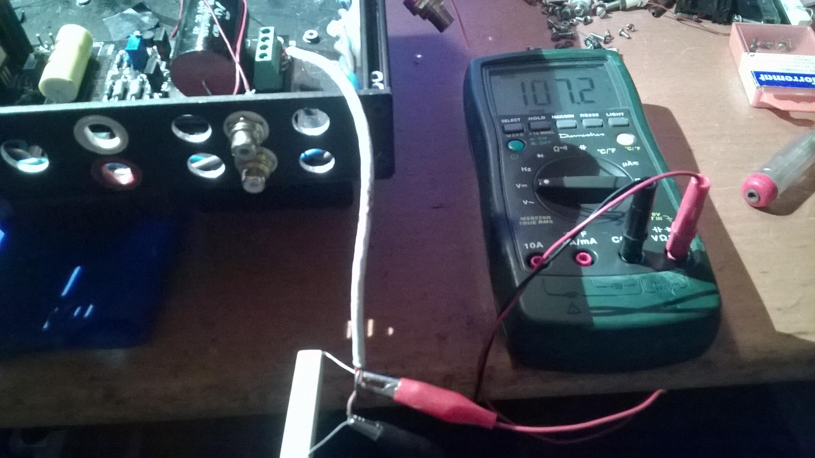

Rectifier hybrid Graetz AZ1 + two UF4007 (Between power transformer and the AZ1 one 100 ohms resistor.
Now only one 125VAC, attached Vout pic.
This arrangement looks safer.
Let us know how it goes. Too much voltage drop before.
That Vout computes with that max ccs and load. Problem is more ccs is needed with that load. Use a test load representative of final load. Is Q2 ok? What's Q2's VDS & VGS?
Yes I also understood that I need more CCS, I calculate the dummy load 4K7 to get 150V 30mA to simulate the 26 preamp.

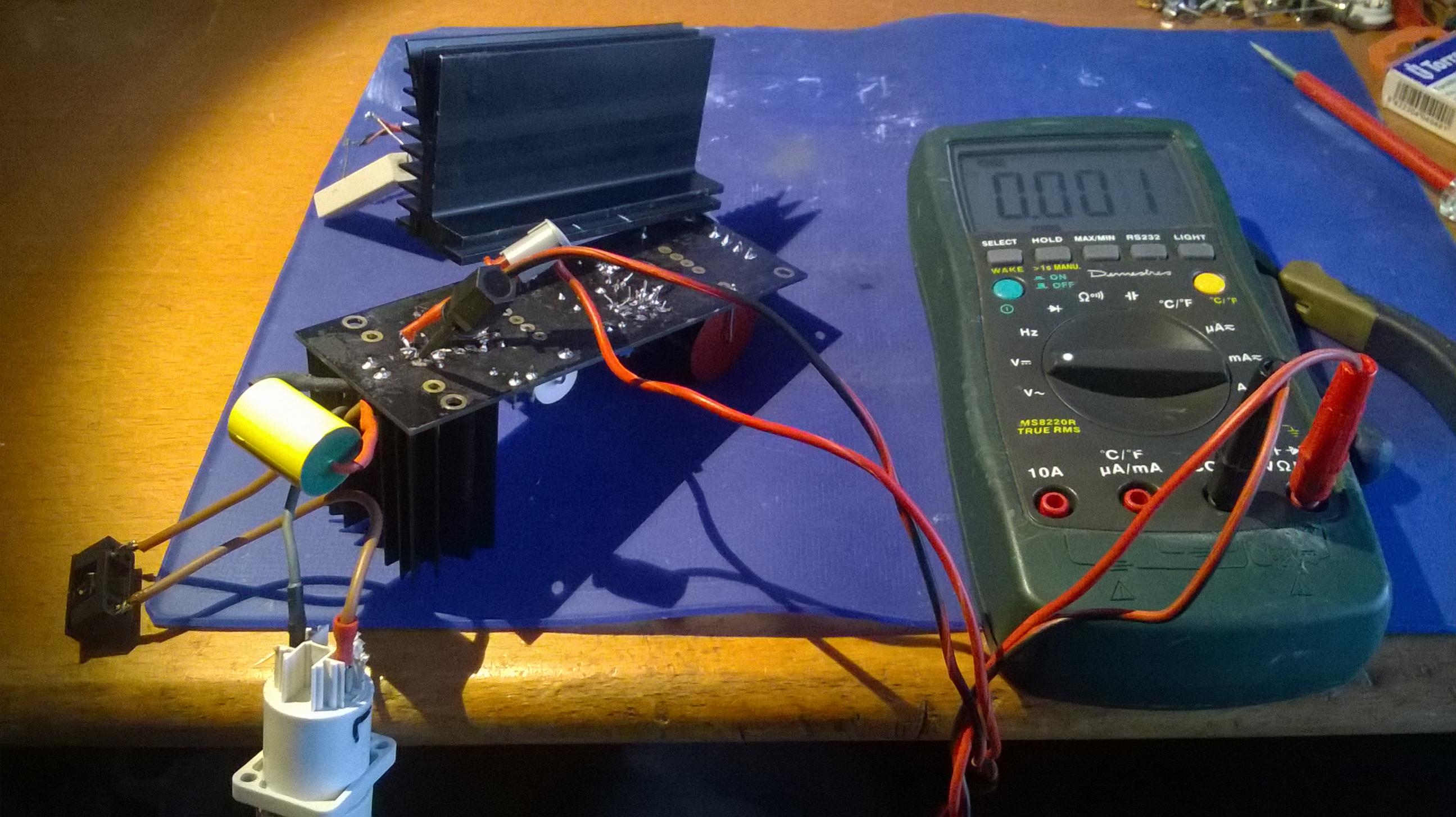

VDS 0.254
VGS -0.210
VDS 0.254
VGS -0.210
It takes about 1.5-2.5V VDS & VGS in this cascode. Maybe Q2 is problematic. BTW remember to use input connector raw dc wiring decoupling cap when experimenting.
Look to gate Zeners first. Take them out and leave their spots blank. Q1 must develop about -1.5V Vgs for 40mA which is Q2's Vds also as applied in the cascode. Q2 should have about same Vgs in its own turn.
1uF decoupling is OK for avoiding basic chance of test rig oscillation.
Also use a 100-200mA fast blow fuse inline with the raw feed to input connector or the lab PSU's CC mode protection at same mA when testing the CCS in low voltage.

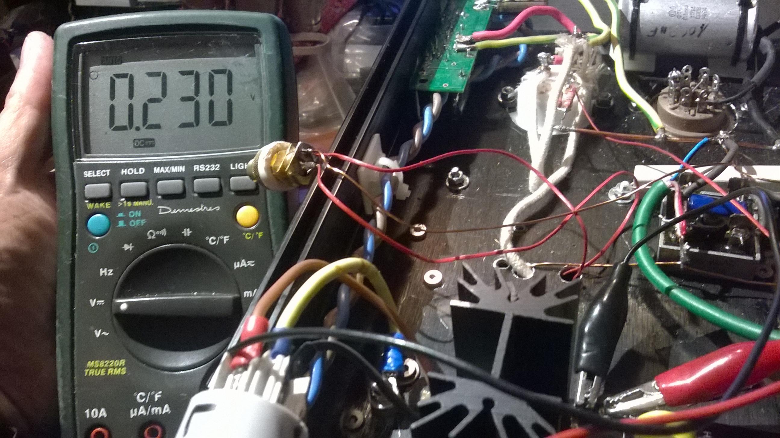

Attached pics with measurements😡
PSU Vin 44V
Q1 VGS 26V
Q2 VDS -13.8V
I forgot to tell you that before this measurement I changed the two gate resistors of DN2540
