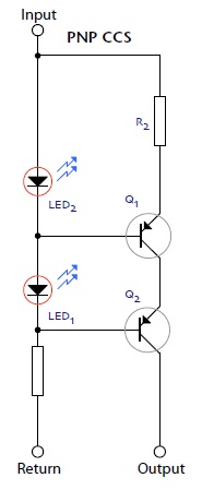

Current source boards are the same as attached pic setup for ~17ma, shunt reg boards were adjusted to 40ma.

Try 10R 100uF RC locally at + input of those BJT cascode CCSs just to buffer and dampen the reg and cables form those in case something reactionary goes on at some high frequency between active circuits. There is no concern for added output resistance, only a very small voltage drop. Because a CCS is already a great series impedance towards the load.
Return CCS pin goes to some circuit point that does not impose HV across the LEDS branch or their resistor is really high?
