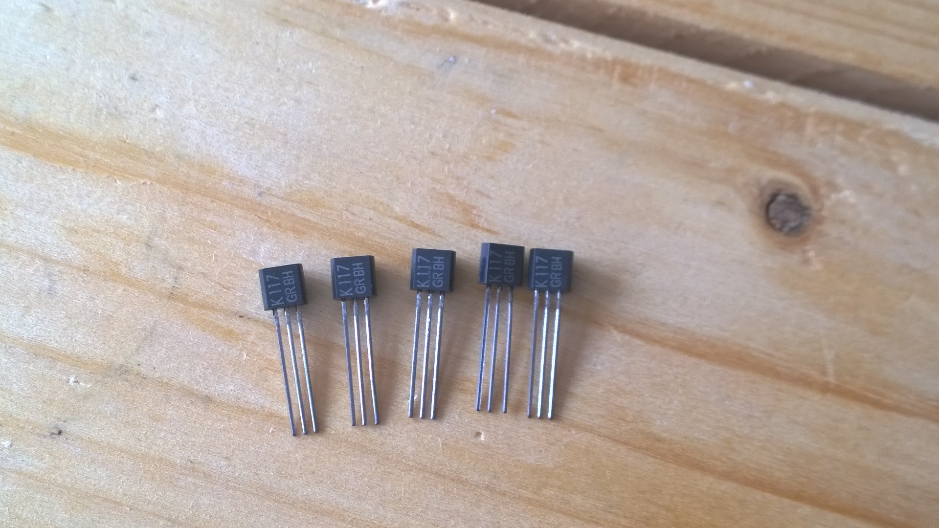

Since the original 2SK117GR are rather scarce nowadays, I'm looking for an alternative. Salas said in earlier post that 2SK880GR would be okay. I suppose they should also be ~4 mA IDSS? How large batch you recommend getting for measurement in order to get one with the right IDSS?
I also got some 2SK117GR:s coming from eBay (not from China) that seemed genuine. However can't be sure so better prepare for them being fake.

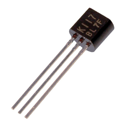

For any K117GR from ebay, post a macro picture here before applying it. We should be able to recognize fakes.
Toshiba had different 117 font print. "1" was like "l", "7" had a slightly curvy leg part. The print color was brownish (laser etched). The shape and proportion of the plastic head is alright though. The pins length and their flattened neck part look good also. Either a fake or an unusual old batch. The print reminds more of Toshiba transistors like the 2SC/2SA series.
