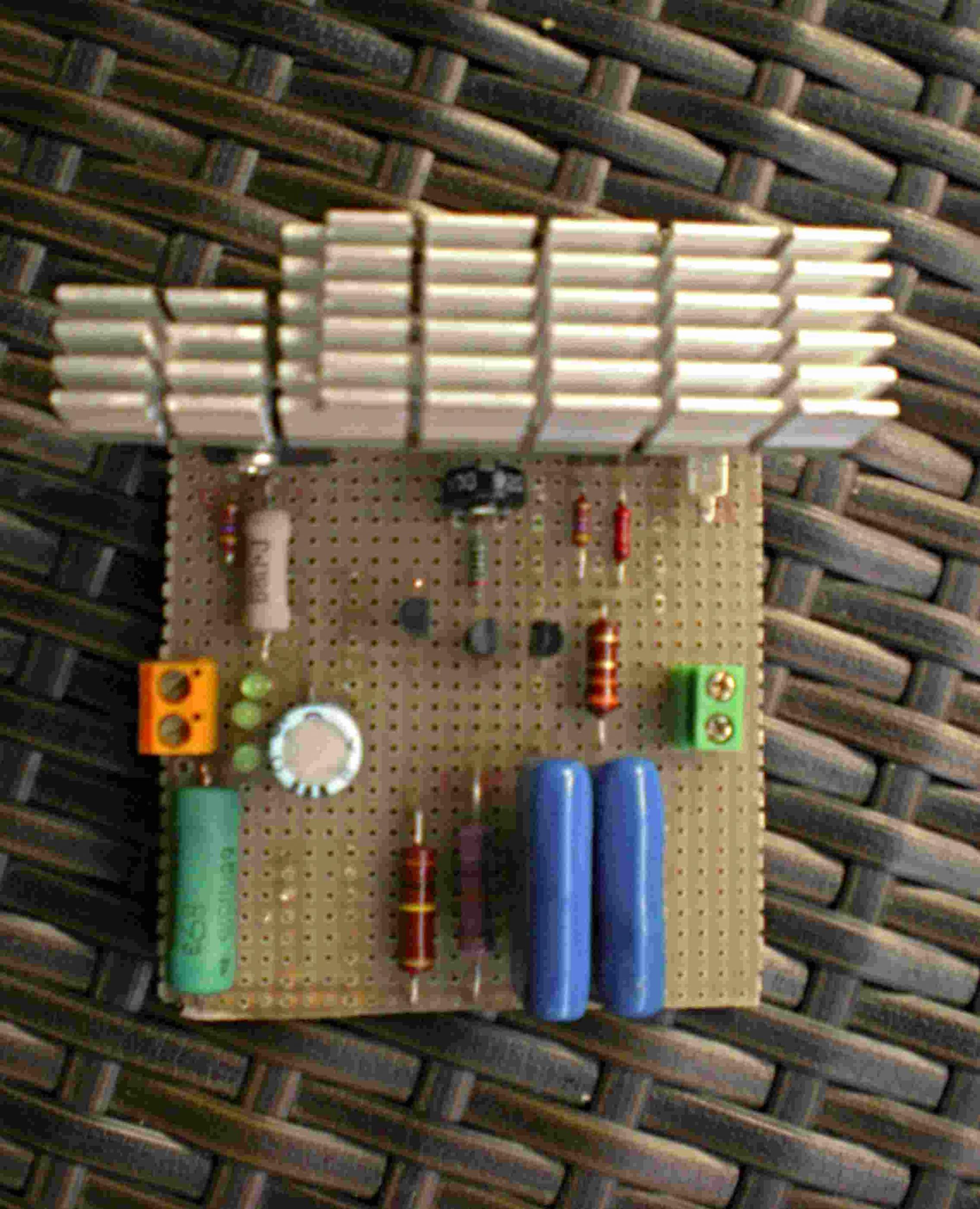

Hi again, the 470 ohm resistor at the 9240's gate is toast. Also the cap that bypasses the LED's gets too hot. Well everything gets too hot but I reckon that cap shouldn't. Any ideas? Regulator works. Here's a picture.
I must add that I was measuring things when, for a fraction of a second, the lights went out (LEDs) but everything went back to normal. After a while I smelled the stink and sure enough, that resistor was toast. The regulator still works.
*OK, I read 840 Ohms between Gate and Source. Is this normal?
Some oscillation must have happened while you were probing. The resistor probably survived though charred. Else, without gate drive it would not work.
Replace the gate resistor and use a low ESR LEDs cap when able. That one cap you got now just remove it.
It should read 3-4V between gate and source when the 9240 is working. Congratulations for having a hardwired reg working on first time despite a small incident.
Don't probe around the MOSFETs if not necessary. It should be hot on both MOSFETs when everything works of course.
Measure the voltage drop on R1 and divide by its value to know at what CCS current your reg runs.
If you did not use a load on the output then the parallel part (840) was at its hottest because it did not share a portion of the available current.
You should keep a proportion of 20-30mA extra current on top of your target load max demand. That you can arrange by judging R1 value.

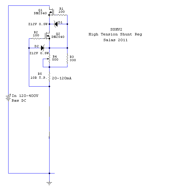

I'm using your SSHV2 feeding four triode halves (balanced amp) and each one of the triodes is CCS'ed on the anode with cascoded DN2540's. Normally when running this circuit i have a small 0,1 - 1,0uf coupling cap before the ccs's. And today i do have two small 0,1uF caps there, and it sounds really great to my ears. But would you recommend to remove them? or should i have one of them left or what would you think?
Salas:
When its stable as a system better not mod it further.
...i remember somewhere that you did recommend to not have any coupling caps after the SSHV2?...
Generally speaking the shunt-regulator should not have any additional capacitors at its output. It is the question of stability and efficiency. But we all know that the main goal - purely practical. If you prefer the sound with the capacitors who has the right to say that this is wrong?
I'd compare the sound with and without the capacitors, but in reality - when something works, there is no need to improve anything.
The anode CCSs in the audio circuit can be benefiting from the local decoupling. When they add up to a value that in conjunction with the stray inductance in between don't destabilize the phase margin of the regulator all is well. In another occasion they could (small C total, not much inductance-resistance in between). So its a practical matter.
