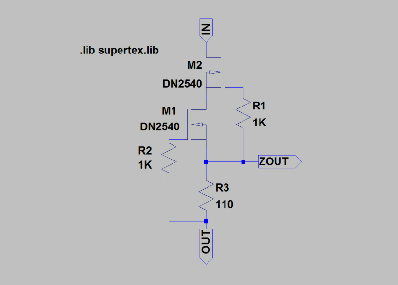

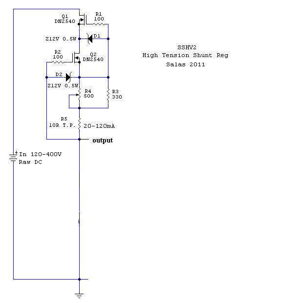

Do you mean to connect one pair of the above between the output of the SSHV2 board and the anodes of the pair of VT-25A, replacing the loading resistors??
Where is the SSHV2 ??
I have tried using C4S boards from Bottlehead in that location before.....and now have gone back to resistors....I will certainly like to try this CCS now....thankyou....thankyou...
Yes.
Not exactly preamp (driver test), but similar as suggested.

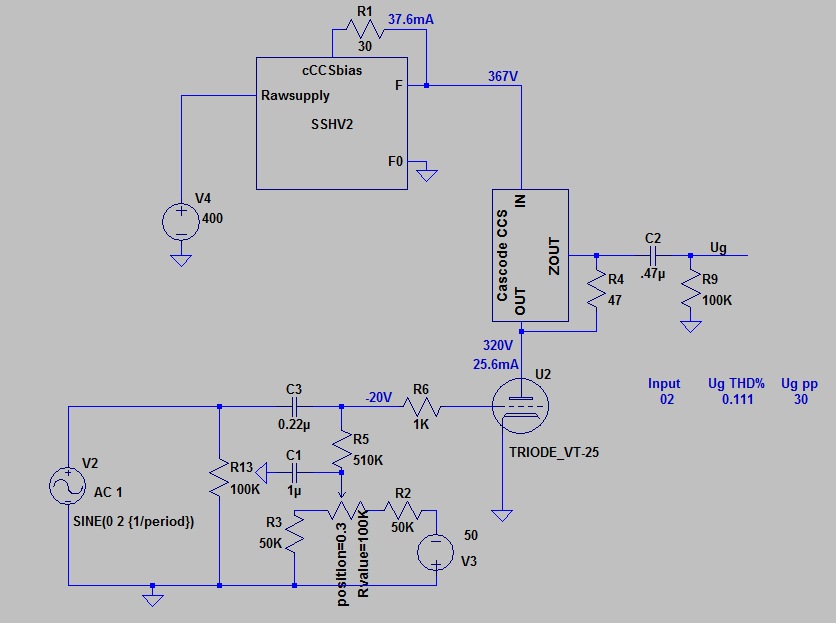

If for line amp, what CCS settings (V & mA) would you suggest to load the VT-25A please??
Where is the output please??![]()
Output is between the CCS and the anode.
The tube should be between the trim-pot and the ground. So the anode to "dot" below the pot.
This is is a better picture on how to connect it. - http://www.audiofaidate.org/uploaded/gluca/JJ.JPG
Who's Felipe?
I see only merlin el mago, RollE2k and king4joy posting that schematic in the last few postings.
Now?
mago.....how comes the output the same as ground??....
The tube should be between output and ground, check my link above!
