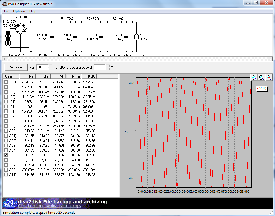

Because in the new PSU for other project can use RC 1ohm 3uF because the SSHV2 can run with more than 1V of input ripple.
Sorry, tried to understand but failed. Maybe the native speaking people can help?
My start for removing HF noice would be a small, 10 nF or so 1000 V poly or silver mica right after the rectifiers. Even more effective would be to use (C)-L-C choke input and start with the 10 nF. In practice it would act like choke input (DC=0,9xAC). Very effective also for HF
In my PSUDII simulation the last RC 1 ohm 3uF just before the load increase the ripple.
Circuit is oscillating. Increase last R from 1 to 10 Ohm
But really. Trying to combine DHTRobs passive filter layout with active filtering changes the whole idea. I think you should ditch that. Putting resistance after the shunt just puts their good job in the closit. Short twisted wires directly as close to the load as possible from shunts, nothing inbetween. If HF noice/trancients is a problem, try decoupling near bridge.
Sims 1 and 10 ohms for visualisations

Just change the sensing resistor to 1 Ohm now. Looks like it will push the borderline just so that may prove a good help.
Right, so got this now sorted and is working like a charm. Increased raw supply to allow output voltage increase but small drop in the CCS, changed CCS FET and added bigger heatsinks to minimise temperature drift at maximum current. To run this regulator at 85-90mA you need them clearly! Thanks for the tips
If I increase resistor value change the filter value
Also you reduce ripple if you increase the value of last capacitor but the same problem like resistor = value of filter will change
