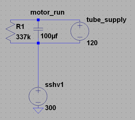

Stacking supply from SSHV1

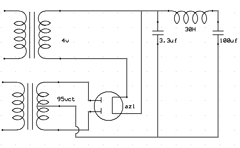

I am wondering if there is some reason I would not be able to stack a tube rectified supply with a SSHV1. The SSHV is working as expected when it is used independently. When testing the tubed supply independently, it also operates as expected. However, when the tubed supply is stacked on top of the SSHV, I am left with what seems to be some kind of short. I have not checked the current in this condition, but the output voltage measures as 0v. The return of the tubed supply is simply connected to the positive output of the SSHV. The SSHV supply return is connected to signal and earth ground, while the tubed supply's return is only connected to the positive terminal of the SSHV. The SSHV output does not have a load on its output, and the tubed supply output is not regulated, its only load is bleeder resistors. I should also note that the raw supply for the SSHV is SS rectified by a UF4007 FWB, and (small first C)LC filter. I'm sure that I am missing something and that someone can shed some light on this. I have stacked supplies before in prototypes, but never with an SSHV and tubed supply like this.

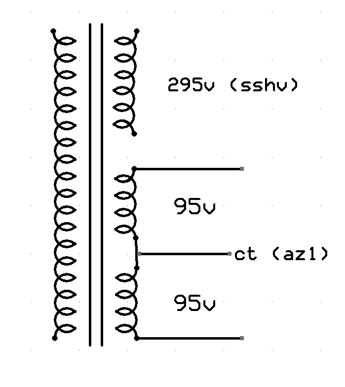

One more detail, which I hope is not the root of this problem. Both of the supplies have their windings from the same transformer. The CT of the tubed supply is actually two identical 95v windings that are connected together.

Surely you need to stack two AC windings on the CT main winding.
Add a 4Vac winding on to one side of the 95Vac CT and add a 4Vac winding to the other side of the 95Vac CT. Now you have 103Vac CT to send to the rectifier.
I cannot see how your 4Vac added after the or through the rectifier output can work.
I might need to move this post, because I realized it's really in the wrong thread! Anyway, the 4v supply is just the filament winding for the az1. The 95vac supply ends up being the 120vdc, which I want to stack off of the 295vac winding supply that is 350vdc raw and 300vdc after regulation.
-MW
