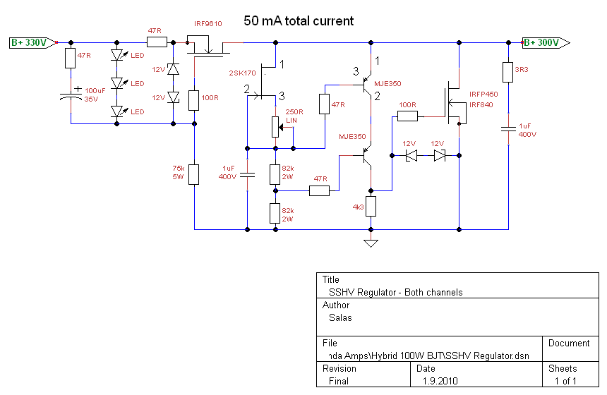

Thermal Vout drift
I have running SSHV1, cascoded version. Between cold startup and warmed up run, I have 30V of difference. I am using 2SK170GR. Can I do something to make the output voltage not to drift with temperature?
Thanks.

I did notice that the red LED on one of the regs is much brighter than on the other one. CCS and voltage settings are exactly the same (300mA @ 170V), and I have used the components from tea-bag's component GB (I assume they are the same make leds).
As I said, both measure and sound very good. Do you see any problems I am unaware of?
Maybe 30mA at 170V? The Led is in series with the voltage reference's CCS in SSHV2. For same reference resistors you must be running the same JFET Var CCS current by Ohm's law in the twin SSHV2 regs to have the same output voltage. Odds are you got different Vref resistors by mistake, one different brightness LED, local oscillation that dims the one. But you got a clean rail you say. What is it for? Have you got more pics?
There are 68K + 68K in series biasing up the cascode error amp BJTs and developing the ref voltage. To have same Vo the Jfet CCS above must be running same Iref. So both leds in the twin regs should be running the same current...

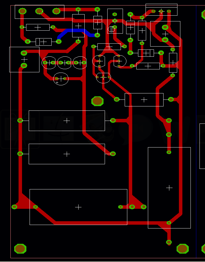

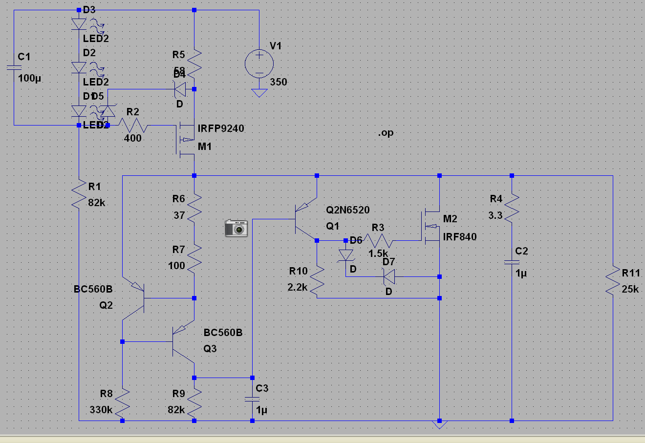

I am having a bit of a strange behavior with the original SSHV design. I configured the circuit so that it would output 300vdc, ~12ma with 350vdc, 45ma input. The regulation seems to work fine, except when connecting and disconnecting a multi-meter to either the raw DC supply or to measure the output. What happens, is that the voltage sharply drops from 300v down to about 150v, until the trimmer is adjusted. I can bring the correct voltage back by turning the trimmer one way, and the voltage jumps back up around 200v. Then I can adjust it back to 300v. If I connect or disconnect a meter, either on the raw or output of the regulated supply, it will again jump back down in voltage. I have two multi-meters, and observe the same behavior when connecting either of these meters to the raw or output voltages. I even have two of these SSHV1 boards, and both of them behave the same way. I'll attach the schematic and board layout.
-MW
