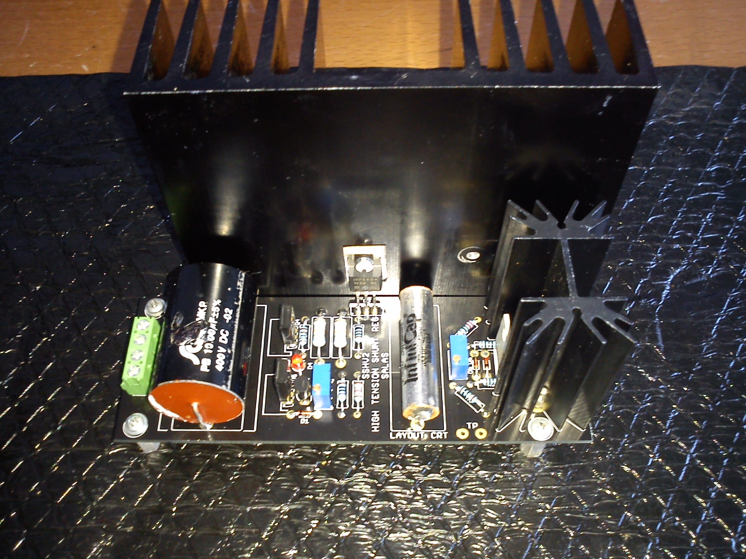

Attached my finisfed SSHV2, heatsink IRF840 1C/W isolated from chassis with bitumen car dampers self-adhesive, heatsink DN2450 4,5C/W, for caps I used the ones I have on my stash: 10uF 400V Solen & 0,33uF 425V Infinicap Wonder Signature TRT, resistors & semis are from Mike (aka Tea-Bag) minikits🙂
