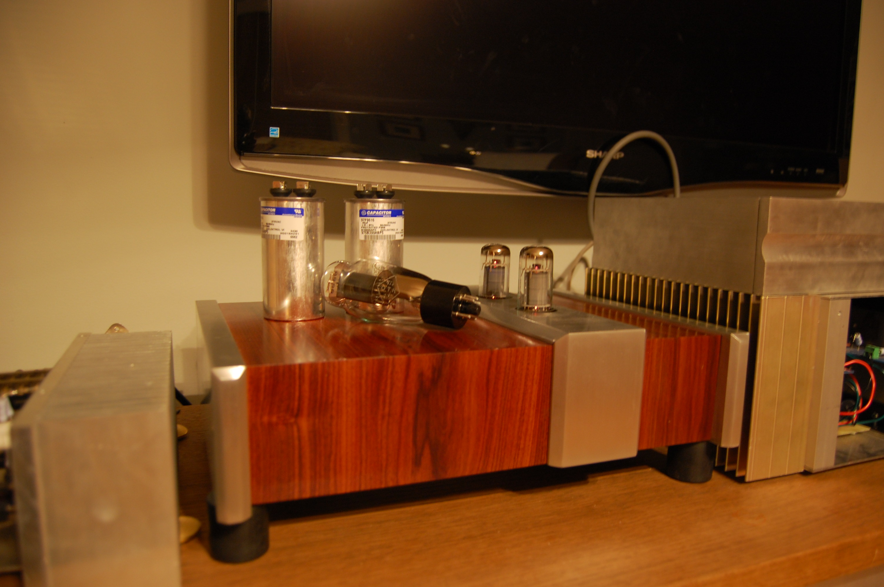

Changinf 840 as we speak. Got new tube and went to retest and kids had switched probes and i didnt notice. Nice pop and now replacing entire sensing circuit.
KIDS around open HV rig ????
Upper bjt measuring 9mV lower bjt 1.6V. Irf840 is 3.5V. I fi place probe to measure Vgs of irf 840, output voltagr begins to rise. Seems upper bjt may b eproblem.
That upper one is responsible to bias the fet also, it can be the problem.
As far as i can figure, the problem ha sto be with the voltage refernce for the bjt 's. They are not controlling the shun tproperly and it is shorting all the current away. When i measure Vgs, i steal some current from the gate, lowering the Vgs and along with it, the curren tthe fet will pass. This reduces shunt current and the rails begin to climb. The bjt's begin to balance better. I dont full yunderstand the control mechanism though. Is it the jfet.? The led is working fine or at least test good.
Is there enough Vbe on both BJTs by now, changed the upper one? Is the CCS current ~20mA more than the actual load so there is enough for inner consumption? LED working means jfet working.
No kids. Left out the dmm on the table. Replaced the bjt and no change. Other sid eworks flawlessly. If led is not lighting up, doesn this mean that the jfet is not functioning? Ccs is set to 45mA. Checking both side swith same tube and other works fine.
Ill try another. Led not working unless i measure 840 vgs. Then it begins to glow. Is my thinking correct that this is a direct result of the dmm stealing some of the gate voltage and lowering shunt current. I will change zener.
Yes it is SSHV1.I will try to get some decent pictures in the morning if you are still interested...
Will be nice, and the rectifiers descriptions were informative. I use 5AR4/GZ34 as indirect heated one and it has a good balance but 5V heated. http://www.youtube.com/watch?v=1FJ31Id3GTQ
Good news. Found the problem. It was a broken trace. My main issue with diy pcb's is toughness of the board. Just so happens that i figured out by chance that the filament was not fried, but the regulator instead. Now i got an extra set of tubes😀 Thanks Salas
So now both HV and heater CCS are fully working on both channels? And you could listen to some notes?
All is good, i think. I do have about .500mV across each input channel. This is what is dropping across 100k pull down resistor, correct. So it is essenially nothing in terms of actual current. Ill take pic along with new goodies.
Don't you ever sleep? Realized with one o fmy pics, I still have a problem with B+ on front tube. No blue glow. This is the channel with broken trace. I think i have another one somewhere that i have to find. The rectifier tube is Winged C 5u4g black plate. HEHEHEHE. Cans are 40uF. Since i am going to be putting all this in seperate case, i may get more capacitance as it only cost $6 a can. Side note, most simulations i have done show two smaller chokes being more capable than one large in prefilter. Any advice or warnings on this. Do two chokes create more noise or possiblity for ringing.
No sleep till Brooklyn. He, he. 5U4G accepts 40uF on CLC max. CLCLC is even better. What do you mean by no blue glow? That one is about electrons hitting glass impurities, there i some in a few tubes, no in others, depends on making process quality, but no consequences in tube life. You can measure steady regulated DC on both plate resistors, same drop on plates, yes?
