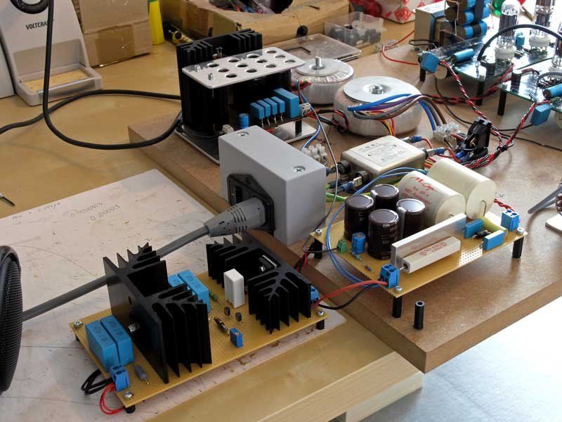

pic for the ones interested...

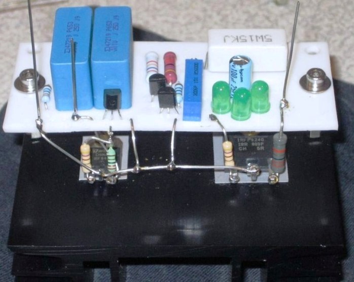

This is my build of salas shunt.
Tests will be done in the weekend.
Transformer will be an existing 240V sec 50VA, SS Bridge, 47u + 4 x 500R/47u RC blocks. According to PSII that means 150V (approx.) input for the shunt.
My real load will be around 50ma. Salas, do you have any suggestion for the value of the ballast resistor ?
Marinos,
your built easily qualifies for the most compact stuffing of the board, respect!
My next version will also be a bit tighter but I want to retain two individual heatsinks...just had a very long look on GaryP's layout today.
According to Ohm's law your ballast resistor should be around 2K (next common value) of heatsinked 15W resistor.

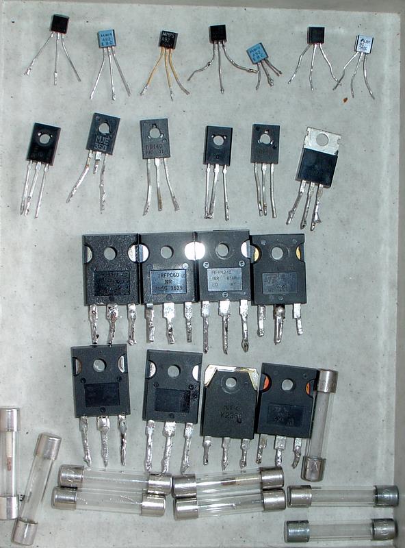

Well, after a long battle, we sustained casualties (have a look at my parts cemetery), but the high current shunt regulator is working now. I will come back later with details.
Success 🙂
In 144V out 90.
Remarks:
- 15K 5W Led bias resistor becomes very hot
- measuring voltage drop at the last psu RC shunt is working at 113 ma
- Nearly everything is running hot... Relatively small changes to load current and/or input voltage give serious changes to dissipation, so amateurs like me should be careful 😉

Edit: I may as well add something about the new shunt. First, Marino, congrats! My shunt runs hot too. The amp+shunt draws something like 220mA all in all. The shunt mosfet works happily at about 24W (measured), and it enjoys a good size heat sink, but I think I should use a larger one, because this one gets hot to touch. The CCS mosfet is barely warm. The scope shows an output trace which is basically a flat line at 226V DC.

Congratulations!
Your report indicates a healthy shunt. Don't worry about the 15k, a cement resistor of that size always burns even if it dissipates only 1.4W in your case. Your common sink isn't that big but the Mosfets are tough. Since you probably got happier LEDs, you can save off a little current from the CCS if you make your R1 27R. This must roughly get you a little under 100mA. It may relax the :hot: enough.
