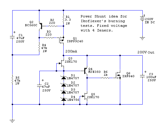

3 questions. Is your Vin safely higher than Vout at about 50V? Are there any big capacitors on the audio circuit's B+ receiving side? Maybe the audio circuit idles at more current than the bench supply or the CCS setting can provide? Despite parts substitutions something must be basically difficult in the set up.
Definitely it was enough Vout-Vin, around 50V. No caps on the B+ receiving end of the headphone amp. The idle current of the amp I measured to be around 110mA once it stabilizes. However, at turn on, it draws a lot more current. I don't have a value, I should measure it again and try to draw a curve. This might be bad enough for the regulator to deal with, since the shunt seems very sensitive to large changes in the load. I mentioned this before: two more sensitive points are the value of R1, and the value of the trim resistor. Changes in these two values can impose a huge change in the behaviour of the regulator. I can understand that you and a few others are running the regulator without a problem. Perhaps the loads are smaller so these sensitive points are not so sensitive for you and those that it runs ok for?
For instance, with a load of, say, 150mA, if R1 is too large, the output voltage will be very small. If R1 is too small, the current in M2 will be huge. And only a few ohms (in my case, 4 ohms) are needed to swing from one extreme to another.

Yes it seems like being difficult with power amps given your experience by now. I use it for phono or line stages. Never thought it would be powering more than the gain stages of a power amp. Why don't you try a Vbe control BJT on the CCS instead of LEDs? Actually if the current asked can be 150mA, there is no way it can be stable with its CCS set at 93mA circa 200Vout as with the 22R. Basically at such heavy use we need to develop a stable power version through testing since it looks like there is interest for such. 200mA at 200V means 40W constant...
Salas said:Yes it seems like being difficult with power amps given your experience by now. I use it for phono or line stages. Never thought it would be powering more than the gain stages of a power amp. Why don't you try a Vbe control BJT on the CCS instead of LEDs?
I did try, but it does not help with the instability.
I did try to set R1 to 10 ohms, then 6 ohms. That's how I got it to be stable for a little more time, but then it did not last.
A stable power salas shunt and simplistic please, if possible 😀
So you need something capable to power a whole power amp with its final stage violent swings and be stable...hmmm I will think about it.
ikoflexer said:A stable power salas shunt and simplistic please, if possible 😀
Better watch what you wish for.😀
If your amp idles at around 100mA and this one works in practice, the shunt Mosfet is going to dissipate 20W and the CCS Mosfet 10W. The MJE350 1.7W regardless of main CCS setting.

Yes, I have been simulating a few variations like this one. Now I need to make a tour of my parts box to see if I got anything left to build this 🙂

I found one spare IRFP9240 in my parts bin and put it in.
Everything else I left unchanged ecxept that R1 is 27ohm
and R5 82ohm. Unfortunately I still have a little over 4V
output voltage...
Any clues what is still wrong, or am I about to pile up parts
like ikoflexer? 😀
output voltage...
like ikoflexer? 😀
Remind me. You had it working after you got rid of some chirping noise on your phones after putting a base stopper? But after, you short circuited its output?
Yes, after upping the gate stopper of the 9240 to 1K and changing my wiring I had it playing music for about 20 min. but couldn't get higher voltage than 170V.
I then accidentally shorted the output and replaced the 840 and the 9240 since, changed resistors R1 and R5 and added a base stopper on the MPSA (33R, could substitute for 2 x 100R in // ). MPSA is also new...
So, by eliminating those suspects, logically, you have to inspect if the IRFP and 840 are for GDS correctly wired, and if some BC560 is affected. Did you manage to understand any differences from the Maida sound in those 20 minutes? Also, do you know the idle current consumption of you audio channels (both)?

Edit. As mentioned before my consumption is a measured 56mA.
Check all semiconductor orientations and only suspects left are those BCs. Don't throw away the other stuff after it works again. Just inspect them vs new ones with the DMM and keep the unaffected ones.
And your CCS is set at 75mA?
Stixx said:Edit. As mentioned before my consumption is a measured 56mA.
R1 = 27R
R5 = 82R
everything else as per your schematic (or the one I posted earlier in this thread).
R5 = 82R
OK that 27R will give 77mA, its enough. Also the 82R, more range. Don't forget to start from half trimmer.

Every time something happens, please check all the parts, especially all transistors. I check them with the diode setting on the DMM.

Fast forward and 5 headphone amplifiers later I have a working Salas' HV shunt reg, YEEHAAH!!!!
Yesterday I obviously picked the correct BC560 to replace, switched the reg on and had a working unit. Apart from the usual crackling at warm up (~30s) there was no oscillation, and I just carefully checked output voltage and (very carefully, didn't dare to touch anything...!) dialed it to 210V. After seriously heating up my ballast resistor I shut it down, bleeded capacitors in my pre-CRC and connected it to the amplifier. Again no problems, just music!
Vin is ~248V, Vout a little over 200V which seems about perfect. Heat dissipation is nothing to be worried about, the heatsink on the 840 still remains rather cold (but it is a big one...), the sink on the 9240 climbs to about 45°C max.
