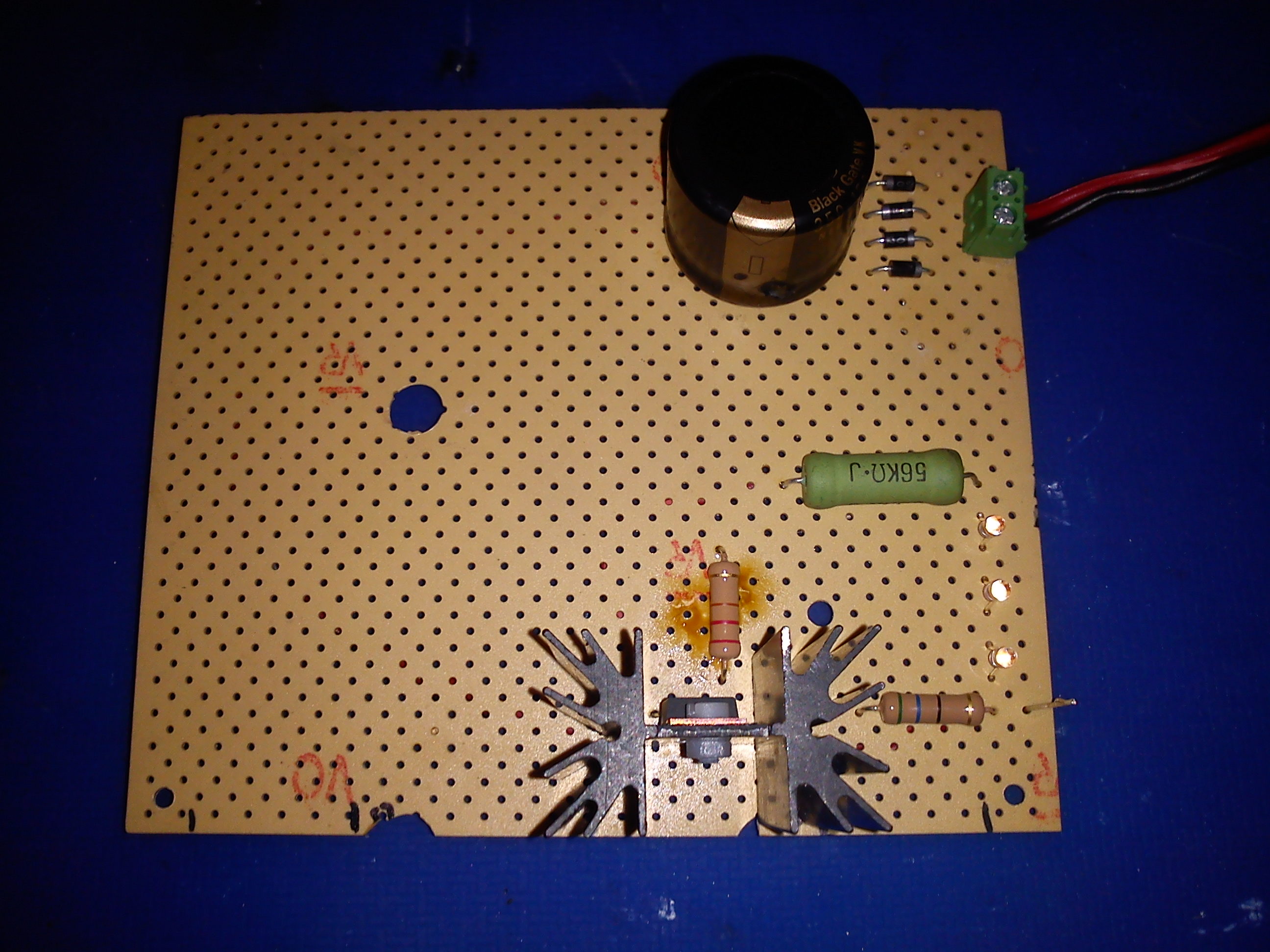

quanghao schematic connect the LEDs between 220R gate resistor & 56K that isn't correct?
The schematic is correct, but look at your photo, it seems the 56K is connected to the LED at one end with the other end connected to the 220ohm
The LED is connect between the 220R and 56R not 56K, you swap the 56R and 56K
Oh my good you are right, I have to connect the 220R gate resistor between the LED's string & the 56K😱
Thank you very much bigpandahk, I'm happy my CCS is going on perfectly well after 10 minutes, old tx & IRF9610 used.
Now what I have to do: connect the rest of quanghao pcb with old tx or try first with Bartolucci tx and after connect the rest quanghao pcb?

Have you been using the 56R in the place of the 56K in the other boards as well?
For current adjust yes, for R3 always 56K 5W
