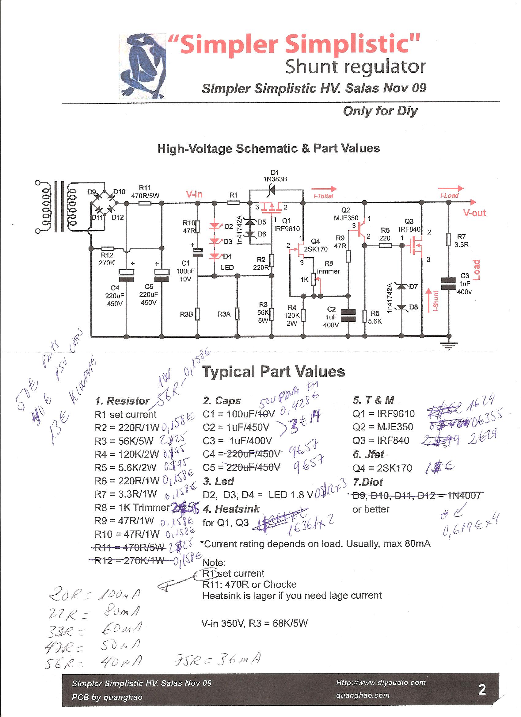

Merlin, I suspect that you LED's have too much voltage drop. I see in your photo's that you have new type LEDs like I tried. Had almost 8.5V drop accross three of them which made the sense resistor R1 heat up too much and burn out. Please measure them. You only need about 6V of drop.
And with you blowing the gate resistor your symptoms are exactly as mine with too big drop across the LED's.

Merlin. Put a resistor with a value between 500R and 1k in series with the LED's and measure the voltage drop accros the LED's with the 9V battery hooked up.
1K 5.48V, thanks Gregory.

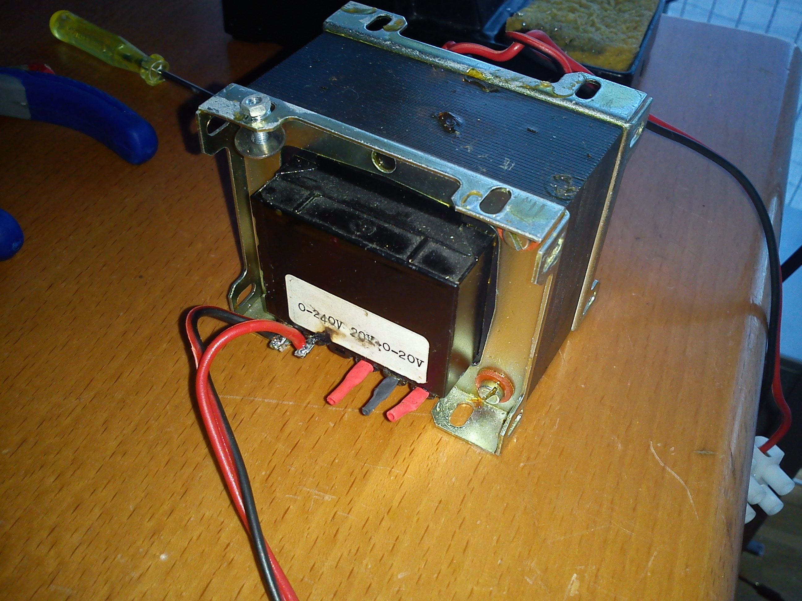

Something beyond the circuit itself must be happening. Do something drastic. Get rid of the peripherals. Use a simple small transformer, bridge with 1000V piv diodes, one 100-150uf capacitor, short Vin wires, and feed. Simple grounding, use no crocodile clips. Maybe a transient discharge from the big PSU & filter hits whatever you try out now. Something that the CCS can't hold up to... Can't think of what for sure, this is baffling me, and is only hands on to really tell.
Those are good parts, but I am afraid this is not the real problem.
OK I use with the ne P2P CCS a 150uF mains filter cap 4 x UF4007 diodes & the old tx to see what happens.

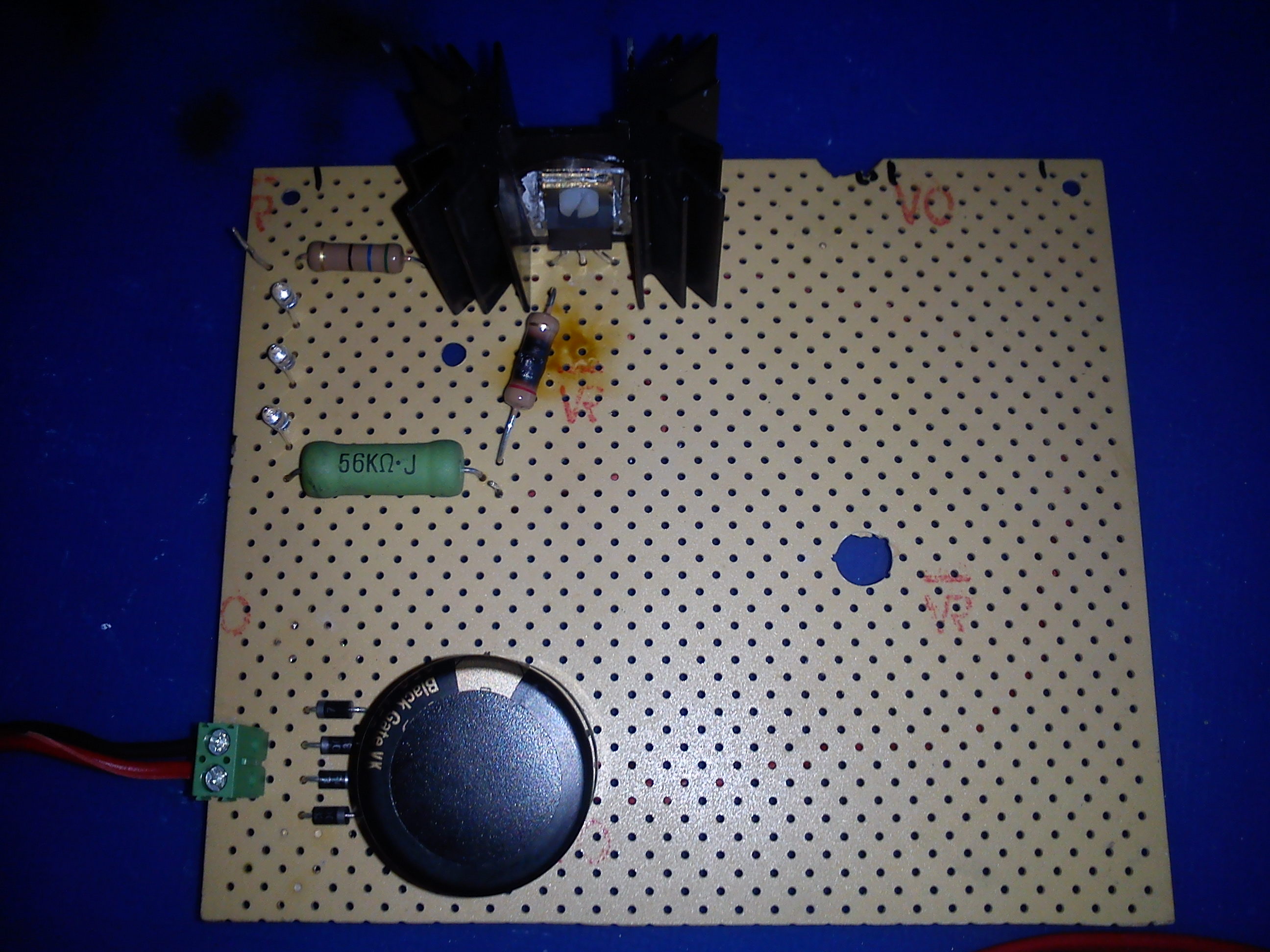

Also burned 220R gate resistor & IRF9610 supplied by Mike😡

Do you keep the Drain of you 9610 open?
Merlin
Yes, nothing connected.
Excuse me for a silly question, that means the middle pin connect to nothing
Phelipe,
check your connections one more time.
I think that the 56k should connect with the leds and 220R at one point together.
Phelipe,
yes, look like your 220ohm connected to ground at one end.
Phelipe,
quanghao schematic connect the LEDs between 220R gate resistor & 56K that isn't correct?
