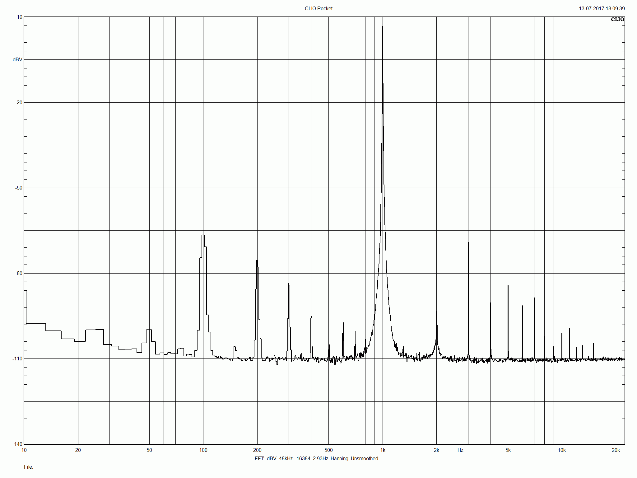

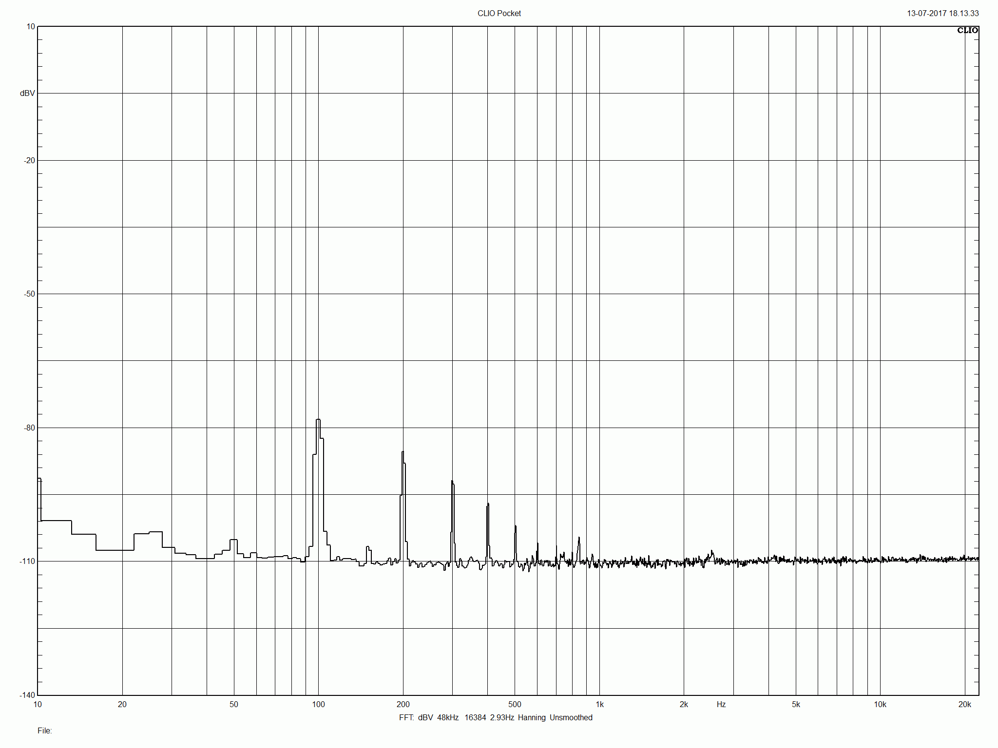

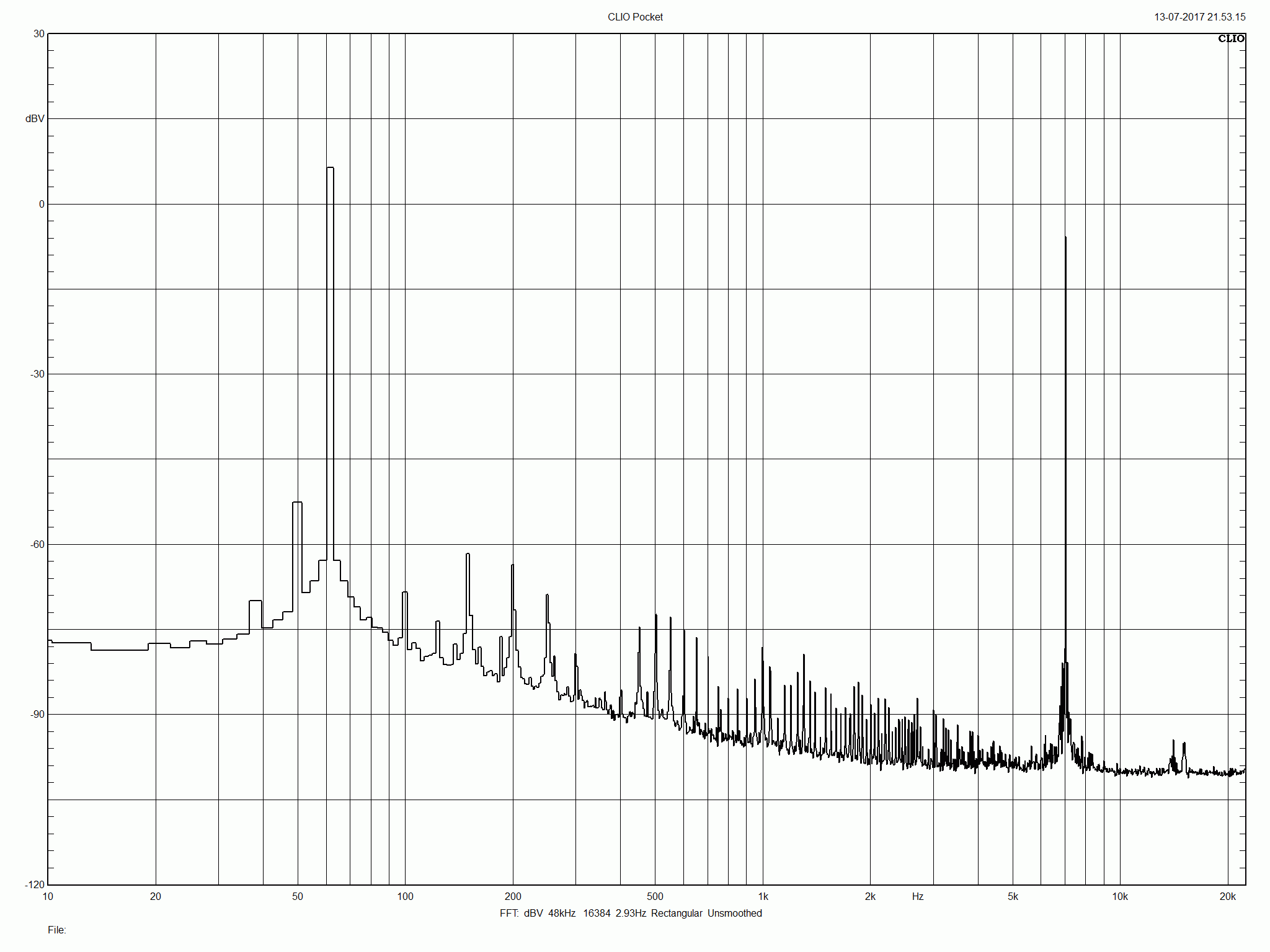

I did a FFT on the amp at about 2V into 4 ohms and for the IMD test using 60Hz and 7Khz mixed 4:1 ratio. There is one with just the noise floor where the lap top was on batteries and the generator shut off ( not disconnected ).
