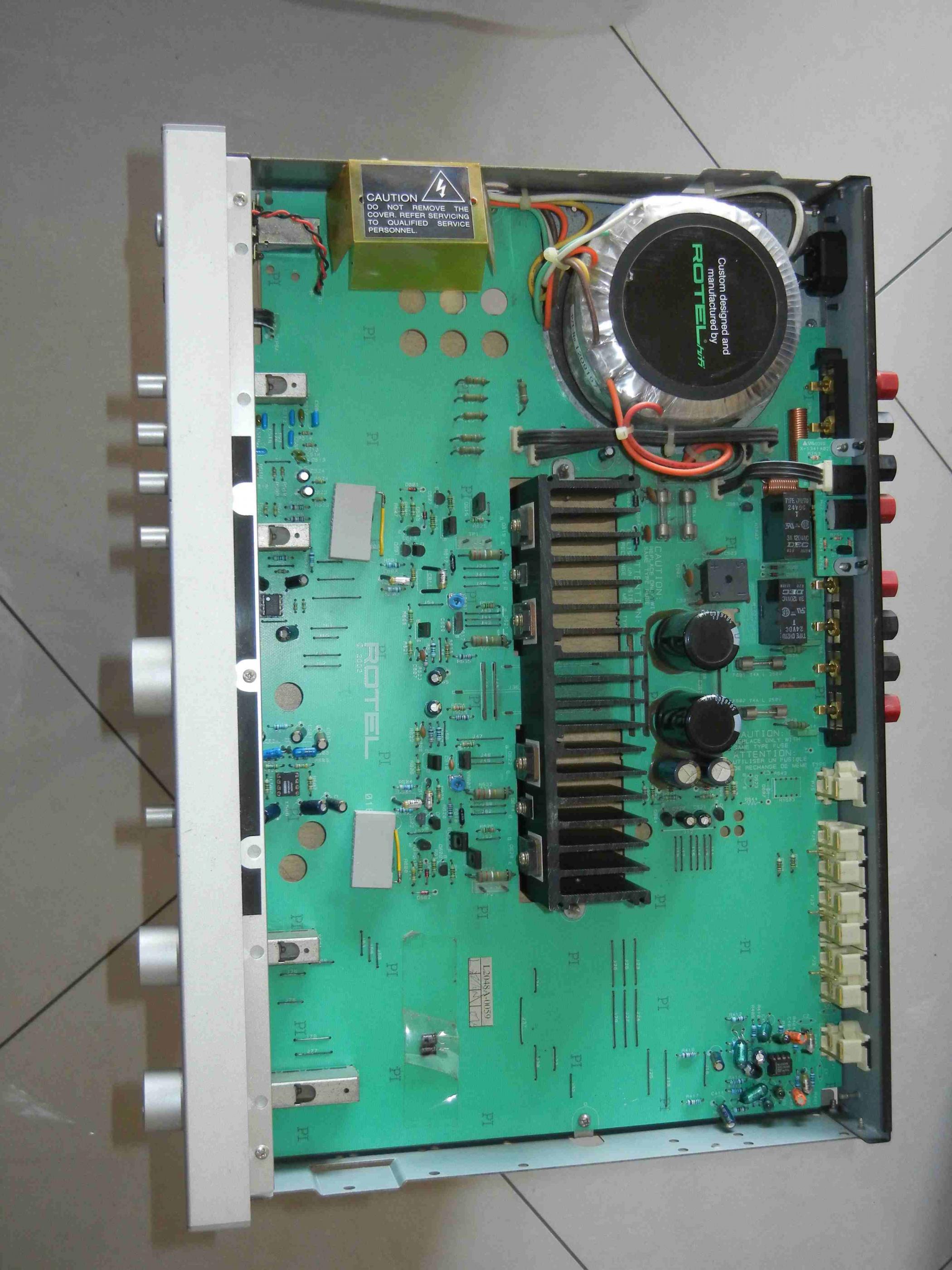

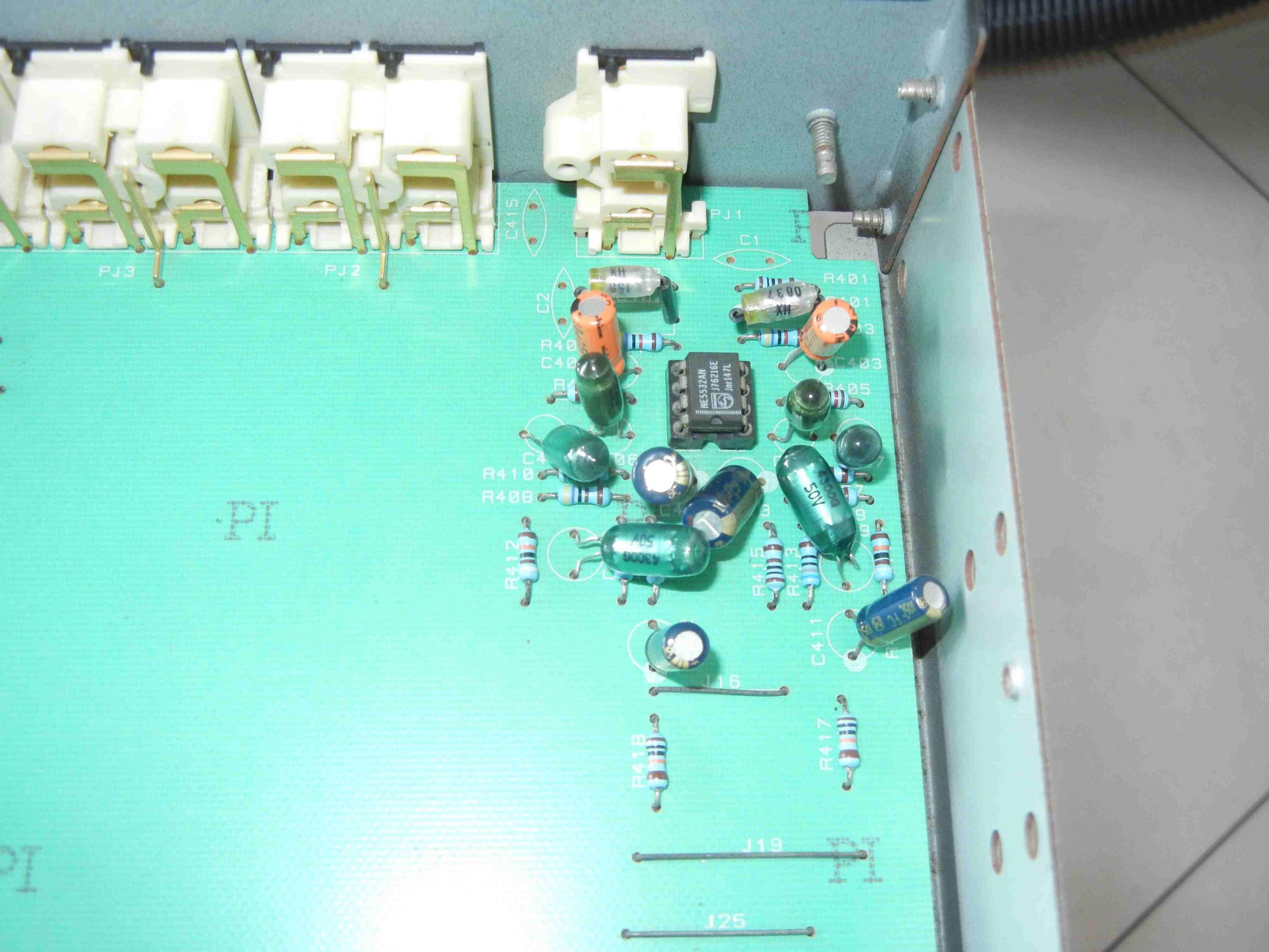

Actually the RA970BX isn't dc coupled ! It has the original coupling cap in place. The 1.1 V dc offset appears to slowly ( after 30 minutes or so ) drop down to around 70 mV like it is on the other channel. While checking voltages I noticed the two errors in the circuit diagram. Something else is wrong here. This amp was 'modified' by the original owner. Even installed and external IEC power socket ! Can't say if it's an earlier problem coming back again ! I don't know what else they did or could have done. The input opamp on the diagram is AD827. On the board its AD826. The tone opamp should be NJM 2114 but it's AD827 ! Both are on DIP sockets . So they were changed after they added the DIP sockets. I saw the base collector short also ! That's too obvious as a mistake !Since all this is double checked wonder how the errors got through.

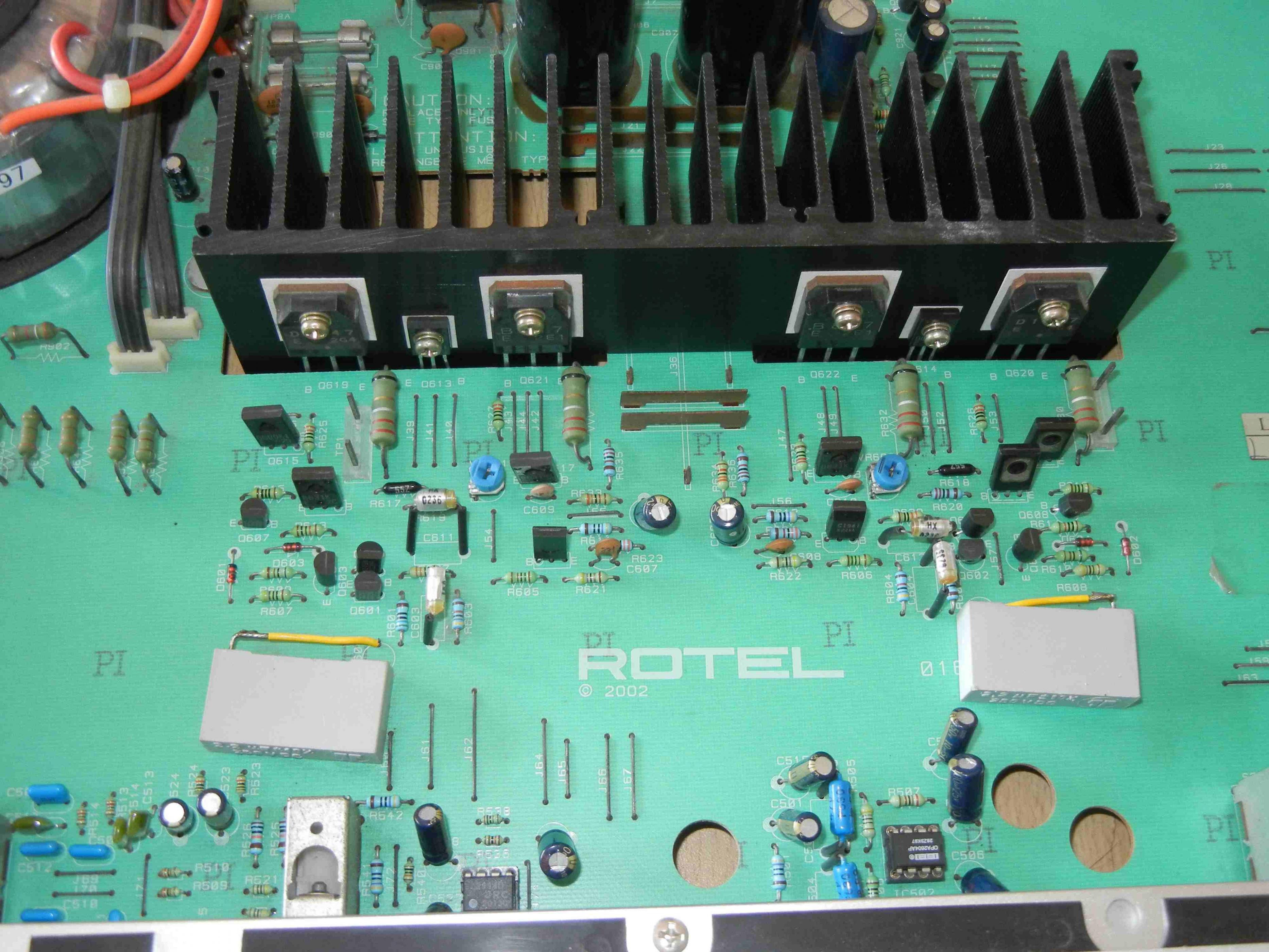

I managed to attach the protection board without cutting any tracks. Removed a jumper and soldered the wires to those points. It's late now and I am going to bed. I'll take some pictures tomorrow.

I think the power supply noise might go down with a filter on the power supply line. Still figuring out how to fix the cap multiplier to the board with minimal track cutting and to use some of the copper leads to hold the board up by itself. That would reduce lead length and not require any fixtures to hold the board.
While the protection circuit works well on it's own, there is a problem after installation. There are some other dc currents flowing through the board that shouldn't be there. I need to fix that. It drops the available voltage to the trip circuit.

The protection circuit is wrong ( post 33). Two transistors and the diode are not required ( D2/Q4/Q5/R2). I don't know what I was thinking at the time. Maybe had a whiff of grass from the neighbors house !😀
Anyway after correction it works fine. It wasn't to do with the protection itself but severe loss of voltage to the delay /relay circuit. Anyway that's solved. I wasn't too keen to make changes without the protection installed. A fuse is not good enough.
After studying the manual carefully for a long time I've determined where to cut the tracks ( two ) and where to locate the filter ( Diode/R/C ). I'll do it tomorrow. In the meantime I want to keep listening to selected tracks so that after the change I can listen to the same ones to see if they are different.

Just a quick note. I got some time today to make some changes. I tried the RA-01 without the OPA2604. Big drop in gain obviously. So it's only the power amp section working with dc coupling !
Later I removed the NFB coupling cap. As expected the offset went up. The offset was about -240mV and -180 mV. But that's safe on the speaker and it doesn't trigger the protection circuit which needs over +/- 0.6 V to trip the relay.
