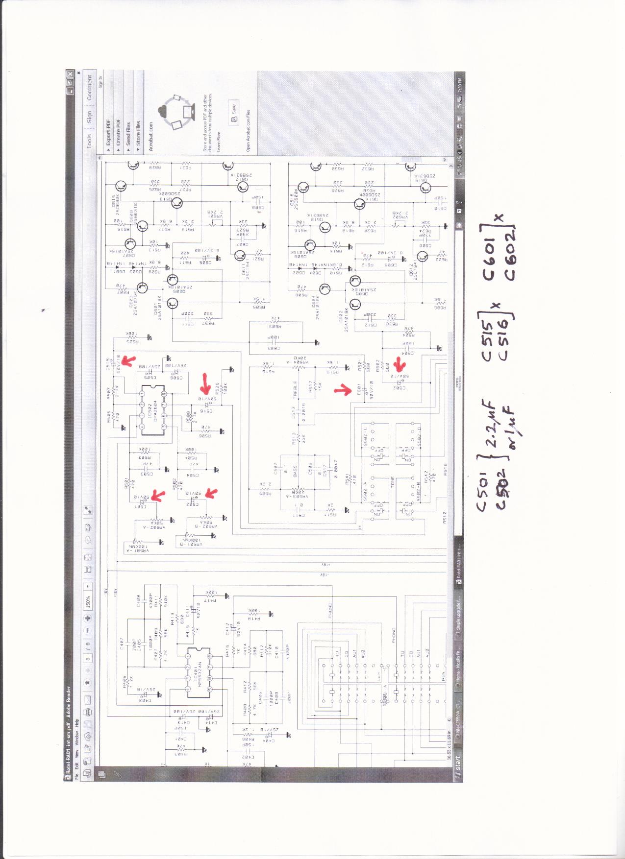

Details of the caps
I changed the capacitors around the IC 502 / OPA 2604 ( C501 /C502 and C515 and C516 )and the input cap of the power amp ( C601 and C602 ).
All were shorted across with a small wire. You can remove it later if you want to.
In my case I had planned to use a 2.2uF or 1 uF film cap at C501 and C502 ( input caps for OPA2604) so that no dc would enter accidentally. Protects the speakers from accidental dc due to a bad signal source. If you are careless then you should add these caps.

The description in your schematics photo is different with what you say.
You must have removed C501,C502,C515,C516 and replaced C601 and C602 with 2.2uF or 1uF (that's shown in the photo of the actual modded amp you post earlier)
Can you check it?
Can you check it?
No, my last post is correct.
The photo is BEFORE I removed the films caps (C601/C602....2.2uF film) which I had added earlier to the power amp to replace the electrolytic that was there.Done long ago.
Now there are NO caps at all the positions indicated.
The suggestion to use a film cap at the input of the amp ( C501 and C502) was for those who are not sure of the dc offset of their source and for those who just wanted to be careful with different sources.
I do not use a cap at C501 or C502 ! I've checked all my sources and their dc offset is negligible. No one else would use this amp so it's OK for me to do this.
So for speaker protection it's better to leave as is or change C501 and C502 caps (that's what i'll do) and safely remove C515,C516,C601 and C602.

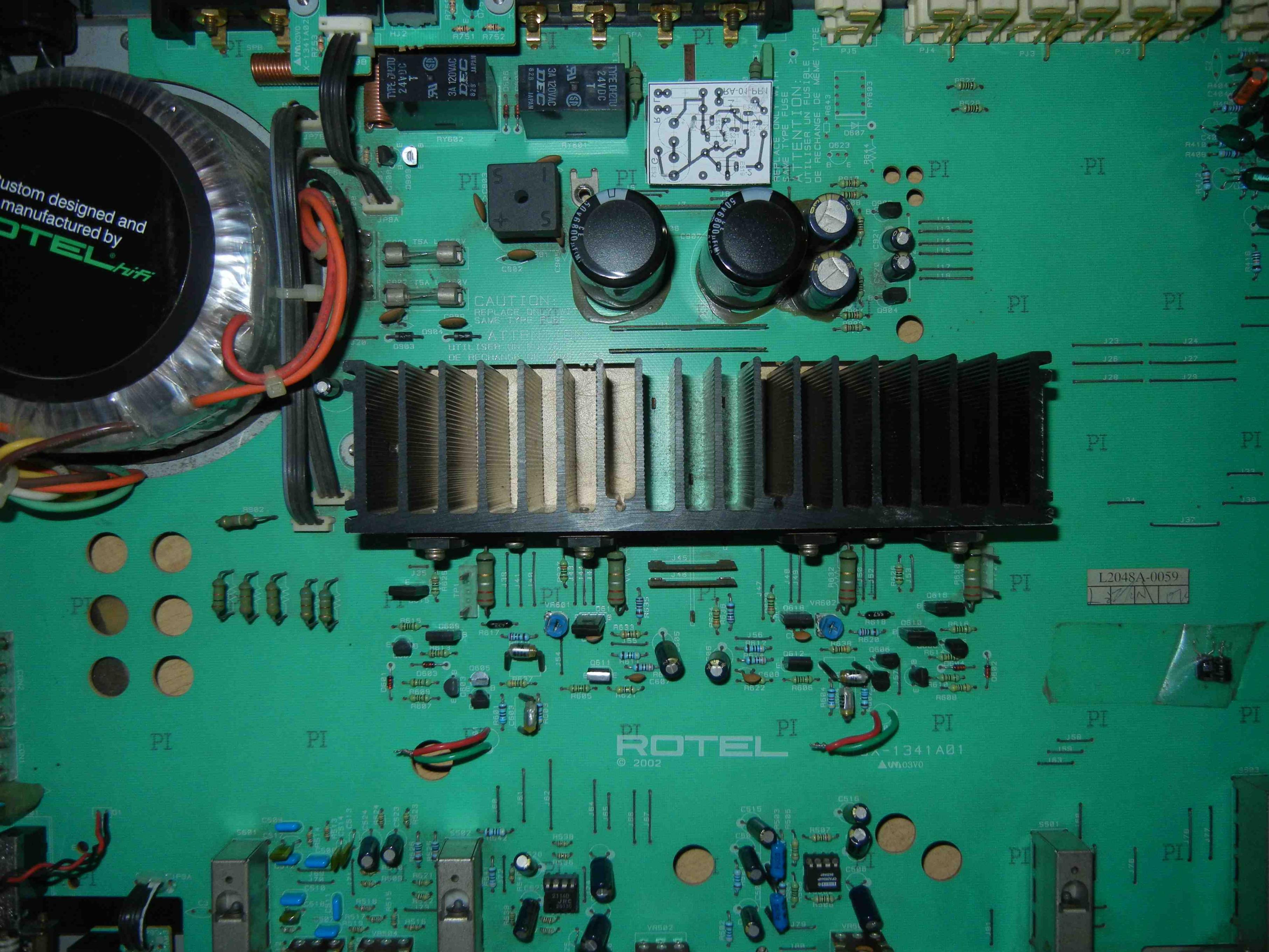

I find that one can fix the board easily using the chassis earthing screw right next to the bridge rectifier. I've placed a printout of the board to indicate the size. This is just above two fuses and may not be an ideal position.
Mounting it to that grounding screw means that maybe one wire connection can be reduced. So we need four more wires. 2 for the speaker lines and two for the power in and power out ( 12 V dc ). Can route it near the real panel and down through the gap near the transformer and then below the board and soldered to the correct places. Only hack is to cut the 12V track that goes to the relay driver transistors. Can use a small length of Cat 5 cable for this ! Will look neat too.
Will be opening up the RA970BX this weekend to see what I had done to it earlier ! I do remember that when I was fiddling with these two Rotel amps long ago I didn't have the service manual. But some schematic or part of it must have been there I think. I can't really recall. The gray cells must be dying !

The 970 BX is very poorly designed. The bottom plate is plastic ! So no metal shielding for the bottom of the pcb ! All the glue they used to hold the capacitors have become a mess and have cracked off also. But then it's an old amp. Though some other older amps seem to be doing not too bad compared to the 970.
I opened my RA970BX and found that I had bypassed the input line stage and tone control and directly wired the power amp input to the volume control. The input cap is still there. DC offset on one channel is 70 mV and on the other channel is 1.12 V ! Something wrong there. So the amp goes back into storage till I have enough time to fix that ! I have plenty of other work to do . Not worth wasting time fixing the 970 just now. I was really keen on hearing it today !😡
