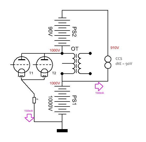

I suspect that what you have drawn is not what you have built.
There are a few flaws in the circuit as drawn. The pinout for the tube is not correct, and there can't be 910 volts coming from the voltage multiplier circuit. If there is, the screen resistor would explode.
A choke used as a "ccs" can collapse to 0V, and then continue on to more voltage in the opposite direction.
Yes it can. That's how the ignition coil in your car works. It's not how an OPT works in a SE circuit.
A similar result happens with an SE output transformer primary.
There is an SE amp sitting on my workbench right now. At idle there is 500 volts of B+ and about 500 on the plate of the output tube. There is actually less due to DCR, but I'm trying to make this simple. The tube is drawing 100 mA of current. All of the operating parameters have been tweaked for perfectly symmetrical clipping, and the amp is driven just to the edge of clipping (maximum undistorted power).
As the grid of the output tube is driven up toward zero the tube current increases and it's plate is pulled toward it's (grounded) cathode. At some point the tube will reach saturation. It can't pull its plate down any further. Let's say its 50 volts. The OPT has 450 volts across it. Attempting to drive the grid further positive will not result in more current flow, or a lower plate voltage, just cause clipping.
As the grid voltage has reached its most positive peak and then turns around the plate voltage will start to rise. At the point the grid voltage reaches it's most negative point, the tube has reached zero current, and any more drive will cause cutoff clipping. Here the plate voltage should be 950 volts. The plate was pulled from 500 volts down to 50 volts, and should swing an equal amount in the opposite direction. The voltage on the OPT is always positive and centered around the B+ voltage.
This is an ideal situation into a resistive load. Things get a bit hairy with a reactive speaker load, and real components. It is possible for the plate to be below zero, but this doesn't happen too often. it is more common for the plate end of the OPT to shoot beyond 2X the B+ voltage. This can happen when the amp is over driven into a speaker near its resonant frequency. Real music imposes transients not seen in sine wave testing.
In the circuit described in the original schematic the PL519 tube has it's plate attached to B+ and its cathode connected through a floating supply to the VT4C's plate. Once that plate flies above B+ the circuit is reverse biased. If the plate is pulled to ground that tube sees a lot of voltage across it.
This might work if the plate of the PL519 is tied to a supply that's 2 X B+ voltage, but that is rather wasteful. Maybe some type of bootstrapping scheme would work.

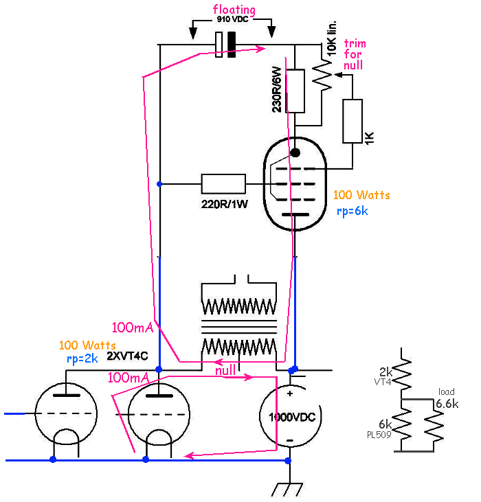

...The drawing by PPR is wrong because he is earthing the 519 part....
To PRR: in redrawing my schematic you made a very serious mistake by earthing the floating counter current circuit around the 519. ...
Where have I earthed it? How is my drawing unclear?
Yes, it is AC earthed because you drew the plate of the pentode to the top of the 1000V supply, and I simply rotated.
You are right, I was wrong I should have looked better , sorry for this
I've looked at your original post again and saw that all your conclusions were wrong. It doesn't eat half the dc power; it's not working outside it's dissipation (9 watts!).You left out the power transformer and the rectifiers maybe that's the cause of the wrong conclusions.

...You left out the power transformer and the rectifiers maybe that's the cause of the wrong conclusions.
I keep looking at your original drawing and I believe it says "910 VDC" across the capacitor feeding the pentode.
I agree I did not initially work-out how 40VAC became "910 VDC". Looking back I see this is unlikely, even if the voltage multiplier were more elaborate than drawn. But ~~1000V seemed a likely counter-voltage for the 1000V triode supply. Unwisely, I relied on the stated "910 VDC" rather than work-out all the details.

Yeah, I can't see an easy way to make the circuit in the OP work in both directions from the output tube quiescent point. However, this added winding could accomplish the same thing with a simple circuit. You just have to find a transformer that has a little extra space for some more wire.
I looked at that 40V too & simply figured it was meant to indicate the PT ran both the 40GK6 heater but another wdg on the same PT got the 910V thru the tripler. Figured that detail got left out of the dwg.
But with only 56V (40V peak) tripled on load might get 140V on the 40GK6 plate there is nowhere to go when the VT4Cs get going. Read compliance.

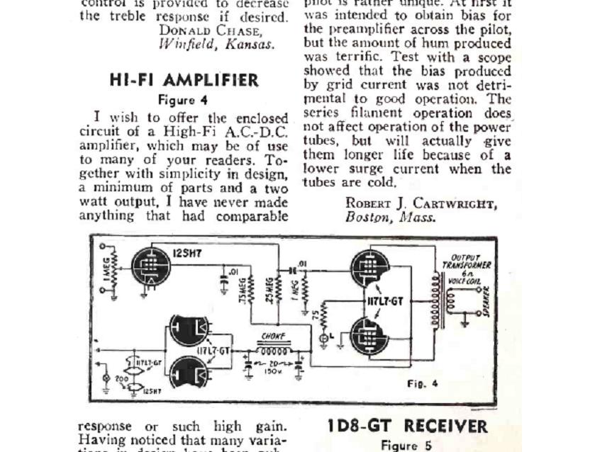

I ran a whole series of tests on the simple cct using the two tubes in that pseudo PP hookup a couple of years ago. Tried the original cathode resistor, choke & NFET as the tail. Used a pair of 6V6s & a Hammond 125E OPT.
Overall the best results were using a choke tail. But none of the tests resulted in much more than half the power available when driven by an ordinary phase splitter.
That kind of cct has been played with since the beginning of time, I found one dating from WW2. And another in the 50s.
Performance results claimed are all smoke & mirrors. And poor hearing, what my mother used to call a 'tin ear'.🙂
