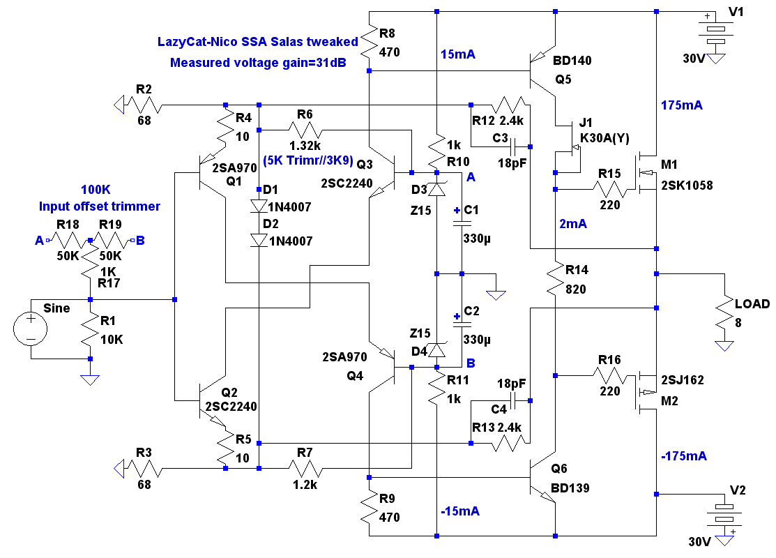

More progress
The input offset trimming tweak proved very helpful, now the prototype is tamer for offset drift.
The bias in the drivers and output remains steady after the CCS tweak. Here is what schematic I run by now, including 1kHz 20VP-P square wave screens. -3dB gain frequency is 1MHz.
Nice design, but awfully big gains.. I would only use gains like 10 to 15dB, max 20dB for power amp. I know it's not "traditional" solution, but still makes sense in 95% of the setups by making gain structure more reasonable.
I wanna use my buffers on it from a turntable. Do that with 10-15dB.

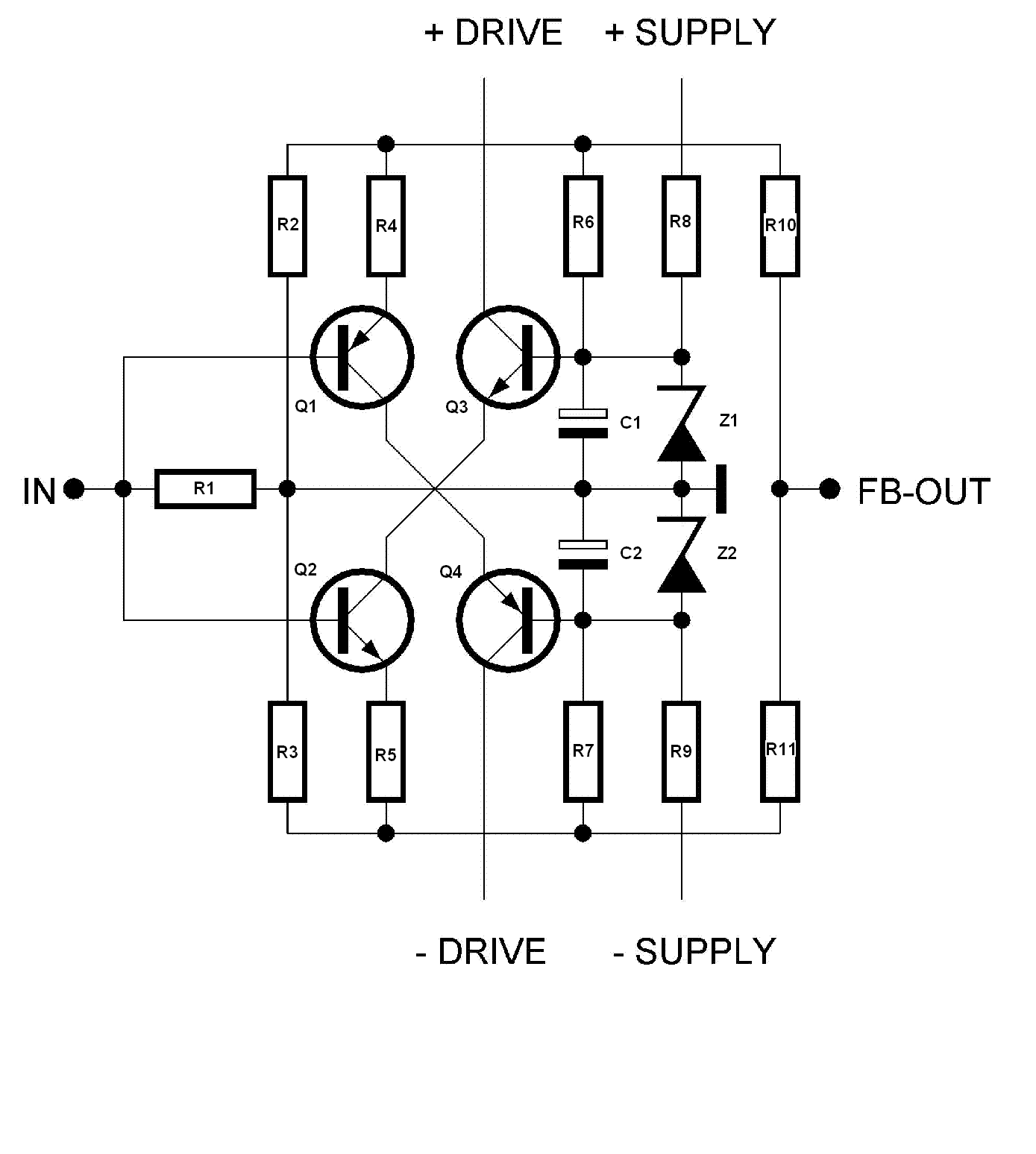

SSA basic front end
I couldn't get how the front end works (I very weak at understand audio amplifier, beginner learning phase)
So I would be appreciate if you could explain in the way which music input is flowing through components for each halfwave.

This circuit elegantly permits use of bipolar semiconductors at the input with conjoined bases. Normally this creates problems in current feedback symmetrical circuits where feedback is injected into the emitters since by joining the input bases of opposite gender devices we shift the DC points of the emitters +/-0.6V, which is very awkward for feedback.
The emitters of each of the input devices Q1 and Q2 (see attached image with designations) are fed with a small current via R4 and R5. These resistors are connected to a DC voltage source of just under 2 volts through R6 (pos) and R7 (neg). The primary voltage source to power these positive and negative biasing networks is formed by R8/Z1/C1 (positive +15V supply) and R9/Z2/C2 (negative -15V supply).
Thus, with Q1/Q2 bases connected and bias via R1 to ground, we have a constant DC current supplied via R4 and R5 to Q1/Q2 respectively. The value of this current is determined by the values of R4, R6 (pos) and R5, R7 (neg) and stands at a few milliamperes.
Feedback is taken from the FB-OUT node via R10/R11 to the inverting input (the emitters of Q1 and Q2) via R4/R5. Notice the fb is split in two, one network for each half of the circuit. The voltage divide function for this fb voltage is supplied by R2/R3 and is identical for both halves.
Now, what happens to a signal input?
Let us stick with a positive going signal; negative is simply the reverse.
As the base of Q1 (and Q2) rise, it moves Q1 emitter closer to its voltage source, reducing current through R4. Q2's emitter, however, moves further from its voltage source, increasing current through R5. This is the important step for a positive input and is the important current here, since it passes through Q3, which is wired as a cascode with its base firmly held at +15V, so that Q3 offers no resistance to this current change at all, passing it to the upper gate/source resistor (470R) labelled +DRIVE on the schematic.
With more voltage dropped across the 470R gate/source drive resistor on the upper output device, it switches on harder, and passes more current to the load. The drain potential on this device settles to whatever voltage is required at the load to permit this output device current to flow, so the load is activated, and the speaker voice coil passes a positive current.
With the load now having a positive voltage on it, the opposite (inactive) output device is not involved here; its drive is reduced, so it may even turn off... offering no contribution to the load current, which is supplied only by the active output device. With a positive current flowing through the load, a voltage is created across it, and this is fed back to the input as feedback for the amplifier. Fb is passes back to the input devices, both Q1 and Q2, via their respective fb network resistors, R10-R4-R2 and R11-R5-R3.
The voltage appearing at the load will thus present back to the emitters of the input devices, modifying their transonductance (that is, how hard they turn on or off) by varying the voltage at the junction of R2-R4-R10 and R3-R5-R11. This reflects back to the emitters, so that the drive on the load is no more and no less than that required to multiply the output over the input by the gain ratio of (R10+R2)/R2 and (R11+R3)/R3, which are identical of course to ensure identical gain for each half cycle.
This circuit is a bipolar adaptation of one of Jean Hiraga's circuits from the late sixties, Le Monstre, IIRC. It is a clever solution because it structures the DC voltages at the feedback nodes to allow use of bipolar devices, since jfets of opposite gender are harder and harder to source. It appears to have a good distortion profile and is clearly an inspired design - hats off to Andrew!
Thanks for the great explanation, Hugh.

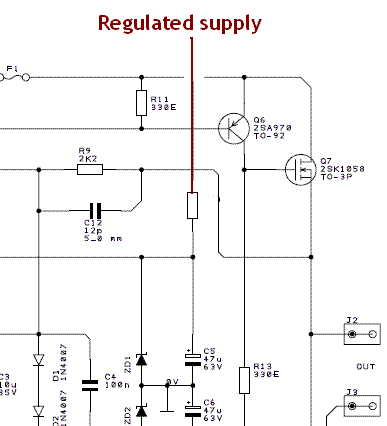

Knowing that the front end is very sensitive to power supply, and that the Hiraga uses battery, do you think the attached schema is correct for implementing front end power supply?
Yes, Jay, it looks fine, though details are not given HOW it's regulated.
Most of these simple circuits, including the FetZilla, are highly sensitive to rail supply, and care must be taken with in the SSA to ensure that the +/-15V supplies are very quiet, since they are directly connected to the feedback node.

Just curious, aren't R8 also responsible for bias voltage drop for positive half ? Since the supply voltage need to pass through R8, then R6, finally R4 ?
Why is that important? I thought I can use any regulators that I used for opamp based linestage. At least, Salas' one I think can be the best.
Actually, I was prepared to have response about the redundant zener. But I think it will not do any harm to the sound. The R-C-Z will be there on the board, plus another MKP, while the regulator will be on another board.

R8/R9 simply drop the rail voltage down to the +/-15V required by the fb network, nothing more. They don't actually influence the vb node voltage division; that is done by R10/R6/R2 and R11/R7/R3 respectively. The static +/-15V does not influence the gain equation; it cancels out completely and serves only to bring the fb node to a point higher and lower than the emitters of the input devices so that they can switch on and pass current.

The type of regulation used is important, since its impedance characteristics do influence the sound quality. I like to use simple emitter followers to power circuits, since their Zout reduces with increasing current and they are very stable. Conventional regulators are feedback devices, and their output voltage is not always stable under dynamic conditions, since feedback ALWAYS requires compensation because it introduces phase shift.
