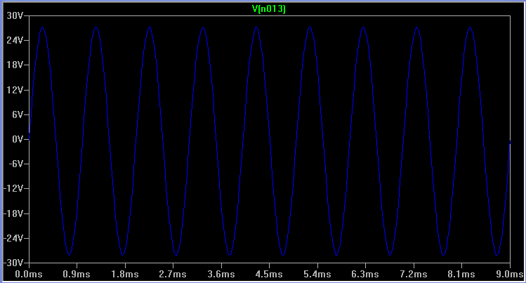

trying for best safety and stability. Differences are I go for high gain, inevitably less feedback, around 12dB left for it in the Tian method LTSpice analysis with my now drivers. Also controlled the bandwidth to 1MHZ -3dB (measured) for good square waves up to 50kHz without input and output filtering yet (can be needed on real speakers). My goals are never to achieve ''best'' in general but rather ''adequate''. I had even checked 300MHZ Ft Sanyo video transistors for drivers but the amp went too speedy for keeping oscillation trouble at bay. If it will safely and stably outperform the F5 standard in the long run (a rather comparable concept but high bias) in my system (speakers having a 4ish Ohm orchestra power region Z curve) I will be content.

The driver BJT has to swing more than 55VP-P just below nominal power. That means ~40-50mW RMS to be expected when Iq is about 2mA. The drivers when TO-92 can take it after the local CCS trick. Before they blew since with just a resistor their Iq run away hard, frequently. With the CCS the sqw rise time went up significantly also, and the faster TO-92s showed periodic oscillation. Fortune had it that the PHILIPS brand BD pair kept behaving in all areas, with the open possibility of running much more Iq in a future experiment when all other parameters will be fixed. The CCS is good for PSRR there also.

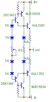

Apassgear,
No disrespect intended, I always get a little concerned by power nuts. It is always a good measure to make the SSA as it was intended, familiarize yourself with it quirks, shortfalls and advantages, and most importantly get a feel for its sound whether it lives up to your expectation before pouring a bucket of transistors into it.
It is relatively easy to expand when you are satisfied that it is the amplifier that you want to live with.

Don't know, got to listen to it critically first when I will have a satisfactory stereo build on hand, hopefully soon.
