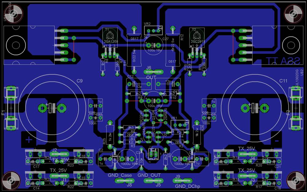

Simple Symetrical Amplifier
Some little cosmetic modifications😱😱😱
Borad is standart size : 160x100mm
You can replace the front end transistors with BC550,560, with no changes to the front end components. BD139/140 can replace the 2SA1478/2SC3788, with no change. The larger part is used because they can dissipate more heat than the front end TO99 parts, and you can run more current through them to drive the outputs.

Marc very good PCB you've made here. :up:
What about choice between NJL3281/1302 and NJL4281/4302?
If you didn't order them yet I suggest you to take NJL4281-NJL4302 because of their higher current gain (hFE) noted in datasheet.
In a real case of a 5A output (speaker) current VAS transistors (T1, T2) would have to provide 20mA signal current to the bases of the output transistors (at hFE=250). So for an amplifier design simple as this all transistors have to be at their best performance level (max hFE) to get lowest distortions possible.
I hope you will use this amp to drive speakers with impedance curve of more than 4 ohm. 🙂
P.S. VR2 should be 100 ohm trimmer. It will be set to 8,8 ohm at Iq(VAS)=5mA and Iq(OUT)=100mA (hFE=250). 😉

Ok thanks Lasy Cat. I will have 5 couple of each. It will be eventually for Home theater 5Ch in small room (15m²). These bord will make a compact size 5ch amp. The speakers doesn't normally goes under 5Ohms. Thanks for value advices. 5k on biasing pot is a device copy mistake.

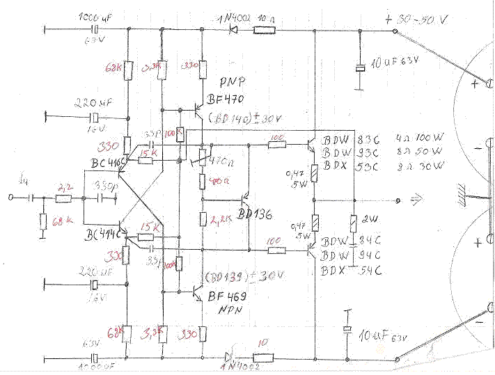

I am looking forward to your future work on even simpler front end such as attached. My darlington transistors have hFE 15K-30K, fT 60MH, Co 55pF. But why would this topology not suitable for ordinary output transistor?
hFE at what current?
How does the effective hFE vary with current?
Integrated Darlingtons in my little experience do not behave as linearly as discrete, driver & output pair when well designed. You must not omit the driver emitter resistor and preferably the driver current must be decades higher than in an integrated Darlington.
hFE @ Ic=5A, Vce=4V, that's what the spec says. Of course, it is just for rough relative comparison with other darlingtons, not with ordinary BJT.
I think all darlingtons have driver emitter resistor (in this case 70 Ohm). It is the driver's base-to-emitor resistor that sometimes omitted. What is the benefit of this Rbe?
