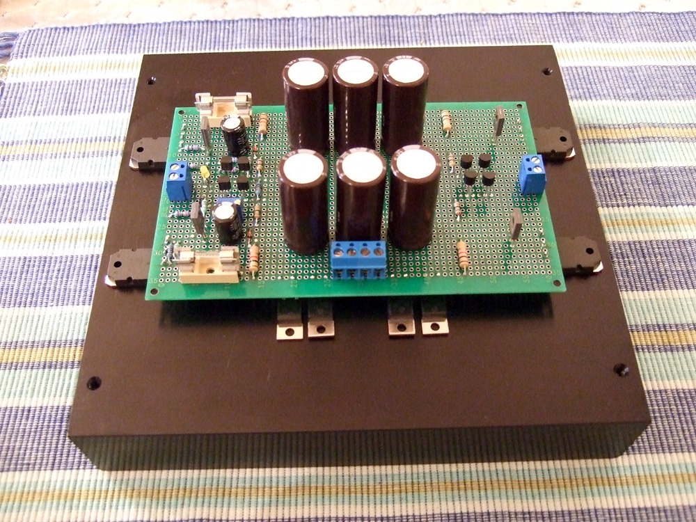

...now I am in the phase to test high performance version and pics will follow. What I am after is an amp with no more than four outputs, capable of delivering some 100W and to have the best sound as possible (to mine subjective taste). I am not in a rush to make it immediately, now, that is even better since I love fiddling around the electronics stuff. The goal is always important but the road getting there is offering much more fun. :cheers: ... 😉
Andrej, did I miss this high performance 4 output version? I tried browsing the thread but can't find it.:scratch2:

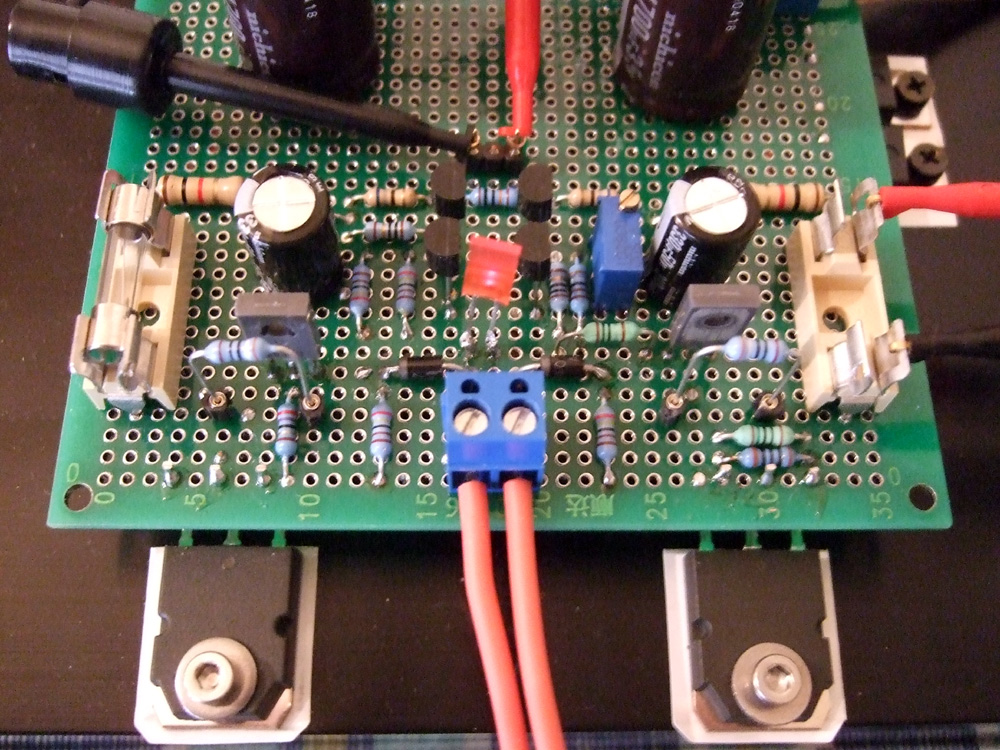

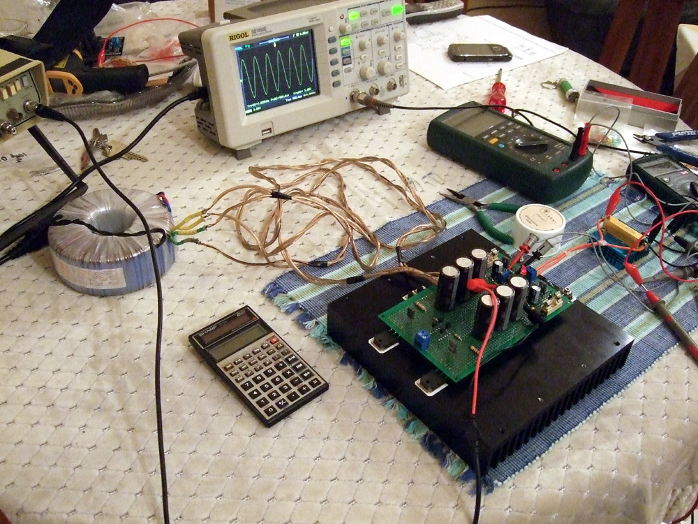

Exploring the 31dB beast.😀 Drifty cheeky rascal! LOL.
Yes stereo, its not rising serious heat though it runs ~210mA per 30V rail. Its a 0.28C/W sink. Mono as it is now face down, barely warm on the business side. Trying to establish some safe bias point in the drivers for now. Its prone to run there. The led helps a lot.

I saw that the output offset trimming mostly works counter input offset, since there is full gain at 0Hz. That changes conditions when the input impedance is connected or not to a source. Can spell disaster when an RCA is accidentally pulled breaking earth first. What about a second trimmer for the NPN input transistor's Re? That could nearly null the base currents difference creating offset over the input resistor?
Basically SSA input is DC coupled, so normally there is a full gain at 0Hz. Preamp output DC must be exactly 0V at the SSA input pin, therefore correct DC offset trimming is performed with input pin shorted to the GND. I don't suggest you to have a trimmer in Re position because these resistors are in the signal gain chain and the difference between two of them would cause gain unsymmetry.
Better solution is to inject very small current from a second trimmer (+/-15V) to serial resistor to the input pin. This could enable SSA to have 0V input/0V output conditions with opened RCA input connector and no change would happen when no DC source will be connected.
BTW very nice proto layout Salas, only that I suggest you to glue input BJT pair face to face. It is mandatory because of the thermal conditions compensation. 😉
