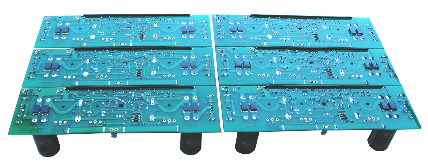

I second that, Nico. Alex is the best pcb artist I've seen on DIYaudio, and he's fast, too.
I spend tens of hours on mine, and it's always difficult to get that artistic look, which necessary or not, I'm driven to achieve. I suspect it's like juggling, you can either do it or you can't.
Hugh
PS: Here are six NAKSA 100 modules, to give some idea of how mine look.

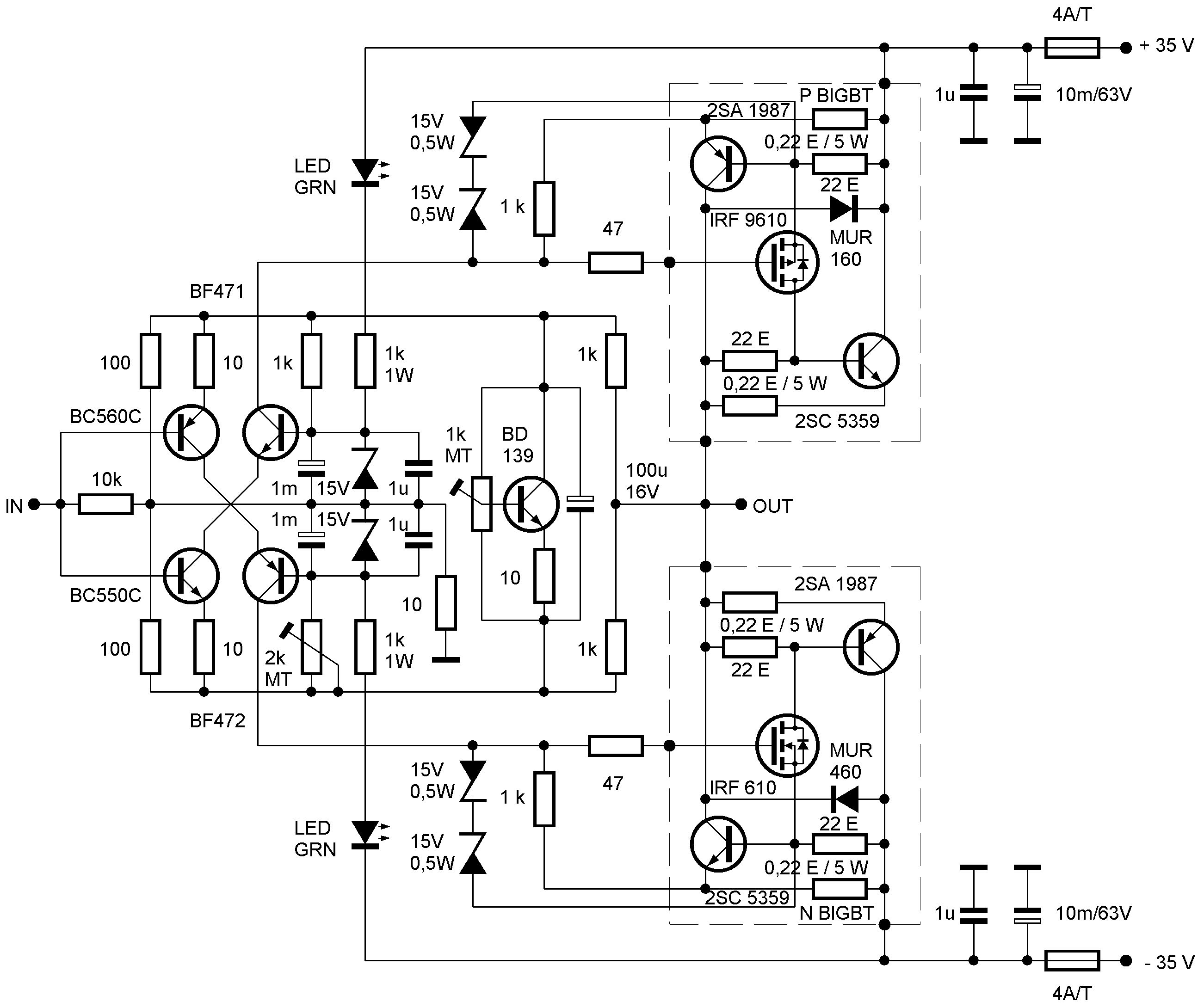

This schematic, which shows BC550/560 in both bjt stages, should work fine with mosfet output, correct?
SSA BIGBT Basic
......and now rev 1.5 for BIGBT variant ......🙂 please check PCB for errors , not tested .
Alex.
Dear Alex here are the remarks about SSA BIGBT Basic PCB, can you please make all these corrections:
- BC550C, BC560C have different pin layout (base connection pin in the middle)
- left feedback 100 ohm resistor is unconnected, connect it to the GND
- change two 470uF/16V elco to 1000uF/16V
- on the left side of the input connector place a 10 ohm GND lift resistor (opposite side to 10k resistor)
- 1k/2W resistor should be connected to the rails at FUSE output
- in series with each 1k/2W resistor please connect green LED to indicate power
- please put MUR160 (smaller) instead of MUR460
- Vbe multiplier transistor should be BD139 instead of BC550C, screw mounting to heatsink
- please align output transistors symmetricaly from the left/right PCB edge
- please give +1mm more space between outputs/drivers (too close to each other)
- trimer 1k should be near to BD139, you have than only two jumpers wires
- please put (sch below) 10 ohm emitter resistor to Vbe multiplier
- rearrange positions of 1k/2W resistor, 1uF, 10nF, to put 10000uF/63V on PCB
- place one more GND connection (SPK-) in between two existing (three in the line)
- place only one OUT pin connector in the middle
- 1k feedback resistors should be connected at exact OUT pin (not 2 cm away)
- 1k from each gate of IRF to emitter of the output BJT are missing
- please put two 15V/0,5W zener diodes in series (chatodes towards each other) from gate to source of each IRF (overvoltage gate protection)
- heatsink from each power diode MUR860, should have holder solder pin, like at BF's
- the name of the PCB: SSA BIGBT Basic
- the schematic is by Lazy Cat 😉

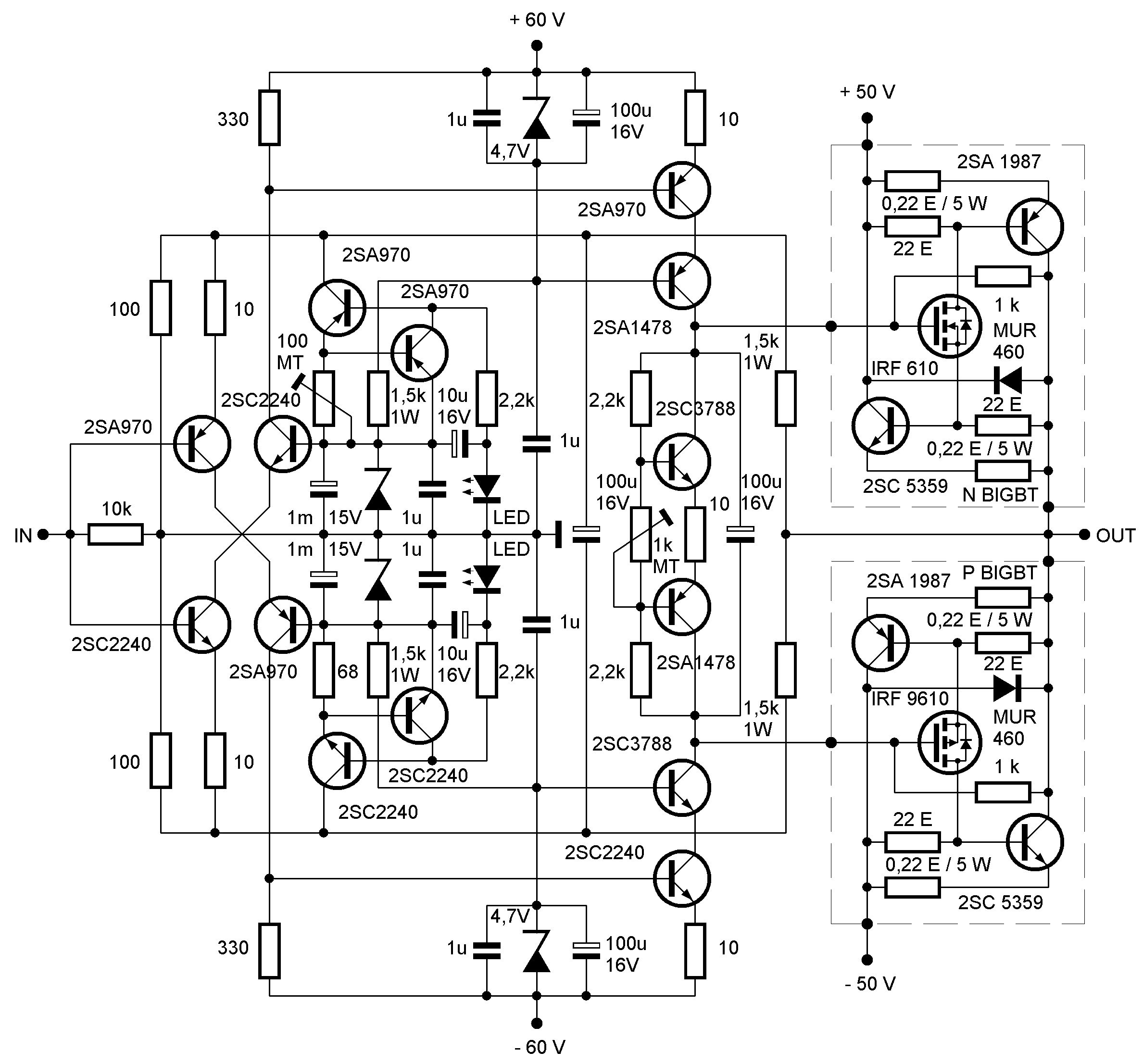

BC550C/BC560C (2SA970/2SC2240) are suitable for both stages if the rail supply voltages are +/-35V and cascode collector current is 2 to 5mA, so to keep them safe from Vce-max and power dissipation point of view.
If supply voltages are higher I recommend BF471/BF472, 2SA1478/2SC3788 or similar TO-126 case high bandwidth transistors. 😉
