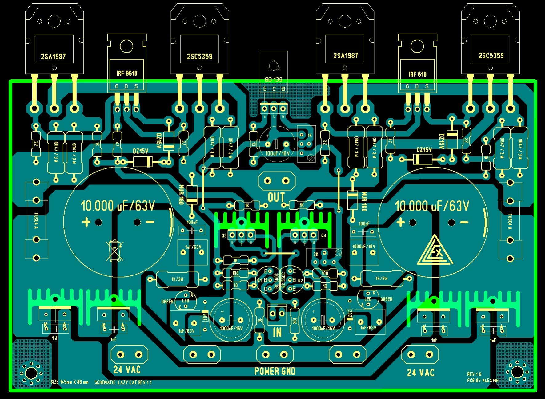

SSA BIGBT PCB rev 1.5
same PCB dressed 🙂 same size 145 mm X 86 mm and B & W file for toner transfer or photo ......😎 Thanks for the kind words addressed to me 🙂

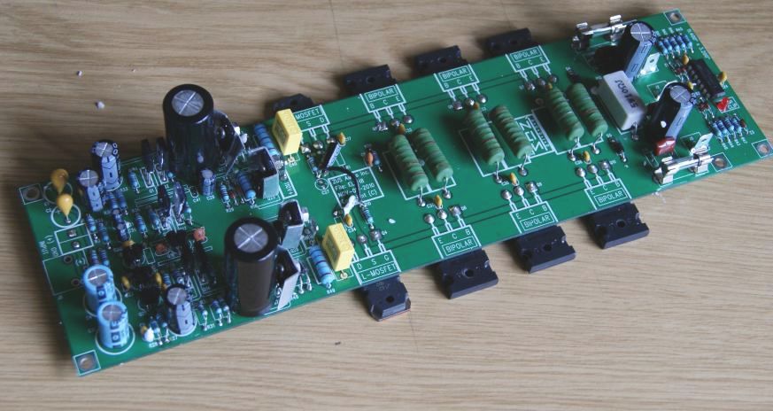

Nice Board! One question, is this rev 1.5 or 1.1? the post says 1.5, the files 1.1

It's written on the bottom of PCB:
Schematic Lazy Cat rev1.1
PCB by Alex MM rev1.6
@alex mm
Capacitor to the left of your logo is 1uF/63V, but you wrote 1000mF/16V.
@alex mm

I also would make thicker traces for the power-BJT in the layout.
But I like your circuit 🙂

May I be bold to ask that you publish Gerber plots as well for those who are making professional boards. Just zip them up and post them with the PDFs.
The layout is very, very nice, thanks Alex.

It would be great if Alex prepare an extra PCB for all-japan bjt devices with respecting Nico's circuit.
I wonder why all pcbs have power supply unit? Is there reason for that amplifier should be close to power unit? If it is not mandatory, PCBs should be bare in my opinion.
