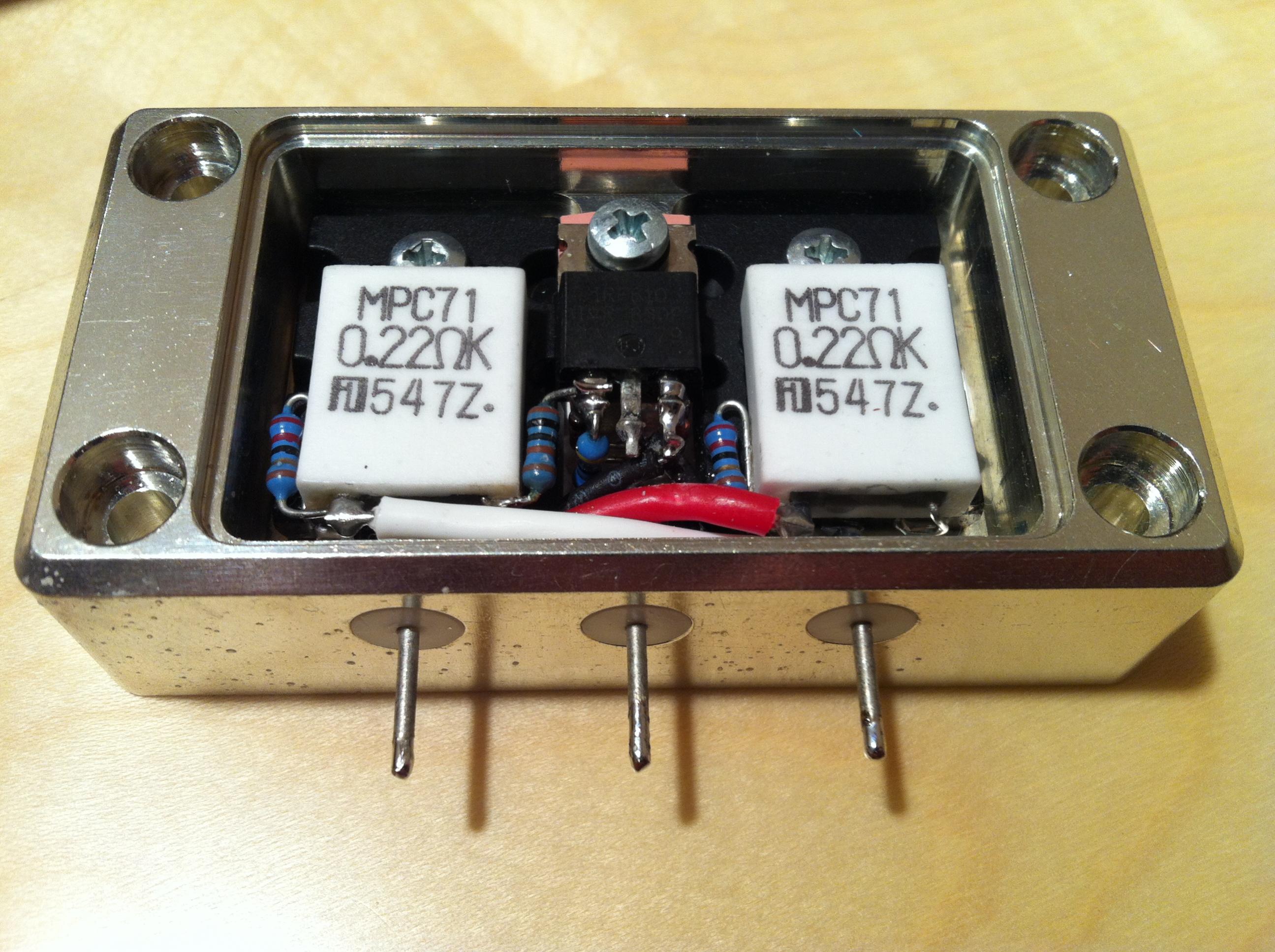

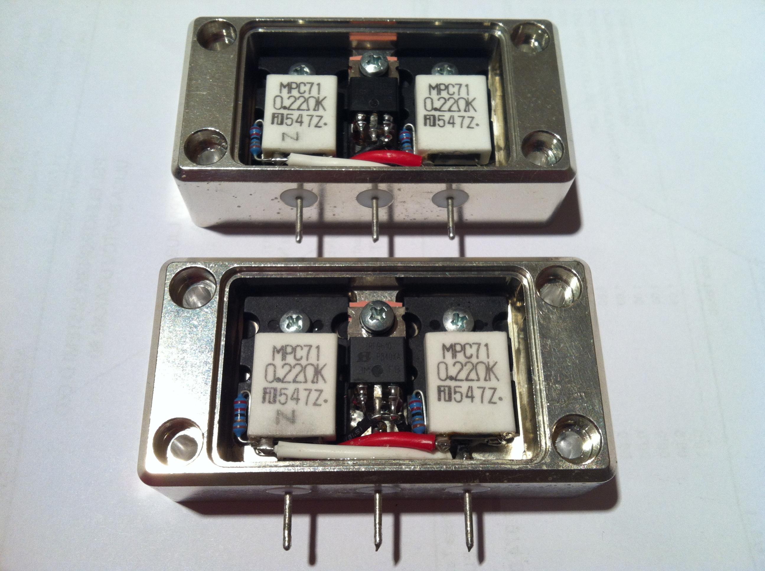

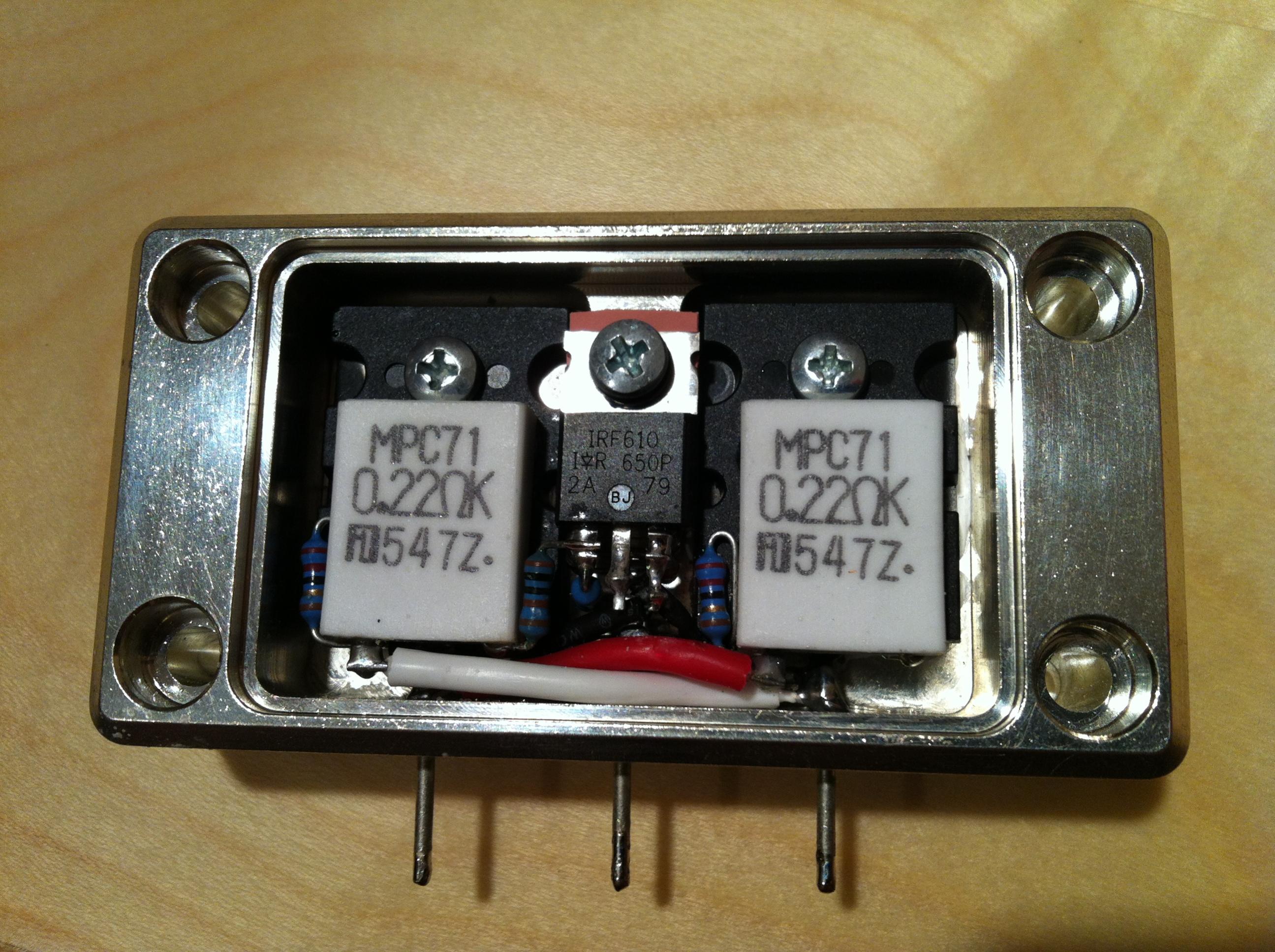

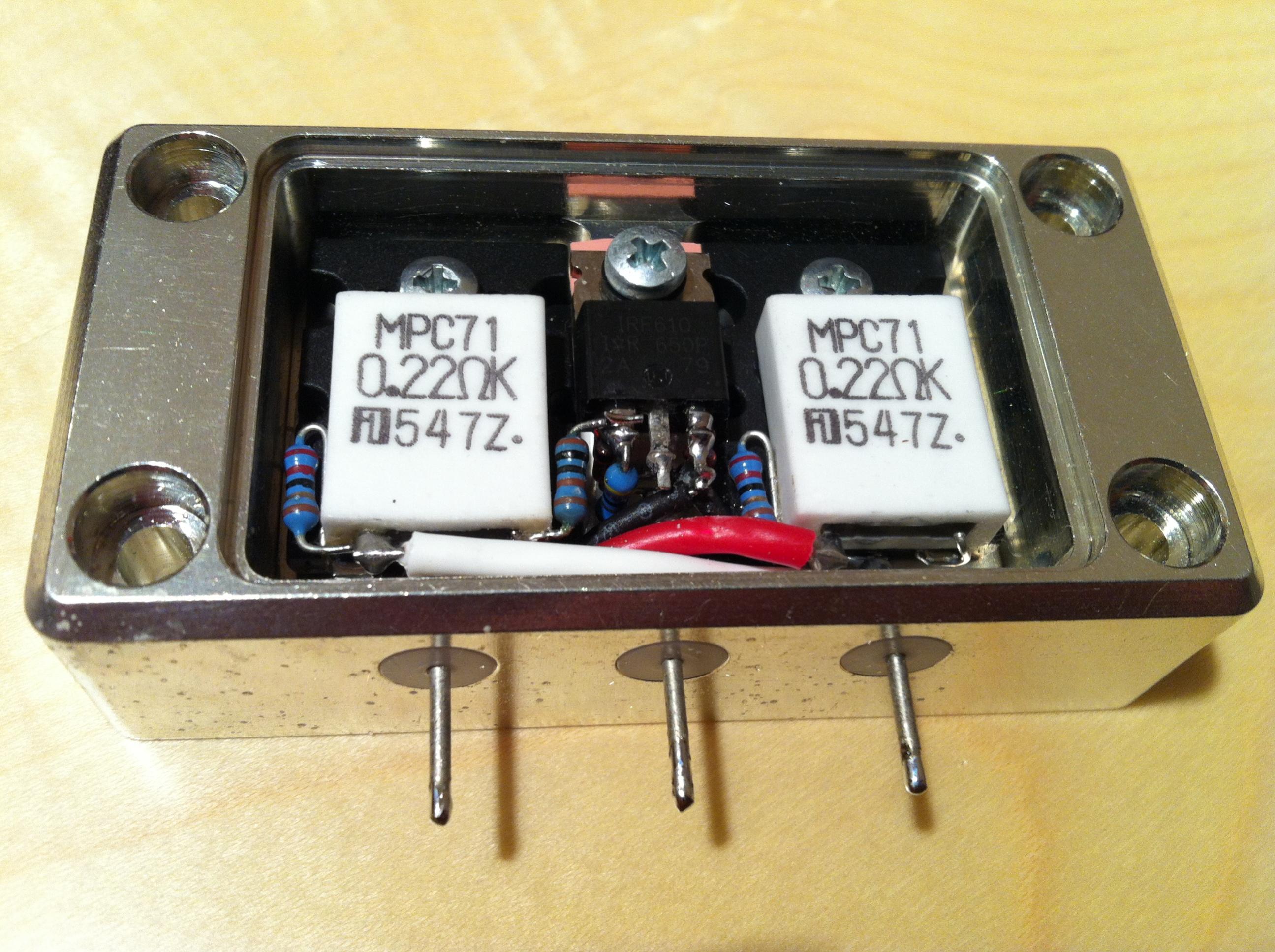

BIGBT in Cu Chassis
For some who may or may not know yet, this is how my High-End BIGBT looks like (made in 2012). :D
