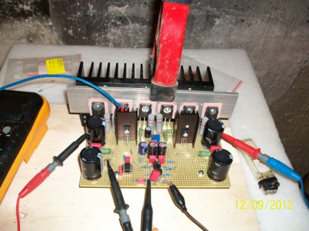

And here it is. Running smoothly.
Offset setting was pretty easy; within +-5mV.
Bias perfect with 3mA, 14mA and 160mA in input, VAS and FET respectively. Without any manual setting. The input BJTs are BC550C and BC559C.

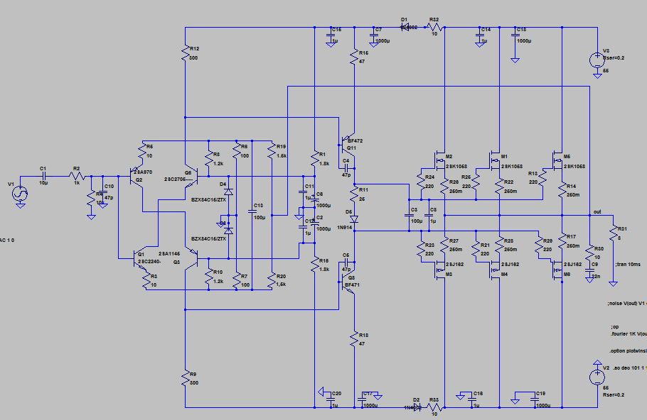

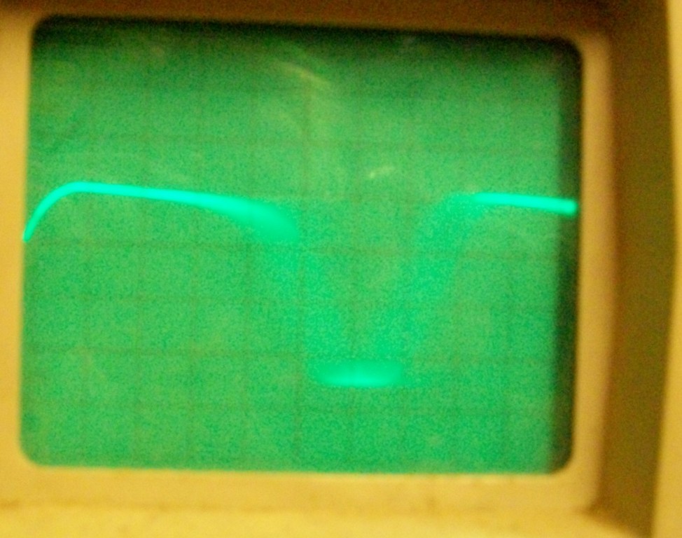

Hello, I am following with great interest SSA . I have provisionally
SSA established an Amp. Unfortunately, there is a problem.

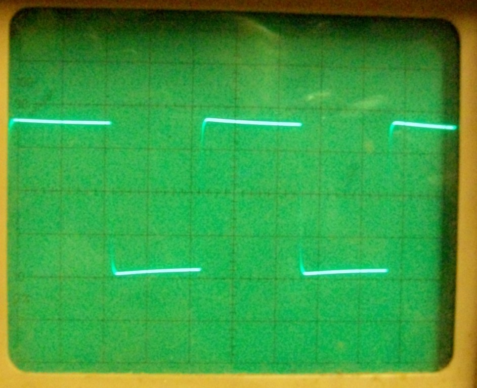

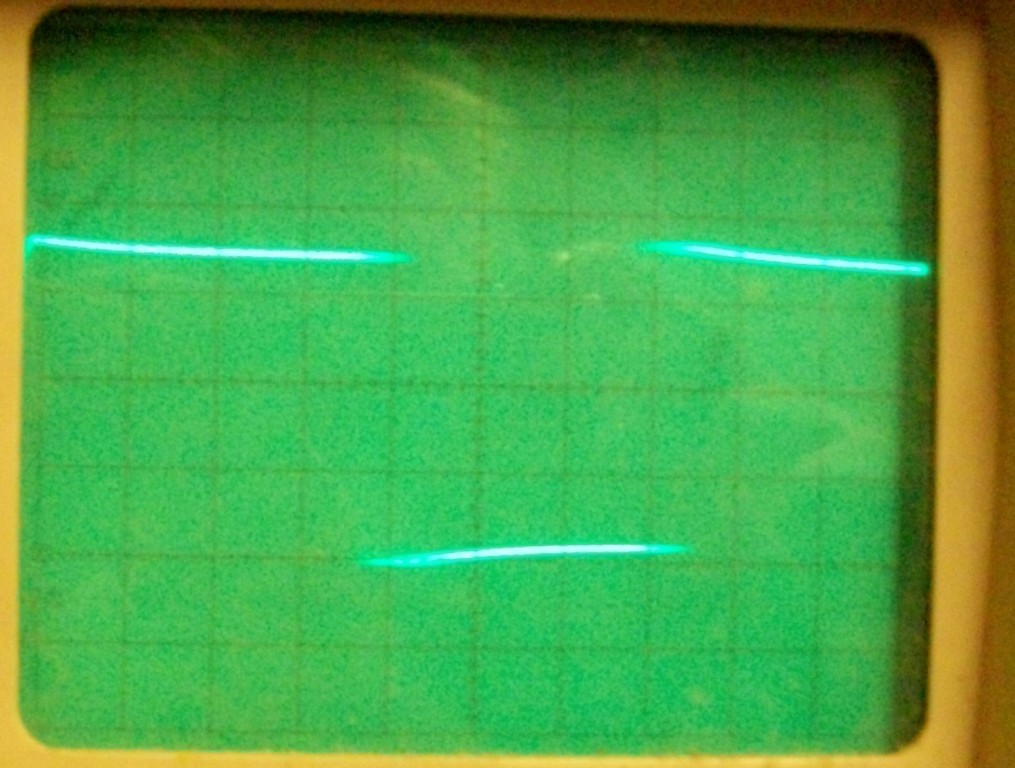

The amp only worked up to a supply voltage of + - 35 volts properly. I increased the gate resistors to 220 ohms, and the capacitances between the base and emitter of the T8 and T11 increased to 47PF. The 3db frequency is reduced to 500 Khz. The amplifier is now working to + - 45 volts properly. From about + - 50 volts, the amplifier oscillates. But I have a transformer with 600 watts + and - 55 volts, which I would like to use. The amp is loaded with 8 ohms. The oscilloscope is set with 5Volt/cm. The frequency of the test signal is 10kHz. What else can I do? Are there any oscillations? or is anything limited.
Thanks Gerd

Gerd, VAS directly loaded with 3 pairs of mosfets simply doesn't have enough current capability to drive mosfet's input capacitance plus load at full scale 10kHz squares. Intermediate driver (mosfet or BJT) would certainly help.
First you can also:
- try to observe 10 kHz squares with/without load connected
- try to use one pair of output mosfets to see if the situation is still the same
- compensate each output mosfet with serial zobel between gate and drain
If any upper measure would not help, than you'll need to install the driver stage between VAS and the output mosfets. 😉

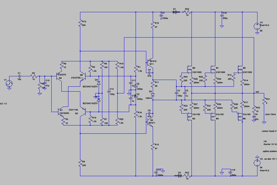

Coolwater, while you fight with stability problems, may-i suggest-you few tips ?
First to try to increase the open loop bandwidth as much as possible, means reduce as much as possible the miller caps.
You can work on the output zobel and a cap // to the serial resistances of the feedback path to tune the phases.
An inductance in output can help too, if the problem is too much capacitance in the load.
If you use a simulator, in order to track the problems, do not forget to remove the input filter cap, when you track the phases.
Hoping it will help.

Hello Esperado, Hello LC,
I have removed all 47pF Kapacitors. I tuned the phases with a a trimming capacitor in parallel to the serial resistances of the feedback path. I had a perfect rectangular signal. When I switched to a second pair of MOSFET were the oszillations again. I will turn to a driver stage. One more question: What the resistors R8 and R10 effect at 1.2 K? In my opinion, provide the resistors Transisoren the Q1 and Q2 with current when the output signal is 0 volts. Is that correct?
I connected the second board and it's working well as well... 🙂
Bias almost equal to the first board, 4mA, 18mA, 170mA! I think I've got some decent parts this time. No bad effects.
Soon gonna put them inside a nice case. Probably with a toroid.

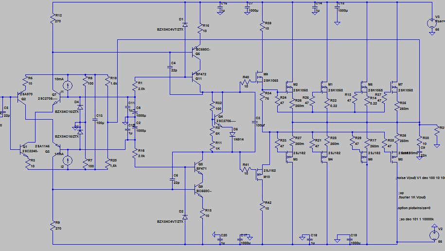

the final version of my SSA Mosfet. The PCB is in the works. A Question to the Bias:
In my opinion would be 100 mA enough to the end Fets and 15 mA to the Cascodes. What value of Bias would be useful for the driver Fets M9 and M10?
I can change the current through the cascode, by two Ways: First: I change the value of Resistors R9 and R12 (270 Ohm). second: I change the value of the Cascode -Resistors R16 and R18 (10 Ohm). What would be the better way?
Best regards Gerd
