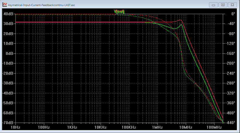

OP amp kind of error correction is actually working as OLG of the corrected amp would be much higher, it certainly can lower distortions if stability maintain unaffected. Most probably OP amp will drive the feedback signals into peaking and even into oscillations if original amp could not follow.
What VSSA in other thread surprisingly showed me is its enormous damping (extremely low Zout) gained from high OLG/bandwidth and exact feedback/compensation scheme. uV feedback precision coming out of six transistors only makes amplifier's output differentiating from unloaded conditions down to few mV.
Square waves misuse showed no instability and for me that is of more importance than mostly accepted low THD/TIMD.

Yes it increase the ratio of feedback as much as you can afford keeping the stability. (Phase margin can be unchanged, and even, we can be increased with some compensation caps in the error feedback loop, without affecting slew-rate of the power amp itself.).OP amp kind of error correction is actually working as OLG of the corrected amp would be much higher, it certainly can lower distortions if stability maintain unaffected. Most probably OP amp will drive the feedback signals into peaking and even into oscillations if original amp could not follow.
About speed, the problem with fast power amp is to find an OPA fast enough, as SSA is damn fast itself. . No risk, in my example, to saturate the OPAs, the output of the second OPA stay at <+/-700mv peak at 100Khz full power with distortion at -60dB.
I do not know if it improve the sound or not: Need a try in real world. May-be the benefit will be side of the damping factor ?
As it is simple, easy and not expensive nor destructive, it deserve a try.
I think reducing distortion of the open loop of an amp is not to be opposed to the use of feedback, they are complementary. if you can reduce closed loop distortion while keeping the slewrate with a driver (i doubt) the error correction add will reduce the new distortion with the same 10 ratio.I think a more effective way of reducing distortion would be to use drivers for the LFETs.

Well, something is interesting, below your question.So the point is to decrease distortion without impairing slew rate?
Because we increase the error feedback level, in a way, we reduce the slew-rate/correction-signal ratio.
But, because we are dealing with a yet low distortion, and because we can filter extreme HF from this added part of feedback; i believe we do not have to fear any added TIM.
So, the main benefit is to improve distortion on an EXISTING amp without modification of the amp Itself.
As noticed by L.C. an other approach is to increase OLG of the amp, not so easy while keeping-it stable.
This error correction present, of course, some negative aspects: it is a little acrobatic and need precise fine tuning.
Even if i had this idea long time before, while i was working to my protection system, i forgot-it with time and it was YOUR publication which refreshed-it in my mind. So all the credit is for you.Very nice Esperado 🙂
But you are not filtering extreme signals from the opamp. Any input/feedback signal regardless of BW will enter the opamp's output, no? Does the simulator model the effects of opamp output impedance?
I believe yes. I don't understand "enter op amp output", Keantoken. (This opa is able to drive video lines so, low impedance even at very HF and is charged by 3K. What do you fear ?)But you are not filtering extreme signals from the opamp. Any input/feedback signal regardless of BW will enter the opamp's output, no? Does the simulator model the effects of opamp output impedance?
The level of error signal is so low at audio frequencies that slew rate of the error will be negligible comparing the the ones of the OPA and Power amp itself. (both 1000V/µs)
