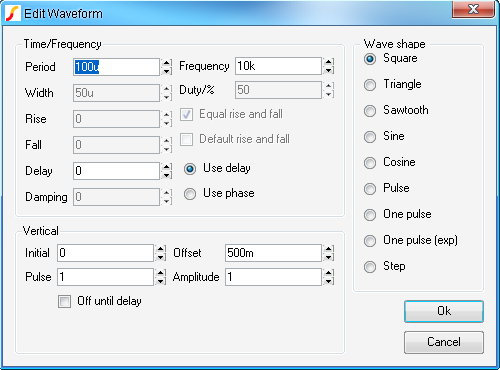

I do not understand why they do not provide an easy square waves generator, where you set the frequency, the level, and the offset... and, by default potentiometers, trasfos, and some other very ordinary parts we use all the time.
Hi Christophe.

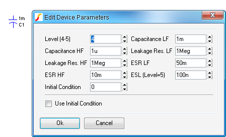

Simetrix is the answer. I use it to sim everything from solid state relay to resonant ZVS flyback converter to SSA.
It has an easy square/sine/saw/triangle/pulse generator with offset/delay and other parameters. Also a bidirectional pulse generator, potentiometers, electrolytic caps, inductors and transformers. All with settable parameters and a very easy interface.

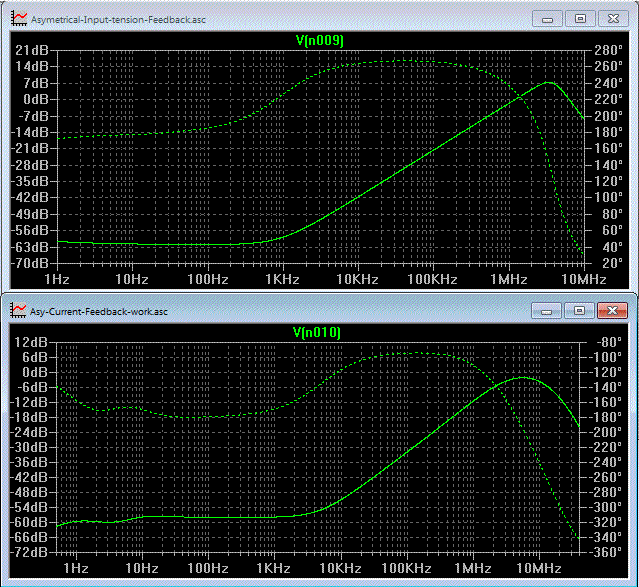

The graphs are difficult to compare because the scales are not synchronized.
Both CFB and VFB depend heavily on implementation. I'm not sure what part of the circuit these traces are from but I would guess the input stage for the VFB version has much higher transconductance necessitating more compensation to load it down enough at RF to stabilize it.
If the traces are taken from the VAS input, then the rail voltage variations will be added to the signal, obscuring the actual behavior of that node. Unless you used perfect voltage sources for the supply.

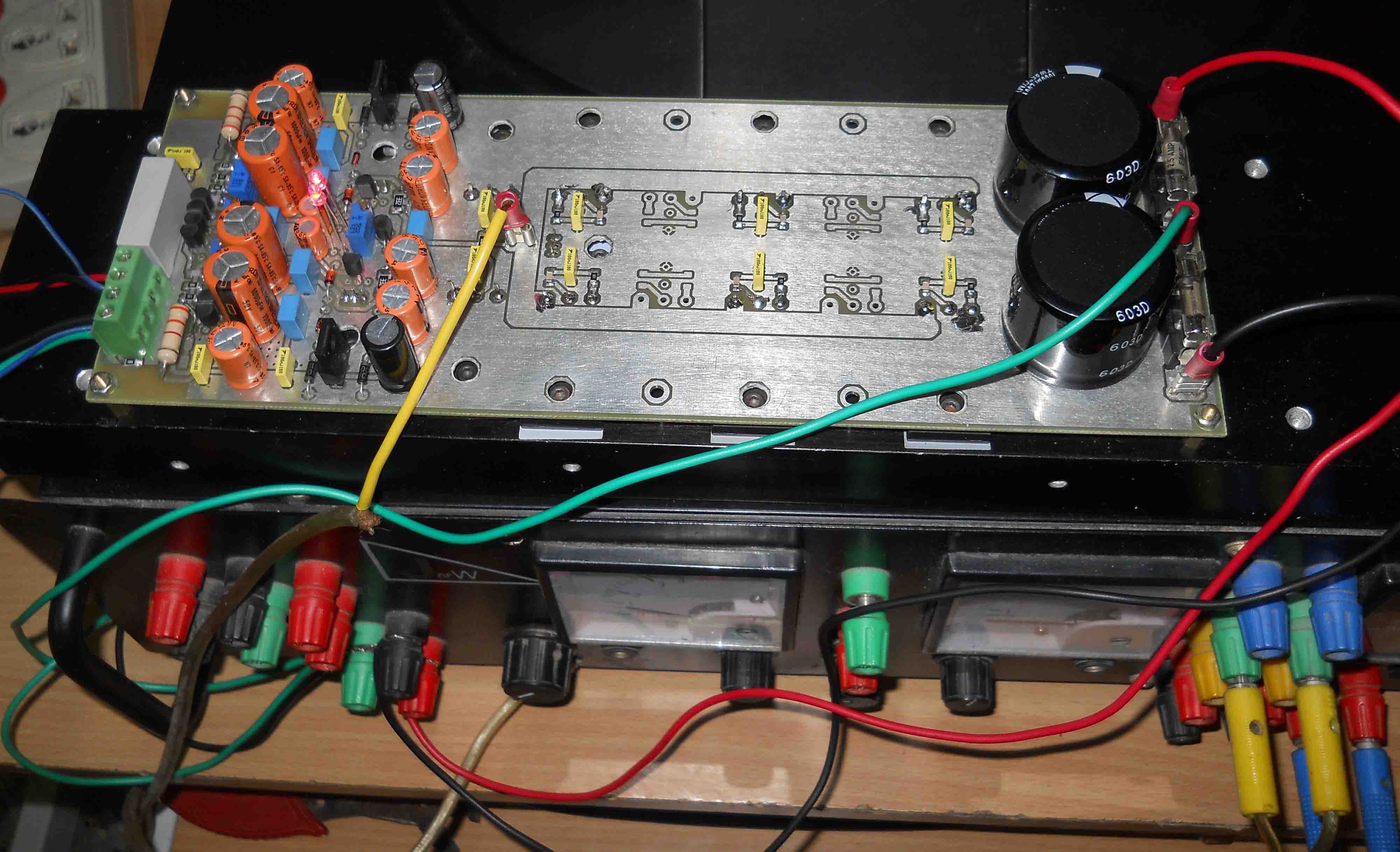

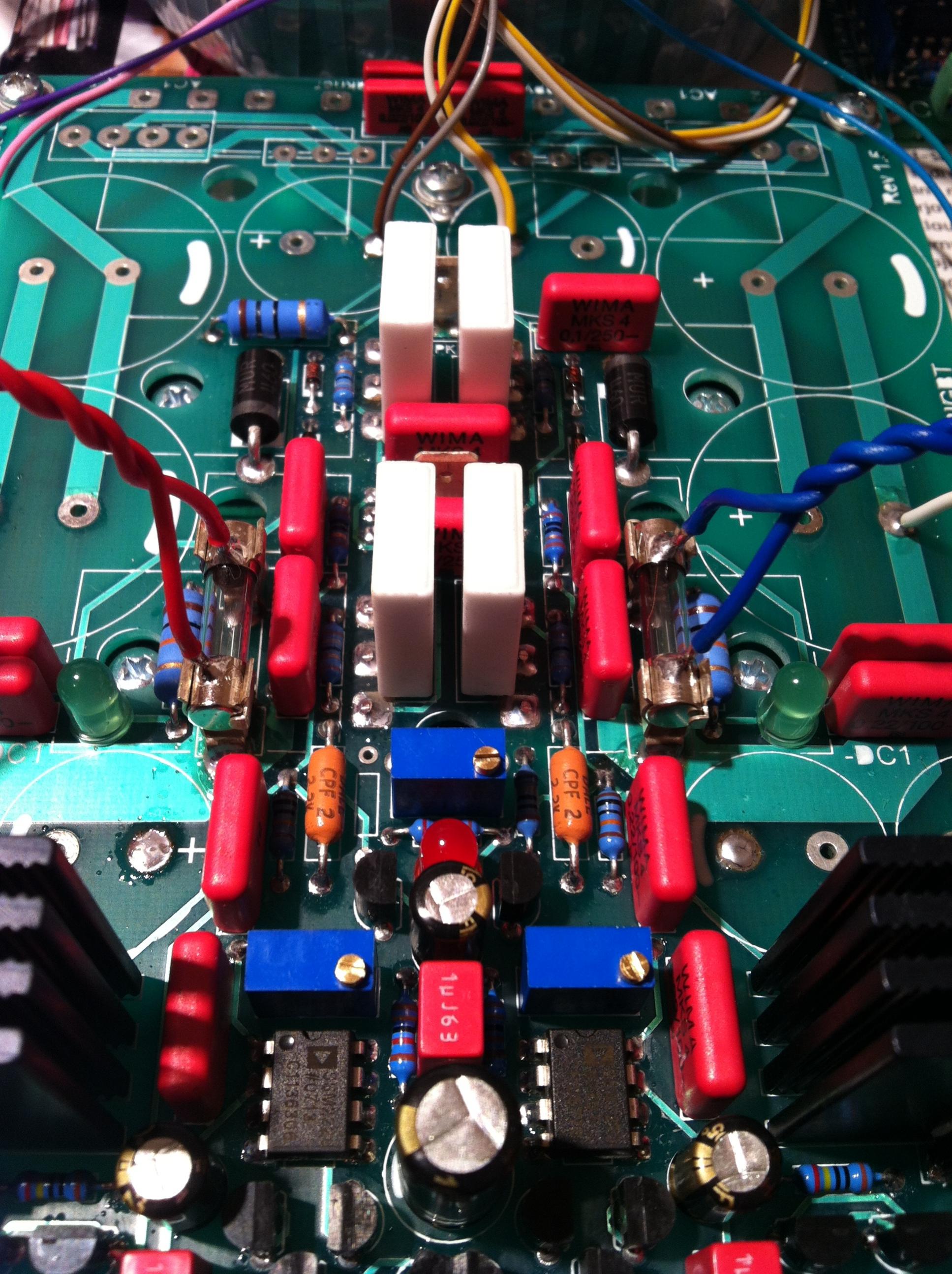

CSA prototype functional at last. Today I installed output BJTs, so the output BIGBTs are finally completed. Closed loop stability compensation scheme without any change as expected, output bias tested up to 0,5 A, DC offset +/-10 mV, very stable output. Sine waves from generator OK, 100 kHz square waves OK. The only thing left to finalize is temperature compensation for the main heatsink, 10 k NTC used as temperature sensor (pic), only 15 pF from NTC to housing (case GND) means also from VAS output to GND.
CSA's next stage is to finish the second channel and housing with heatsinks, toroids, etc. 🙄

What and why are those wire soldered to the fuses?😕
hehe in testing phase instead of a real fuses, blown ones takes their place. Those wires connects 25 ohm/20 W resistor on both rails to prevent any outputs damage when closed loop stability is calibrating to optimal local feedback C. I use trimmer C on both VAS sides to find optimal capacitance. In CSA they're around 10 pF. 😉

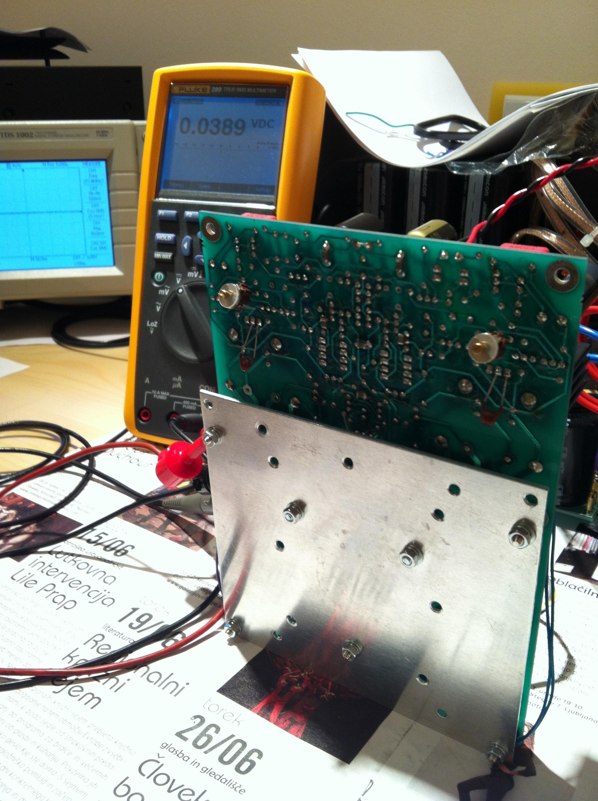

As you can notice from the pics this is testing assembly with thin alu plate to thermally connect all driver output transistors and NTC sensor. The plate has GND potential and serves to electrically/thermally simulate the heatsink and still to enable enough space to make all necessary testing evaluations easier, like to set compensation caps, minor parts value modifications etc.
Thermal capacity of the plate is zero, so all the power measurements and sound checks can be done later in the process when regular heatsink will be here. It is ordered, just waiting to be delivered and than I'll report about SSA CSA comparisons etc. 😉

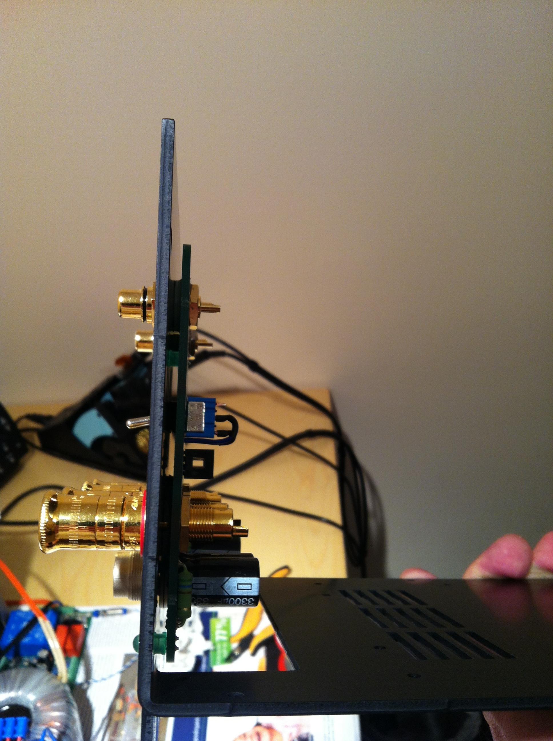

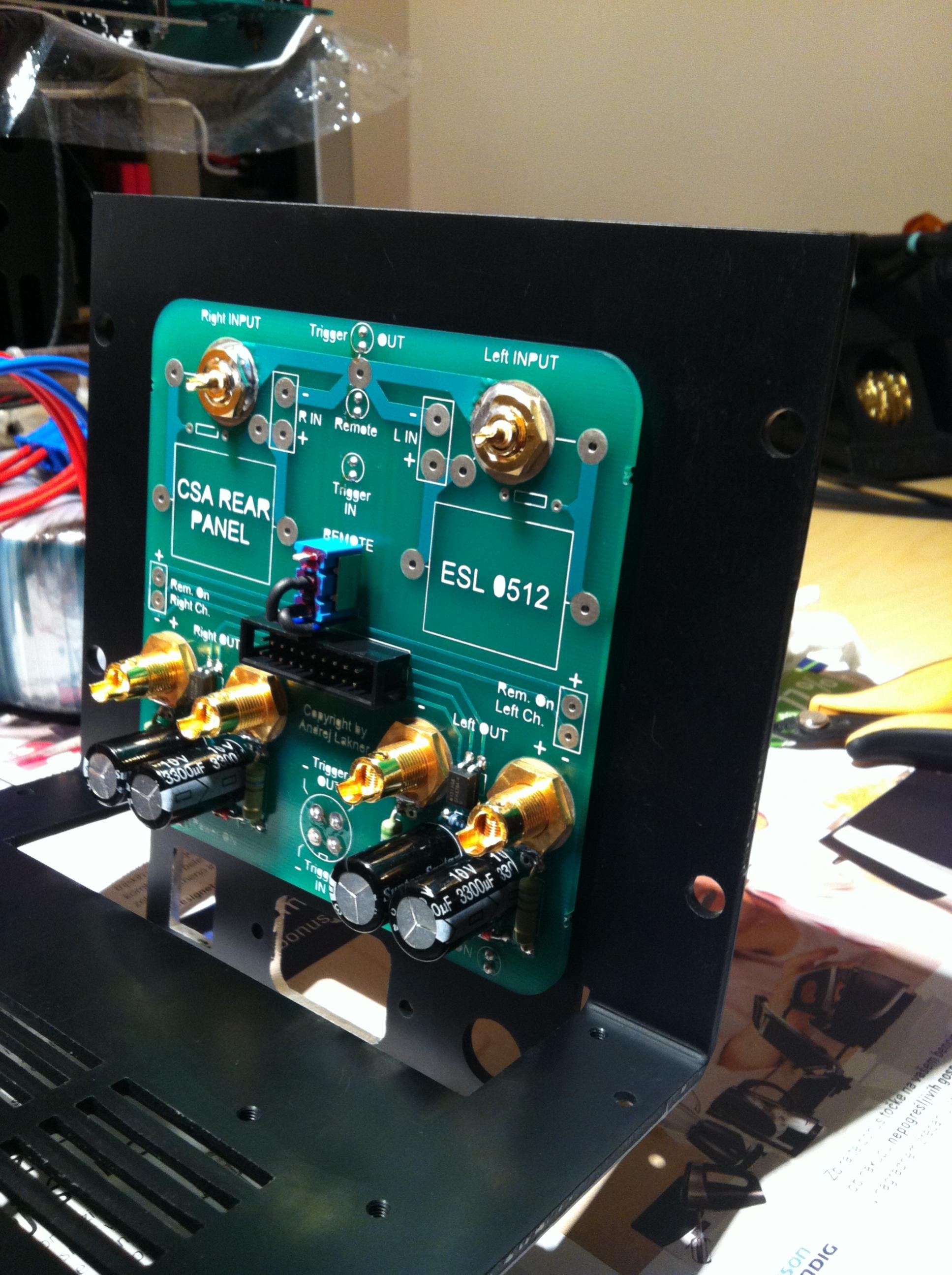

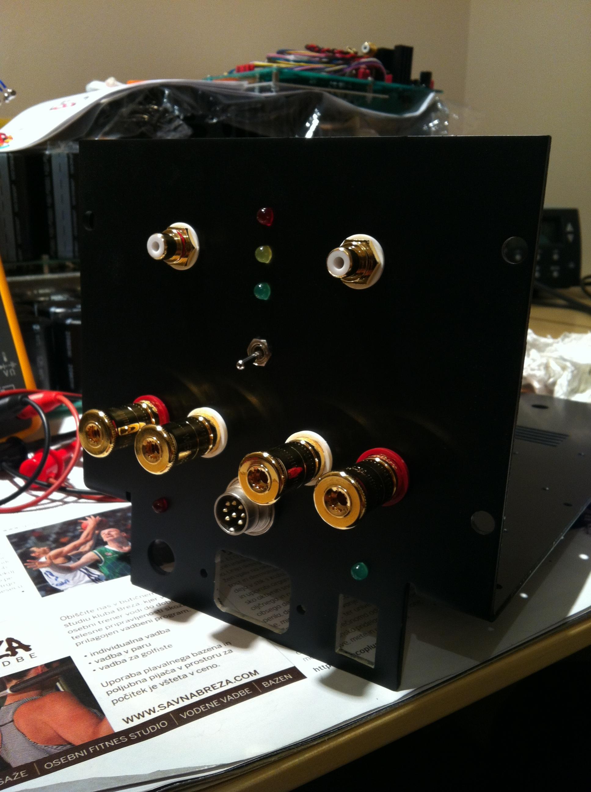

Before big heatsinks for CSA arrives I am actually not just waiting, for instance today I assembled real plate PCB to the case plate and installed all connectors, LEDs and remote/local trigger switch. Pictures says it all. :smash:
