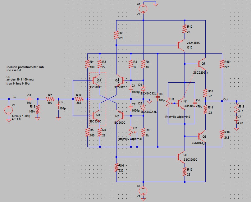

Simple Symetrical Amplifier
With no drivers for the power transistors distorsion
will be very high , something like 1% at 1Khz and 5W on 8 ohms ,
and as such it wouldnt even reach the hifi standards of the 60s....
Not all distortion is created equal, so I can testify that the simple amp can sound very good at modest power levels. A bigger problem for the simple BJT version, will be getting to a stable operating point. You will need a good current source to replace the resistors R3,R5 for the front end, and you will need to incorporate LC's NTC thermal compensation scheme.

Thankyou very much Sir Wahab, i see your post about SSA Allbjt with driver, in post #196, so with my schematic above i got around 1% at 1khz? and only 5W on 8ohms?
Of course the max power is higher , in the vicinity of 50W and the 1%
distorsion is for 5W , at higher power it will rise to a few % at 16W
and so on while distorsions such as intermodulation will also skyrocket.
As said ,better to add drivers to the power devices (or use darlingtons
wich are a driver and a power transistor packed in a single case),
that s necessary to have a good enough amplifier.

Dear LC,
based on ssa bjt basic please check my component value.
Hi naf.
Good to see that you want to go further with SSA than just stop and type and discuss and etc. 😉
Your schematic seems okay, but some points...
1. Use fixed resistors of 1K2 value in place of R3 and U2.
2. Use offset control at the input like your last SSA. Two 10K trimmers + 1uF + 1Meg. Much easier.
3. Use 10K for R17. 1K for R7. Remove R18.
4. R4 and R8 should be 1Watt type.
5. C3 in not essential. So you can omit it.
p.s. Please ignore whatever whoever says about the merits/demerits of your schematic, it's purely their own prejudice. YOU are building YOUR own amplifier, YOU decide if it sounds good or not. :up:
All the best.

Hi naf.
All the best.
