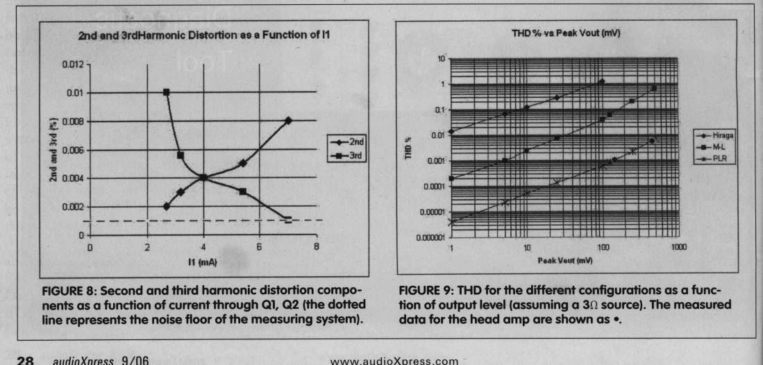

Bigun, i am not an expert in power amps. My forte is low level design. See a calculation made my Rossiter on his MC Headamp. At 4mA the distortion curves cross. See also the distortion over level of the Hiraga ( sigle ended no NFB ), the Leach ( parallel symmetric
no NFB ) and the Rossiter ( parallel symmetric current feedback ). The shape of that curve is the same although on different levels. This is THD so says nothing about the distribution of the harmonics. I whould bias the stage of Fig.8 to something between 5 and 6mA.

Nico, I may be finding a correlation that doesn't exist because of wishful thinking but I'd guess that your SE i/p amp sounds warmer than the SSA amp because of the difference in H2 content arising from it being asymmetric and not having high levels of gnf to reduce it. What interests me is the impression that the SSA is more 'vibrant' - it sounds like a desirable quality - can you say more about it ?
Joachim, that's an interesting plot. But I can't figure the physical reason for rising H2 with bias. Nelson says he has seen H2 in his symmetrical amps at low levels because of natural device mis-match but above 1V it's predominantly H3. Mind you at the low levels of distortion being simulated for SSA it may not matter !
Good question. That would require a spectrum analysis over level and frequency with a huge dynamic range. You can imagine that you end up with a universe of data.
Then putting that in perspective to what we hear and the Nobel Price is yours. I gave up on harmonic distortion measurement some time ago. I simulate it and then i listen.
