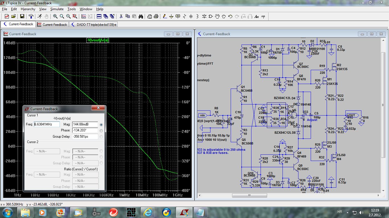

Wahab, please, play with my simulations here, Crescendo revisited
You will see the differences between CFB and VFB *on the same amp*.
VFB ---> NFB
Bandwich: 200Khz ---> 3Mhz
Slew rate: 220v/µs ---> 1200v/µs
hd: 0.0023% ---> 0. 0002%
IM: x ---> x /10
As you can see, and as said L.C, improvement is in all the domains (except DC stability). The major improvement is listening pleasure.

It is clear that you are in love with this amp, and I can accept that. I just can't accept that this type of amp(current feedback) is the Holy Grail of all amps. You need it for other kind of amplification, but for audio nothing is wrong with voltage feedback.
I do not think that an audio amp needs so wide bandwidth, and so fast slewrate, 220 V/usec is more than enough.

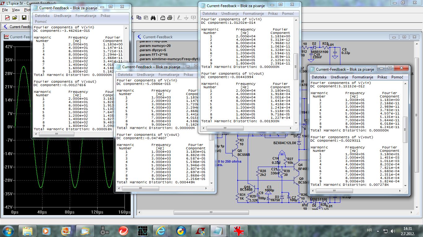

I simulated a bit last LTsice schematic you have sent and here is the result. I changed D1 and D3 only from zener 3.9 V to 4.7 V as I do not have models for your originals.
At output level close to clipping THD20k is still quite low:

I my humble opinion this amp is in the B. Cordells EC MOSFET amp class and I doubed that any golden ears could distinguish between them.
Total Harmonic Distortion: 0.002643%
I think using voltage source of equivalent voltage rating is more accurate than changing zener voltage from 3v9 to 4v7. This topology has issues with stability. You cannot change a value and expect it will be fine. Problem is, there is trade off here between THD and stability. If you reach such a low distortion in simulation (0.0026% seems to be too good to be true), I have a feeling that it is not a stable circuit anymore.
So how do you define your minimum stability (requirement) in simulation?

I saw that you have trimmed the current source (lower ccs has 3K32, upper ccs has 3K3) and also the base voltage of VAS transistor with 30 Ohm above zener. Could you give a hint how do you do the trimming process?
When I simulated with voltage source of 3.9 V I got this:

and with voltage source of 4.7 V I got this:

so maybe thia amp works better with 4.7 V zener instead of 3.9 V.
dado
With the tendency for the output to have positive DC, and with both FB paths have equal 1K resistance, it is the lower input transistor that will have the tendency to get too low Vbe.
There are many ways to increase this Vbe. Easy way is to increase the current thru the 1K resistors (set by the 3K3 of the CCS).
Using higher zener voltage will have the same effect to the CCS (i.e. to increase current).
Increasing the FB resistors (e.g doubling the resistance with 2K||75R) will also solve the issue.
But all of these will put the circuit in worse stability. This is probably the reason why this topology is not popular, despite its good sound character.
Yes, that is correct, but I've got to high distortion 0.3% at 1 kHz and 0.5% at 20 kHz and very bad FFT, when 3.9 V was used. I don't get it, some people like high distortion or what. By the way, with 4.7 V phase marhin I've got is 47 degree. Am I doing something wrong with this simulatio??
dado
For Dc ? i don't care it in simul, but in real life.
Is it simulated performance? What is the real number, not simulated numbers? I believe that it is very difficult to achieve simulated performance without careful and skillful fine tuning because from the nature of this "current" feedback it is easy that the input transistor will have too low Vbe.
Yes this distortion is in simul, i don't have powerful enough distortiometer to measure so low levels in real life. In real life, i use crossed fingers when power on, then my ears and an oscilloscope. ;-)
I published-it for educational purpose, to demonstrate the benefit of Current feedback.
But this amp is playng music (fine, so fine) in my real system. I use-it to power a JBL motor in a spherical waves horn made in plain wood, between 1KHz and 20 KHz
The resistance you are talking about is just a fine tuning for 0Vdc at the output. I needed-it because my protection circuit is tuned to be very 'aware' of DC and HF. The real values are not exactly the same on both channels.
I am waiting L.C propose his parts (if i can afford them) to compare on a musical point of view.
I don't get it, some people like high distortion or what... Am I doing something wrong with this simulatio??
Hehehe nobody likes high distortion especially when it is third order. The only objection I have with this circuit is the relatively higher 3rd order distortion as compared to 2nd order. I would prefer higher overall distortion but from 2nd order.
You didn't do something wrong I believe. Here is a trick:
The FB resistor (1K) is connecting the input transistor's emitor and the output.
You want the input transistor to have Vbe of at least 0.6v (approximation). Base voltage (Vb) is assumed zero and so is output voltage (Vout). So to get 0.6v at the emitters (Ve) you want a certain current thru the FB resistors (This is what the CCS is for).
V = 0.6V
R = 1K
I = calculate! ---> 0.6mA.
CCS current == current thru FB resistor + current thru transistor
Note that the current thru the transistor is also affected by the collector resistor (1K here, which is a good value). This current is around 0.5mA. So more or less you want the CCS to give out 0.6mA+0.5mA = 1.1mA.
You may want to set both CCS to output 1.2mA. You will find that the higher the current, the lower the distortion. That's why you got ("too") low distortion when you use higher zener voltage which affect the base voltage of the CCS, giving very high current I believe.
But I suspected that it would be better (e.g. for the stability) if top CCS gives different current than the bottom CCS. With positive voltage at the output you want the top CCS to have slightly higher current. You can try 1.2mA for the top and 1.1mA for the bottom CCS.
That's just my guesswork, you will have to troubleshoot the correct setting after you build it (if you intent to). In Christophe's circuit, top CCS has 3K3 and bottom CCS has 3K32. This means that the top CCS has slightly more current (I guess). But unfortunately the base voltage of the ccs also determines the current. I guess that you need to work out the 3K3 resistors on the CCS and the 30R resistor at the base of the VAS transistor.
You owe to yourself to build any of the SSA amp. Better is the more complex one.
