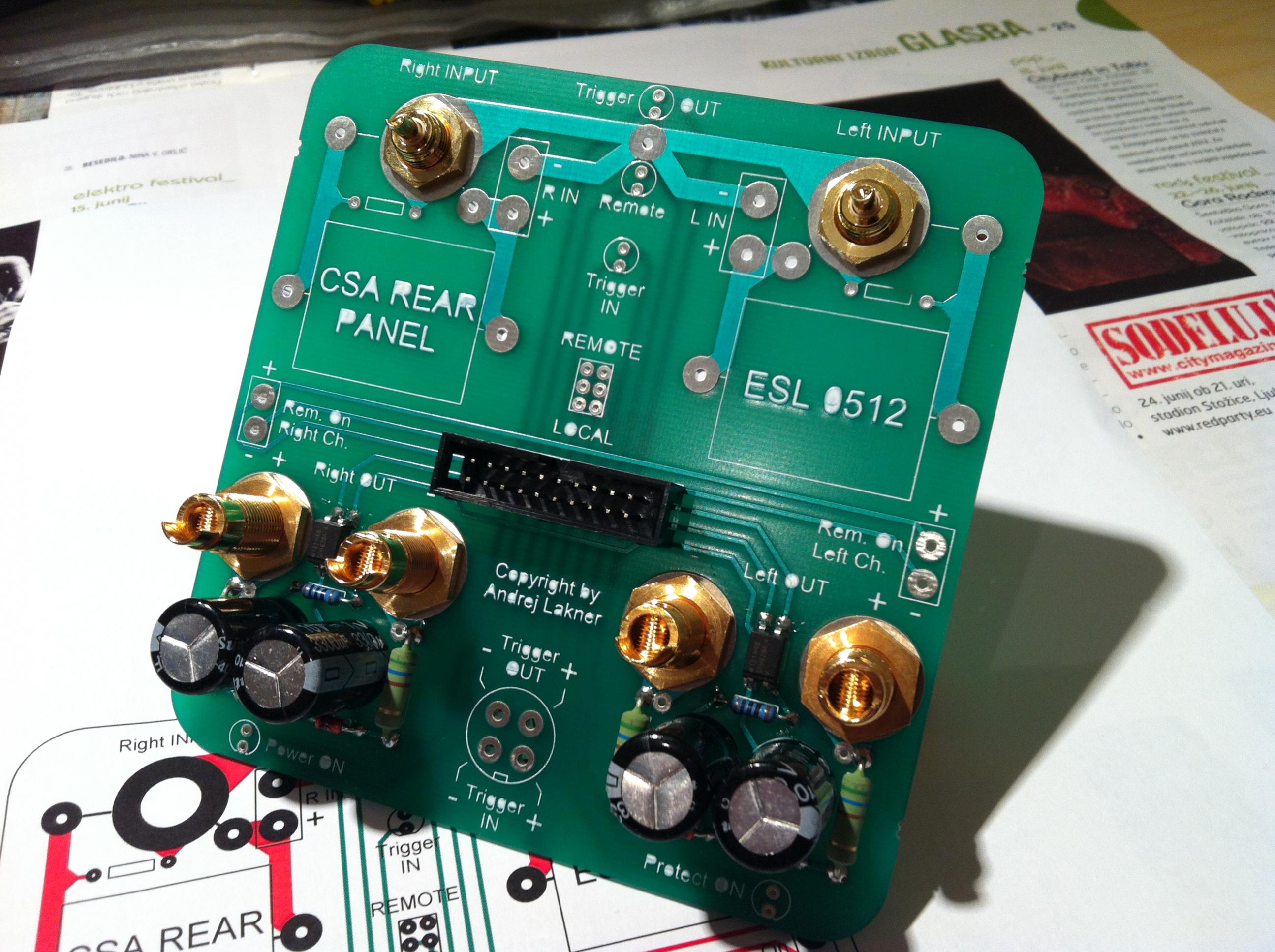

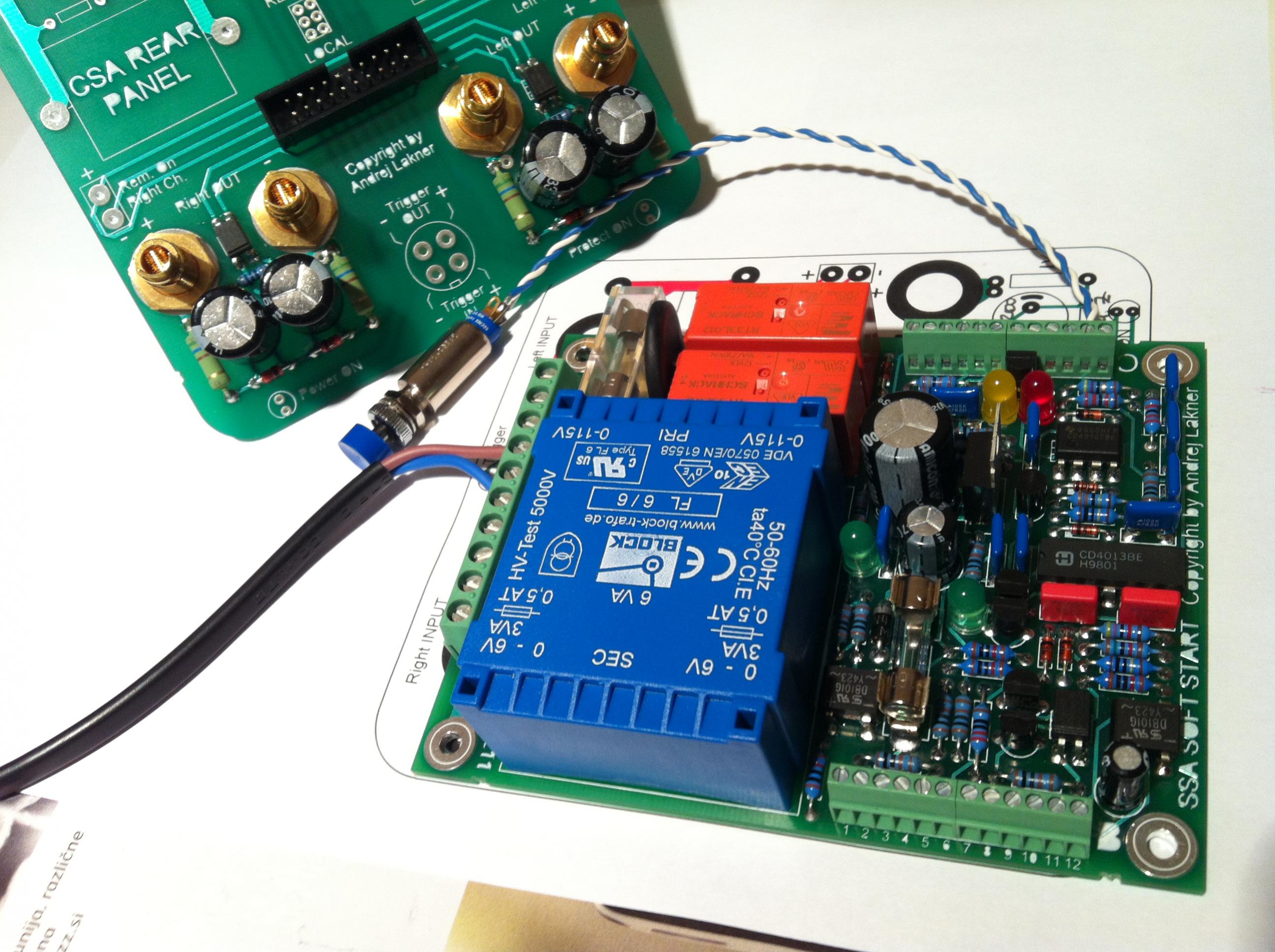

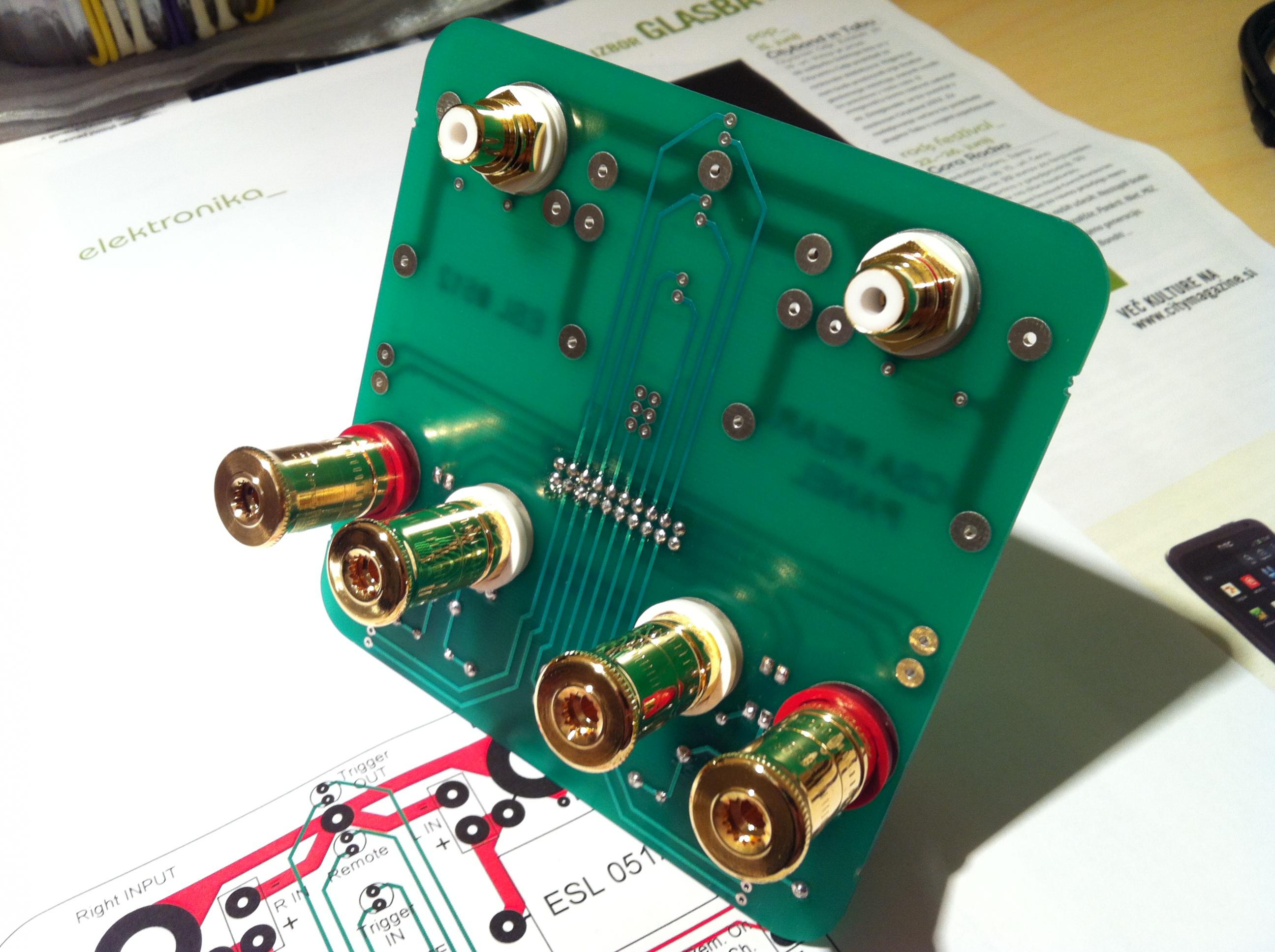

PCB-s for my new CSA amplifier, soft start & utility PCB, plus rear panel utility PCB already assembled. CSA channels PCB-s will go into production this week after extensive check-ups made, so all together four PCB-s and two toroidal transformers as a separate parts form new CSA amplifier. Rear panel connections in a previous, sold SSA, simply took too much time for all the wiring necessary. New PCB will make things much easier now ... 🙂

New CSA PCB has 28 transistors (bipolar, fet, mosfet), 7 TL zeners, separate power supplies for input and output, elcos in feedback GND connection, which can be disabled if prefered. All functional parts of each stage were tested separately and will be tested together at the first channel assembly in seeking to find optimum current-components values for complete front end. I will start with CCS-s, input stage, VAS and finally all together as voltage amplifier. Front end itself counts 22 transistors and 7 TL zeners which clearly indicates complexity but also opportunity to squeeze out maximum performance from all the stages. I am quite sure to know what am I looking for so the goal is well defined, the path to get there will be something like action road movie. 😀
