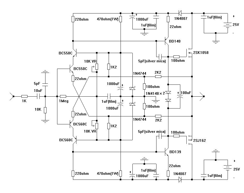

Hehehe nobody likes high distortion especially when it is third order. The only objection I have with this circuit is the relatively higher 3rd order distortion as compared to 2nd order. I would prefer higher overall distortion but from 2nd order.
You didn't do something wrong I believe. Here is a trick:
The FB resistor (1K) is connecting the input transistor's emitor and the output.
You want the input transistor to have Vbe of at least 0.6v (approximation). Base voltage (Vb) is assumed zero and so is output voltage (Vout). So to get 0.6v at the emitters (Ve) you want a certain current thru the FB resistors (This is what the CCS is for).
V = 0.6V
R = 1K
I = calculate! ---> 0.6mA.
CCS current == current thru FB resistor + current thru transistor
Note that the current thru the transistor is also affected by the collector resistor (1K here, which is a good value). This current is around 0.5mA. So more or less you want the CCS to give out 0.6mA+0.5mA = 1.1mA.
You may want to set both CCS to output 1.2mA. You will find that the higher the current, the lower the distortion. That's why you got ("too") low distortion when you use higher zener voltage which affect the base voltage of the CCS, giving very high current I believe.
But I suspected that it would be better (e.g. for the stability) if top CCS gives different current than the bottom CCS. With positive voltage at the output you want the top CCS to have slightly higher current. You can try 1.2mA for the top and 1.1mA for the bottom CCS.
That's just my guesswork, you will have to troubleshoot the correct setting after you build it (if you intent to). In Christophe's circuit, top CCS has 3K3 and bottom CCS has 3K32. This means that the top CCS has slightly more current (I guess). But unfortunately the base voltage of the ccs also determines the current. I guess that you need to work out the 3K3 resistors on the CCS and the 30R resistor at the base of the VAS transistor.
You owe to yourself to build any of the SSA amp. Better is the more complex one.

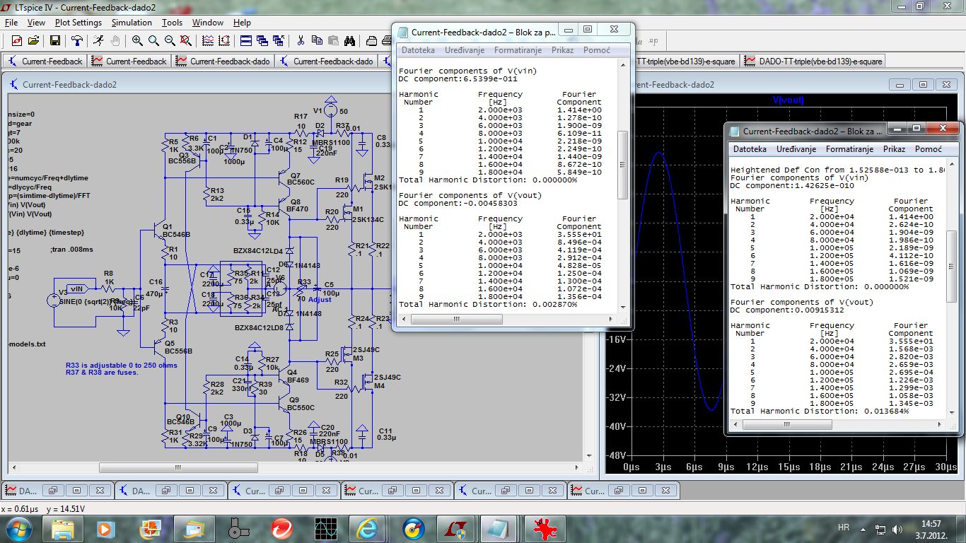

I know how to change those things. Problem is that I whanted to repeat Esperado's simulation, and my result are catastrochic(with 3.9V of a voltage source instead of 3.9V zener). Bandwidth is up to 14kHz and distortion is terible.
What should be the VAS current? It seams that with your suggested CCS current, it is to low for my liking(1-2mA). JLH used 10mA in his 80W MOSFET where VAS drives laterals directly.

By the way, the most elegant way to set CCS current is changing D1 and D3. In this case the cascode voltage is changed in the same time, and in this case is incremented for better work of Q7 and Q9. With a zener of 5.6V CCS current is set to 1.5mA and VAS current to 14mA. Phase marigin was not changed(47degree). Distortion drops even more.

The CCS is for the front end, not VAS. You have to pay attention to the operation of the input transistors. But you're right, that the VAS current is too low (tho it is not the determinant factor) and I don't like most circuit where output is driven by VAS. That's one reason why I have never built this circuit (all components, parts, everything is already prepared, just need soldering).

Yes CCS is for front end, but changing the CCS current the VAS current was changed too.
Of course since the CCS current set the lower VAS transistor base voltage.
Technically it doesn't have to be like that. There are many things that affect VAS current, independent of the CCS current to bias the front-end transistor.
Increasing the FB resistors (e.g doubling the resistance with 2K||75R) will also solve the issue.
But all of these will put the circuit in worse stability. This is probably the reason why this topology is not popular, despite its good sound character.

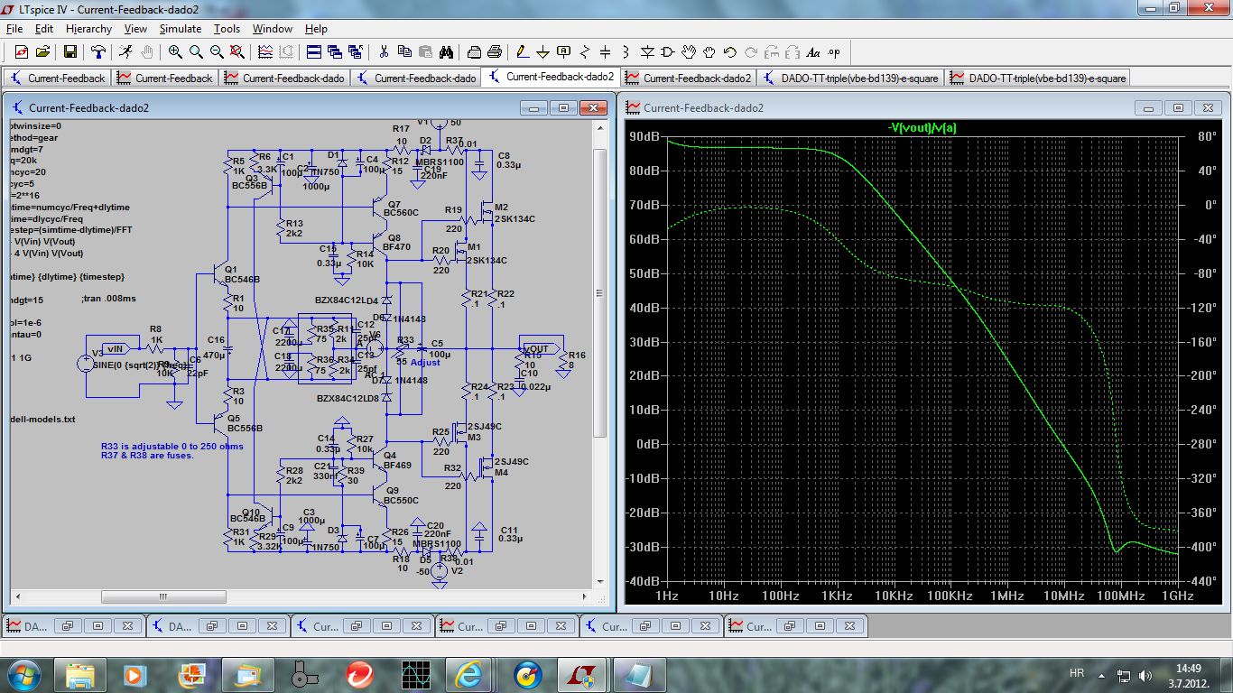

Here is my simulation. I set for 14mA of the VAS current, incremented feedback resistors and it looks that is now more stable with Phase Marin of 60degree and Gain Margin of 20dB.
Decreased power voltage from +-70V to +-50V, I think that two pairs of those lateral are not enough if a load drops to low and +-70V is to much for this amp.

I am old shool too(retired telecomunitation engineer) and Spice simulator is great tool, so I am trying to lern it now.
Simulation with your lateral transistor models shows low distortion too(when I changed CCS zener from 3.9V to 4.7V) but with wrong resistors values. One of them is R33 8ohm resitor, and with 1.13mA of the VAS current produces 138mA per output transistor pair. This impossible in real world, so the models are wrong.

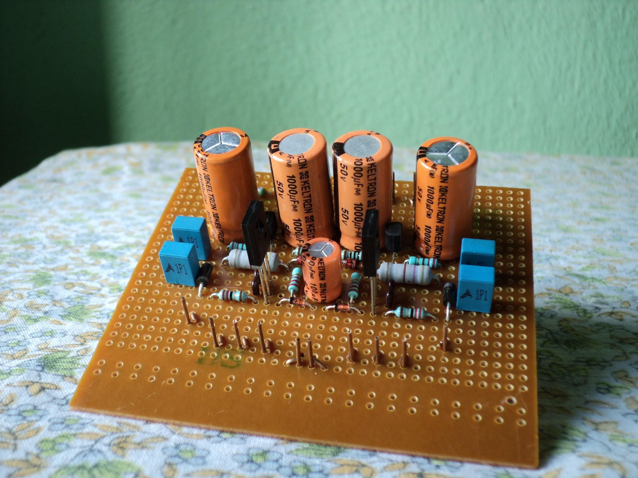

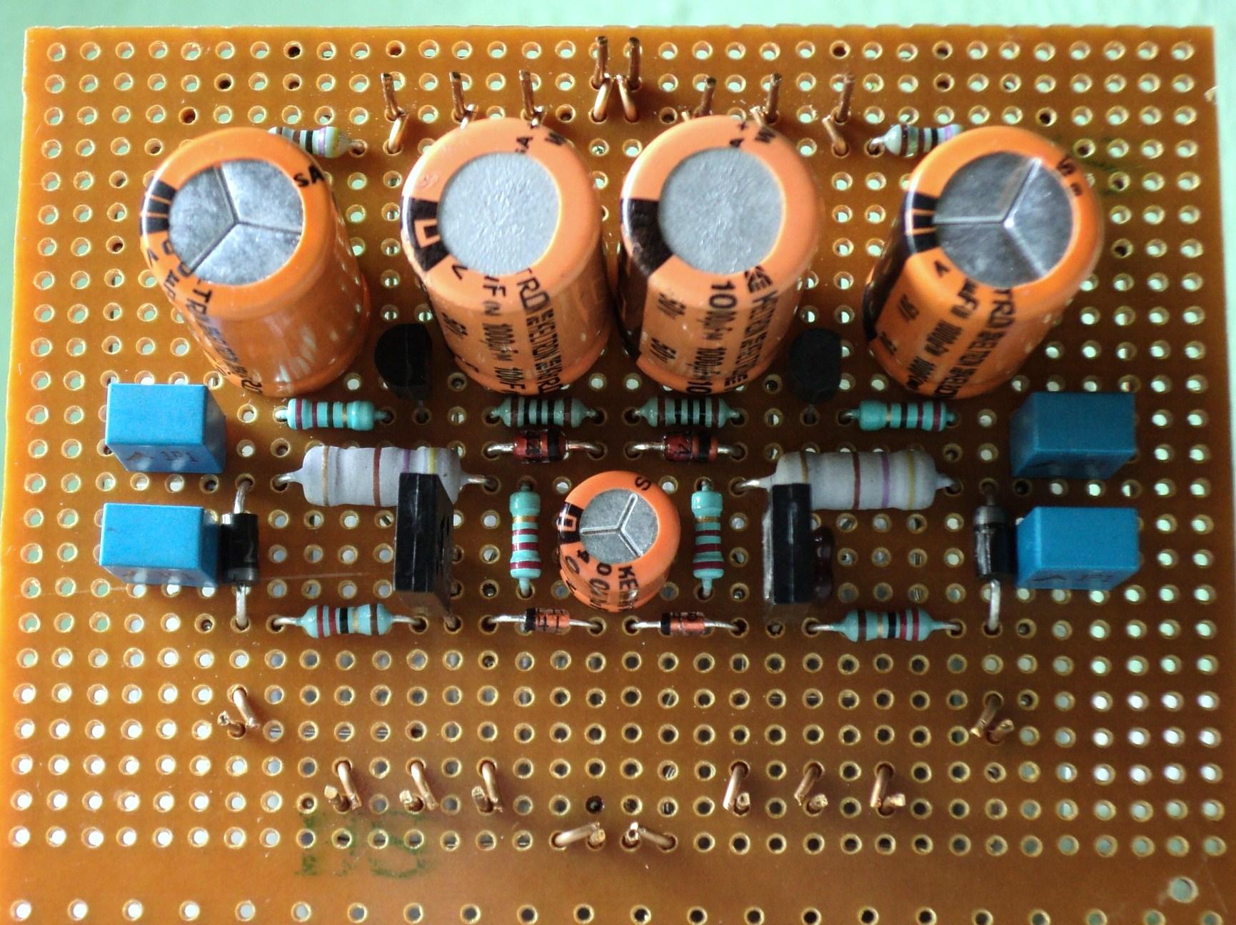

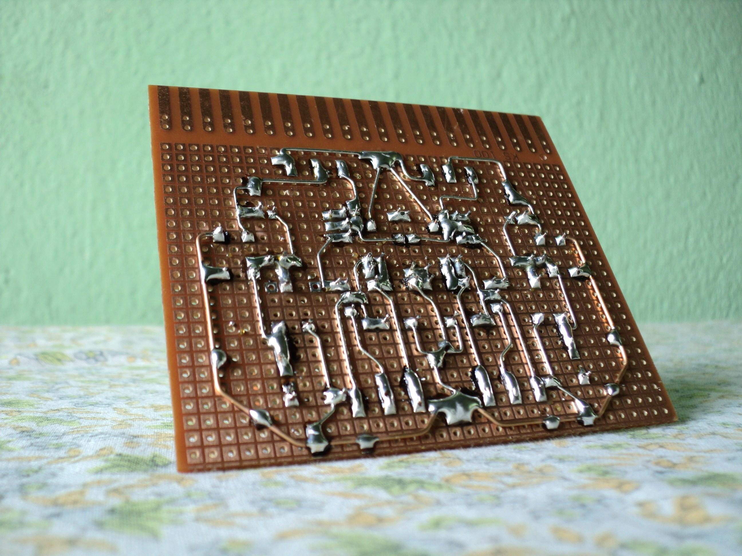

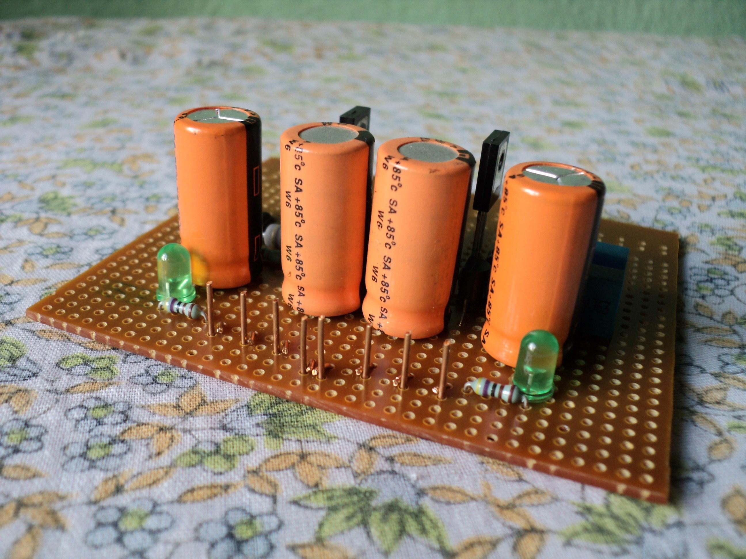

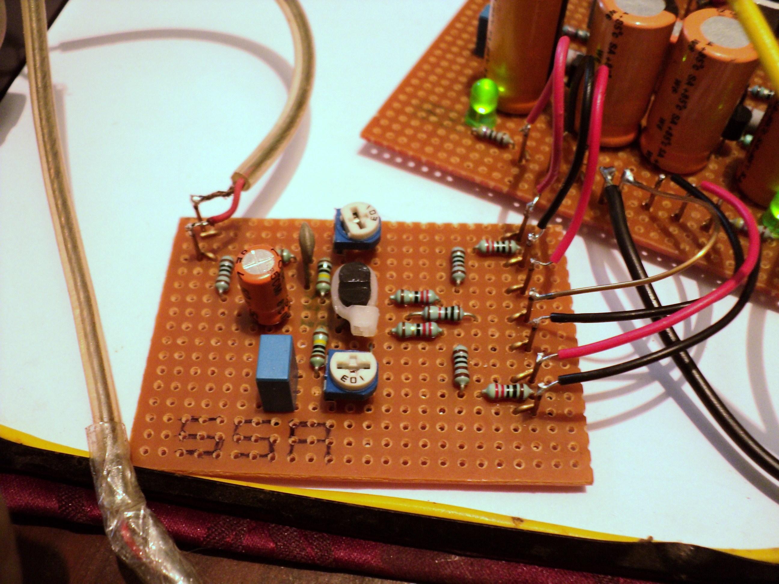

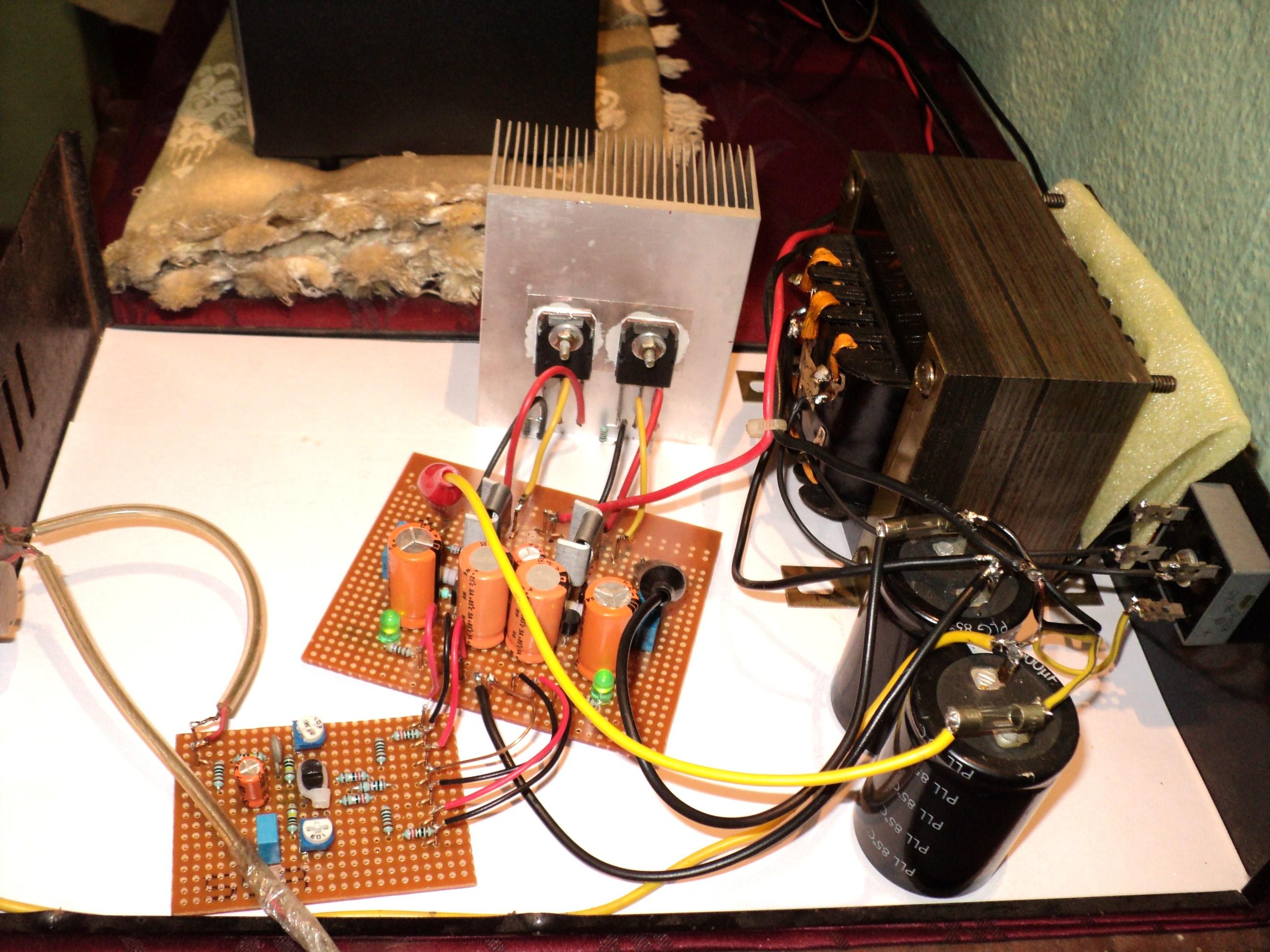

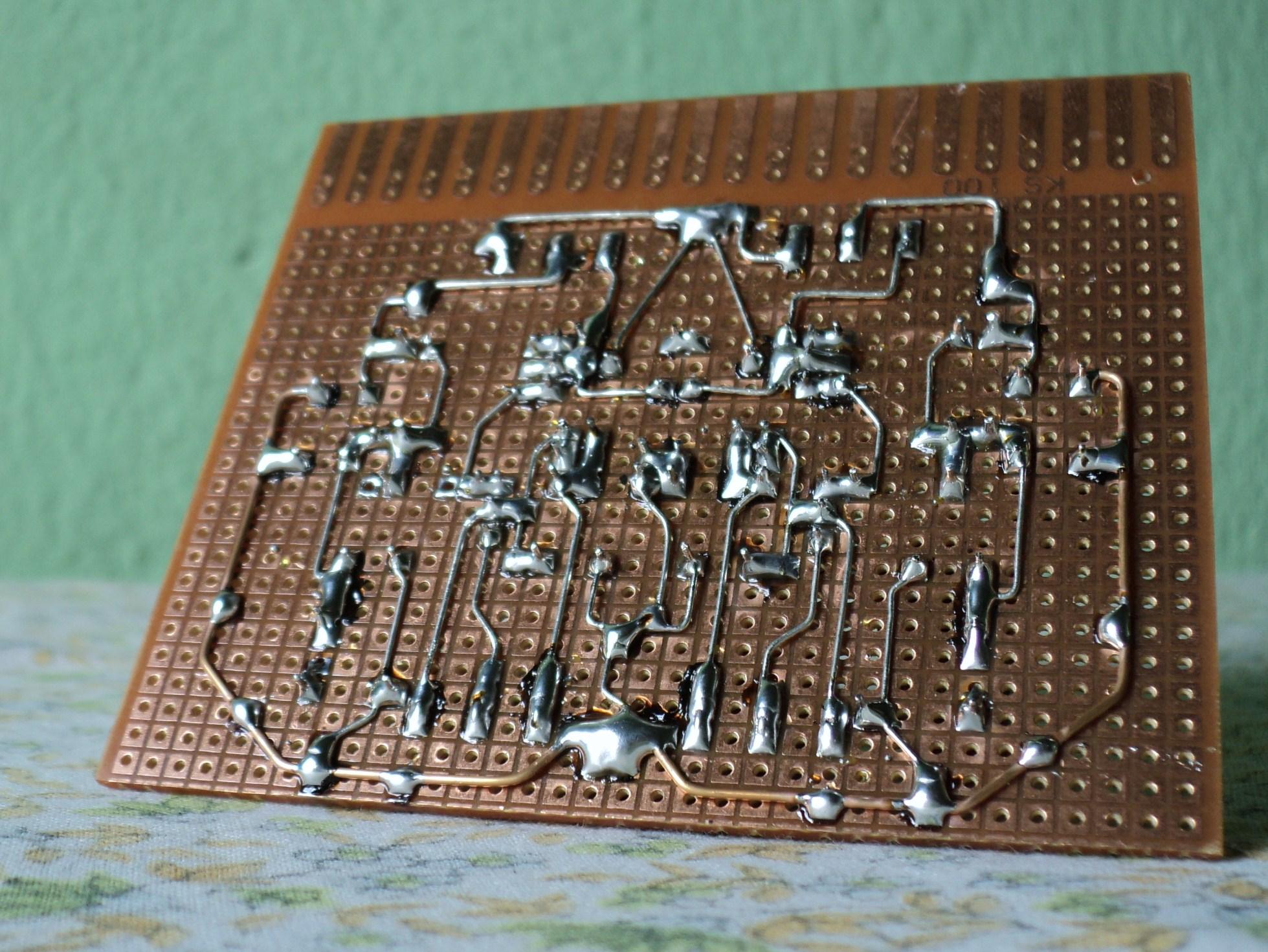

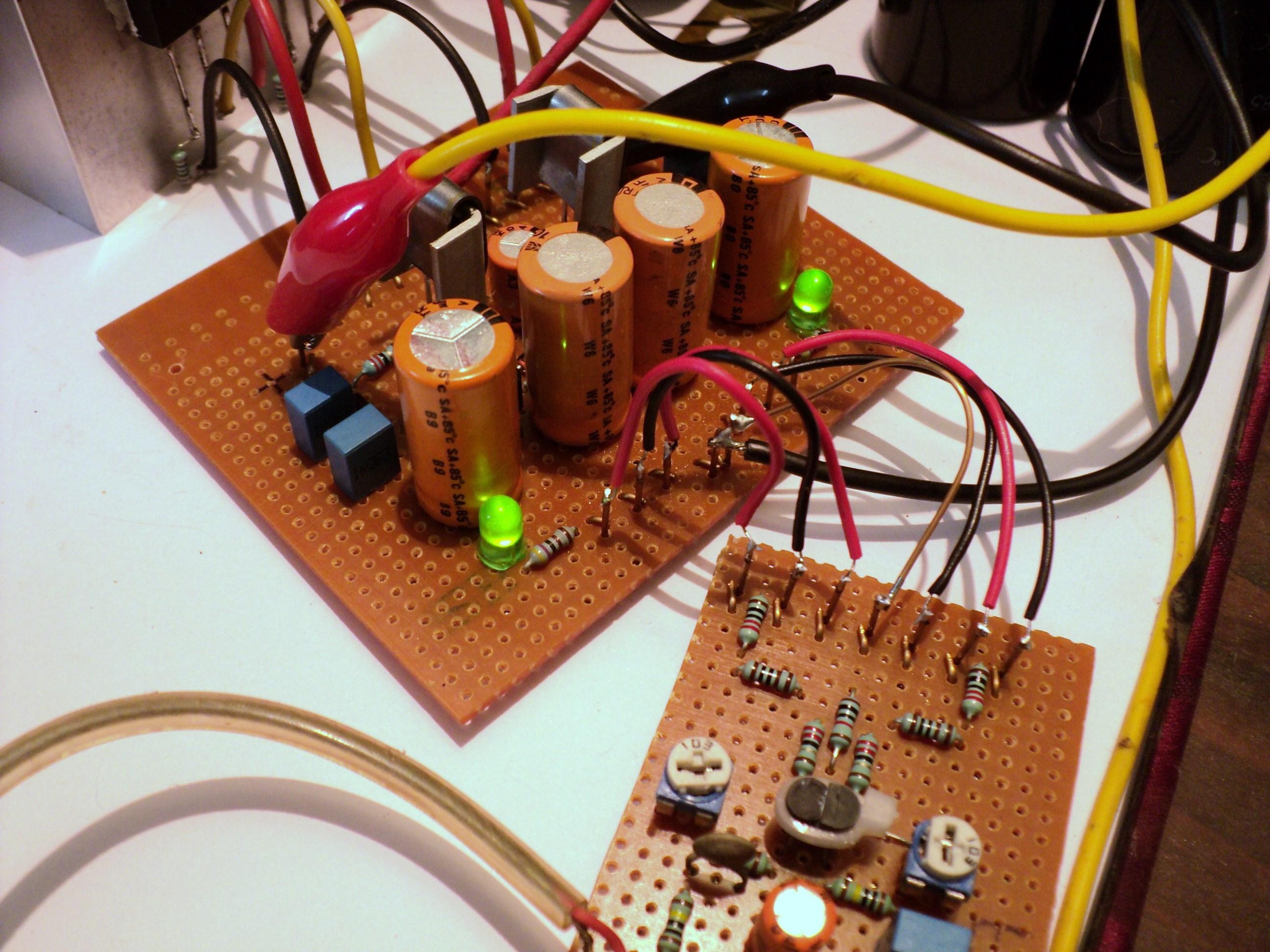

I'm here to share the story of my re-incarnated SSA which I built a week ago.
As the pictures show I built the front end and the VAS+cascode on different boards and interconnected them with 7 wires. BC550C/560C as input, same as cascodes, BD139/140 regulars as VAS, 1N4148s for bias setting and 1058/162 Laterals as outputs. The diodes set the bias to a nice 150mA through the FETs with +-25VDC supply. Total Iq is 180mA. 5pF silver mica caps as bandlimiters in the VAS and 5.6pF(Old Philips ceramic) as input RF filter. Offset control with two 10K small pots from +-15V zeners, filtered with 1uF siemens MKT. Power to the VAS and the front end is supplied through two 1N4007s with 1uF before them and 1uF+1000uF after. 100ohm gate stoppers and no Zobel at the output.
The amplifier worked like a charm the very first time it was turned on and after setting the offset I was listening to music within 5 minutes of the first run.
No hum, No noise, No offset problem, No overheating, No bias drifting, No nothing!!!!! What is this amplifier!?
