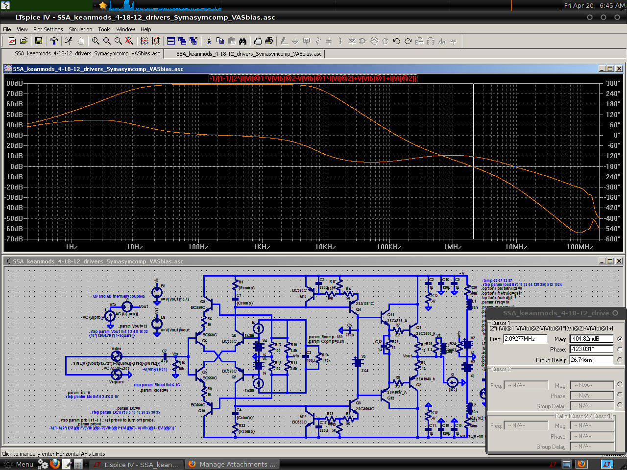

I'm guessing Q10 and Q9 are what you're calling "emitter cascodes". I see them as an NTP for "no-tail pair". Or, Rush Cascode. I think calling them a cascode misses the point though. In this design they are very aptly described as "feedback buffers". That is their main purpose. They keep from injecting VAS drive into the feedback loop. However this is only mostly achieved as the Vbe variations have the same effect. Perhaps the circuit could be faster if I got rid of the feedback buffers and lowered compensation, after all the VAS has been improved.
This VAS mod is interesting... I could decrease the input stage current way down and give the amp a very large input impedance, as the input bias current would be very small. Maybe it could be a HF electrometer if I used a buffered VAS...
The only problem with the above circuit is that it must be AC coupled.

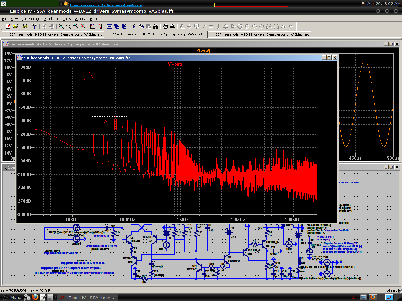

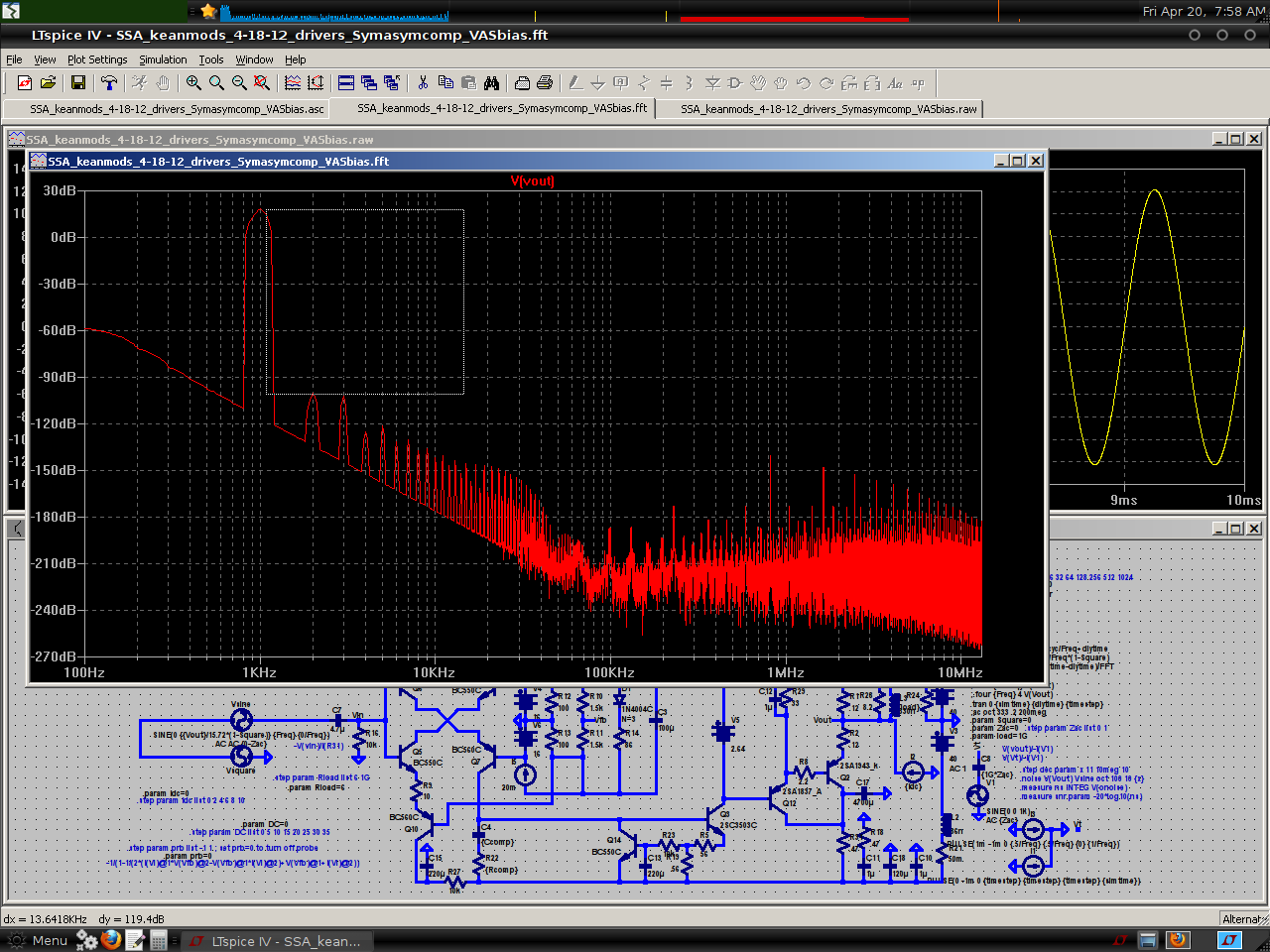

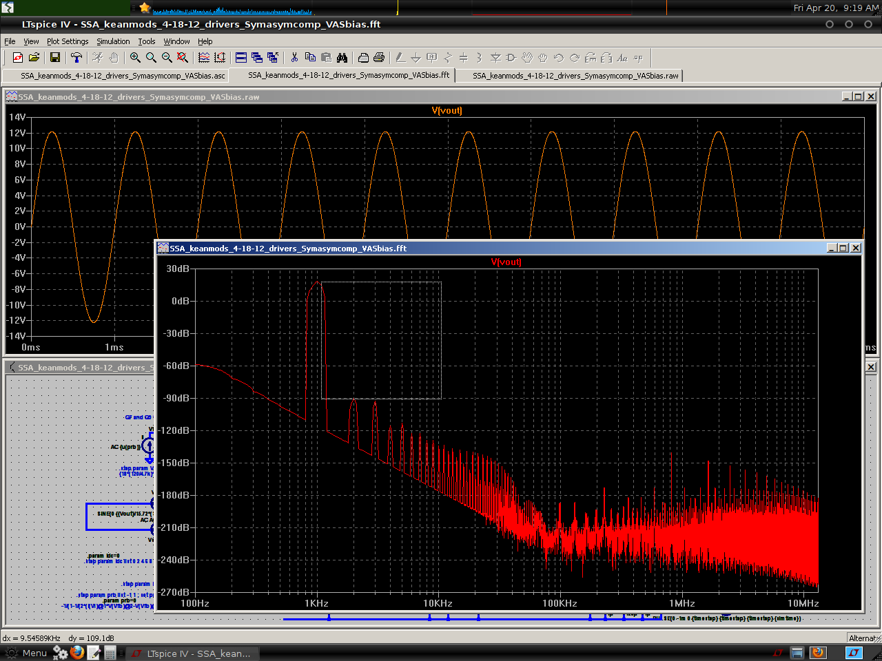

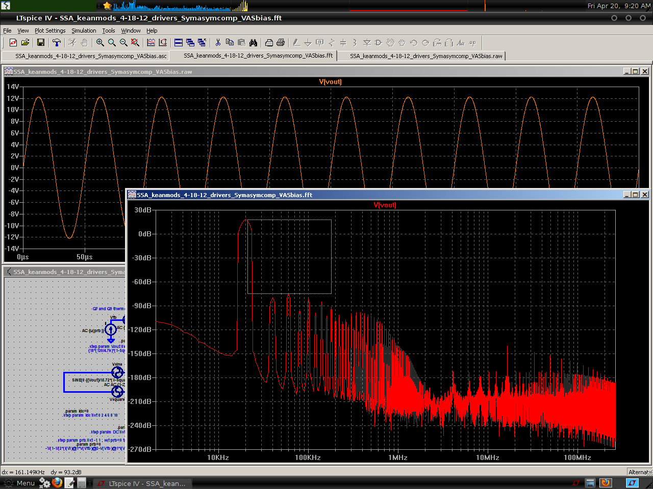

Didn't catch you. Here is the FFT, since DC drift overwhelms LTspice's .four calculation at these levels. Taken at 1k and 20k.
All tests are made at 12V into 6R.
Without feedback buffers...
Also notice the input and output stage RCs which each reduce distortion be a few dBs.

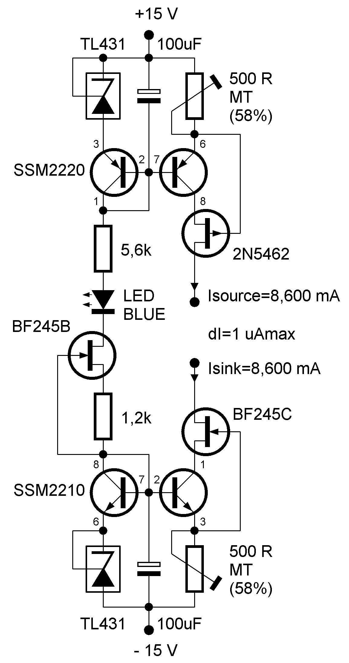

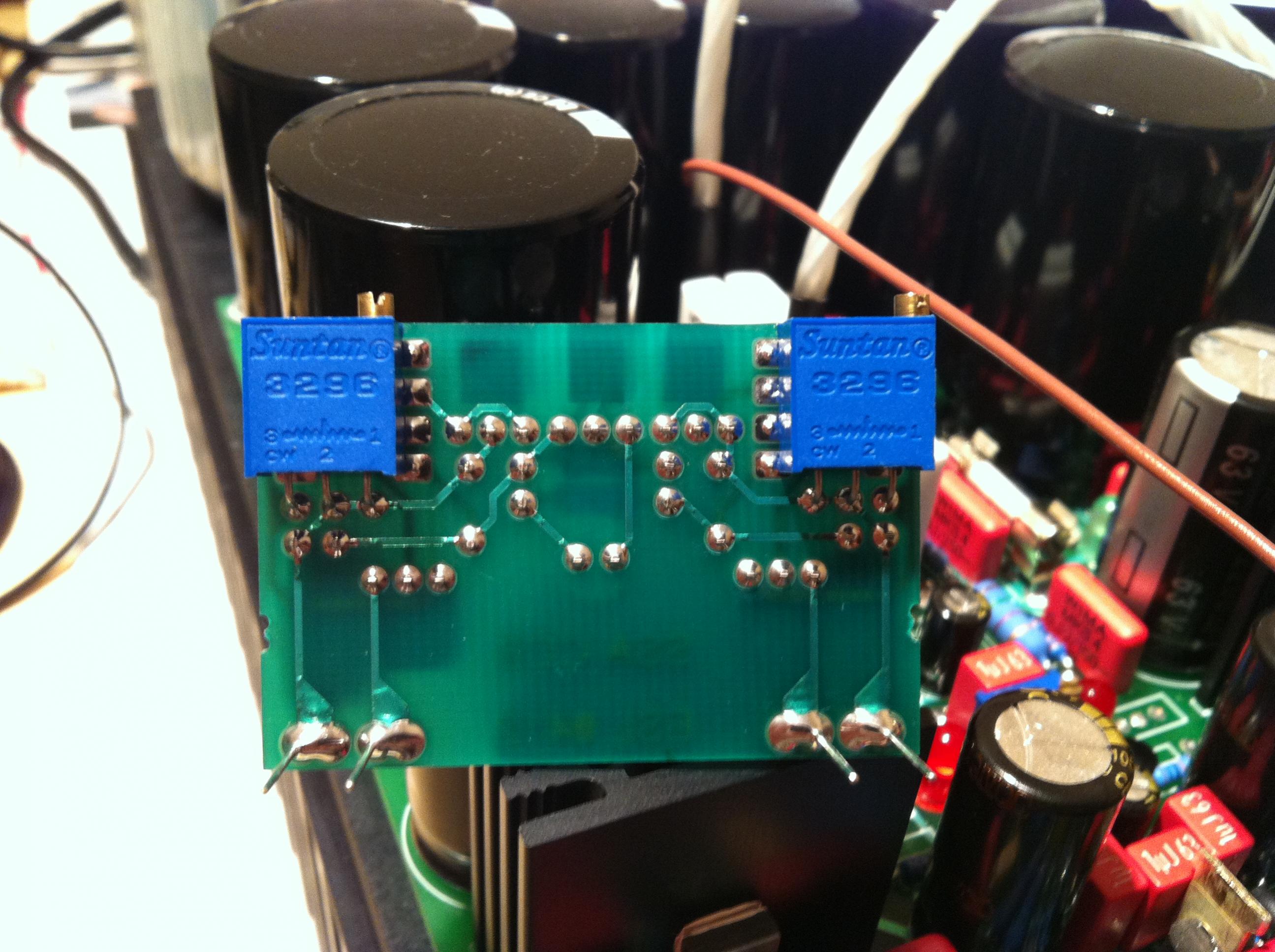

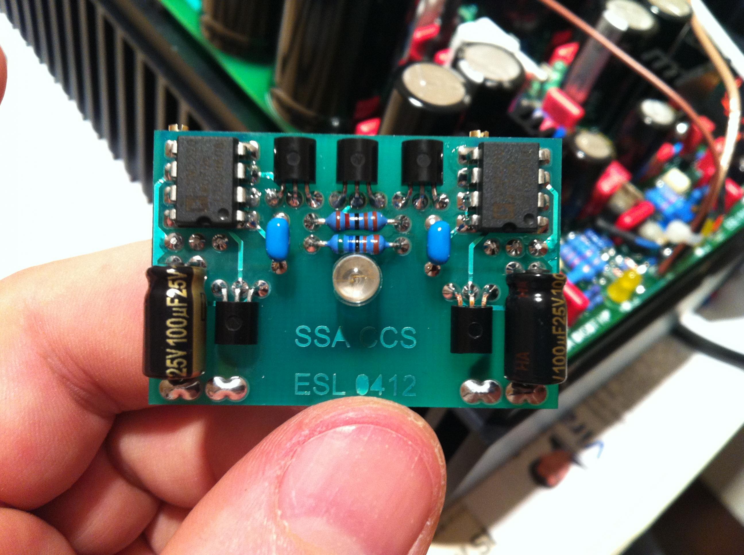

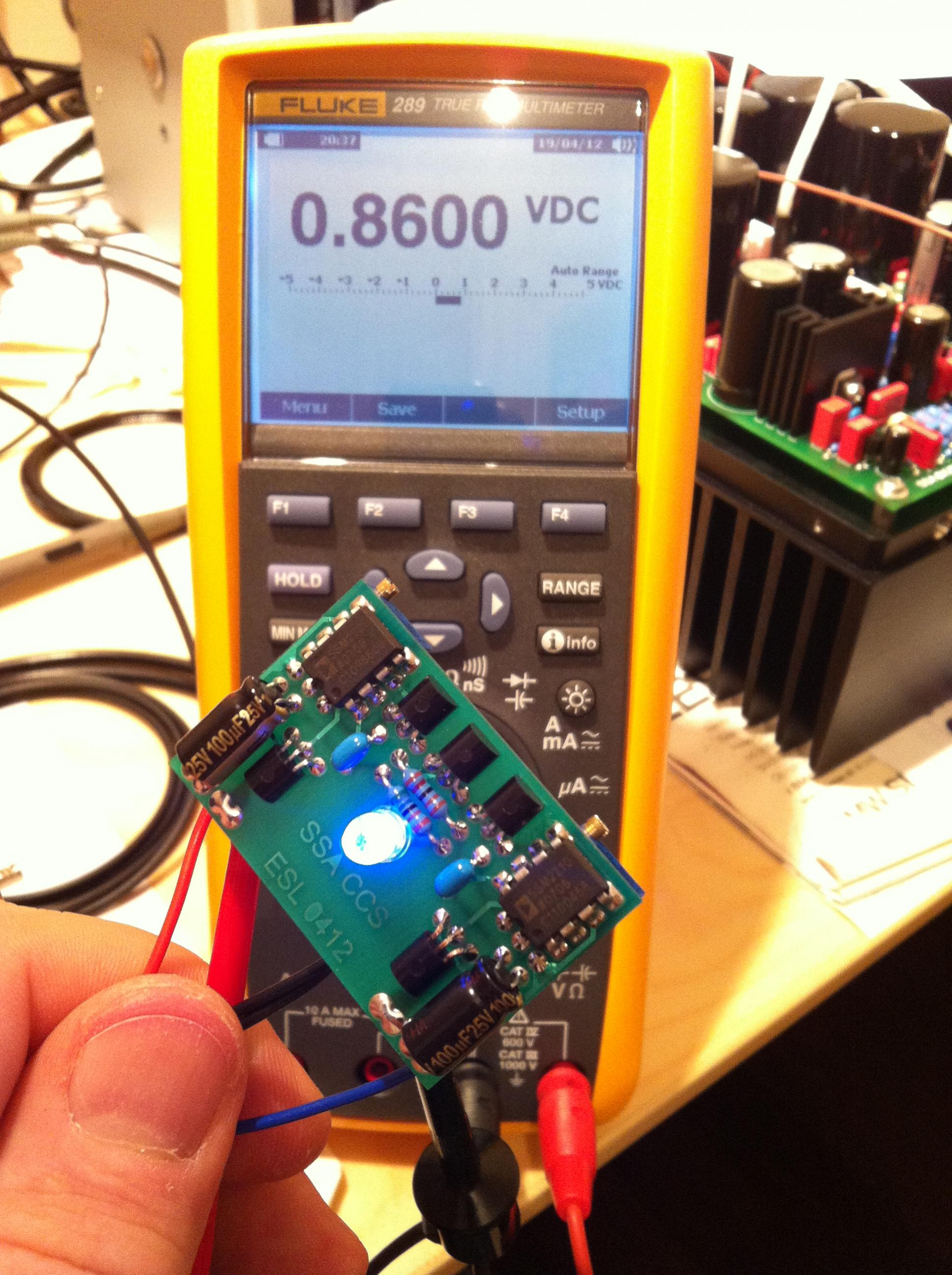

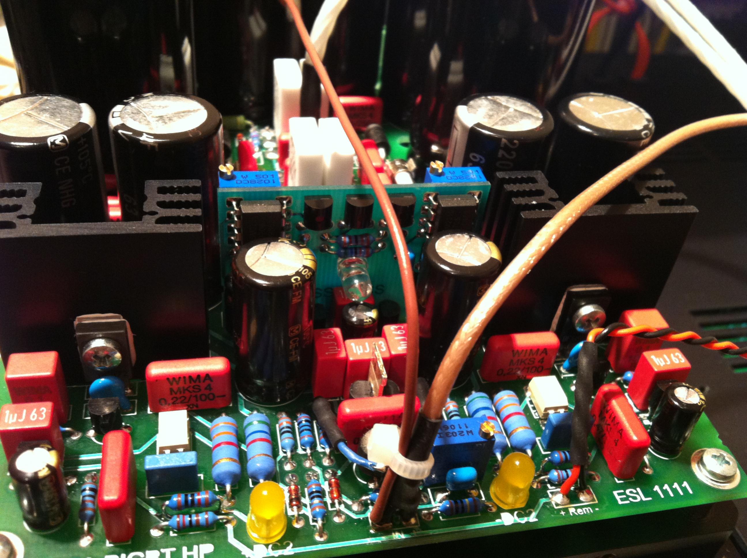

Today's playing in the workshop :cubist:
8,600 mA exactly (0,8600 V/100 ohm) :magnify: no joking around :whip:
