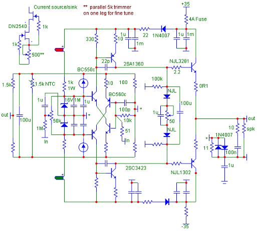

Housekeeping added. Next step is mount to regular heatsink, test, then second channel:

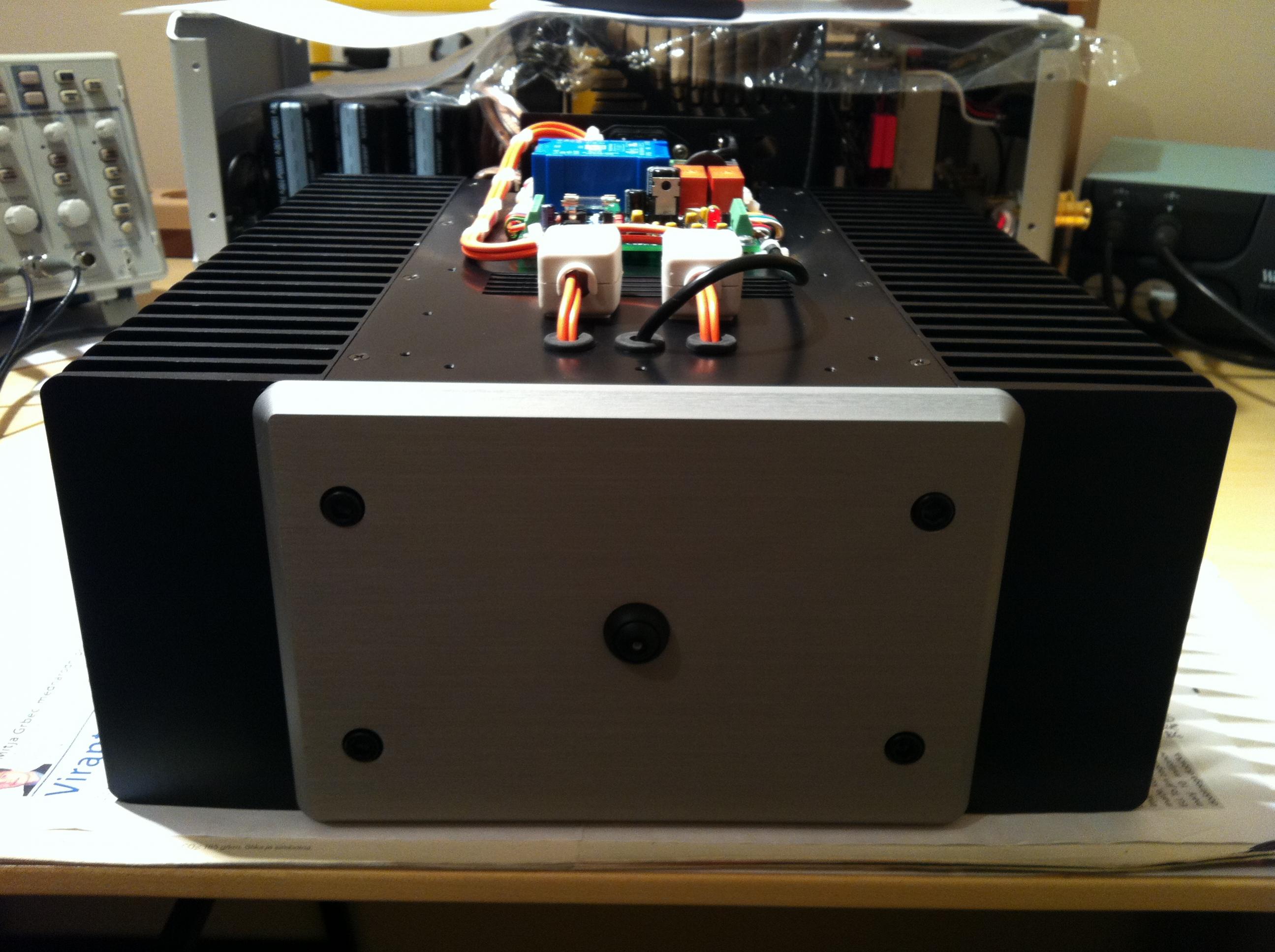

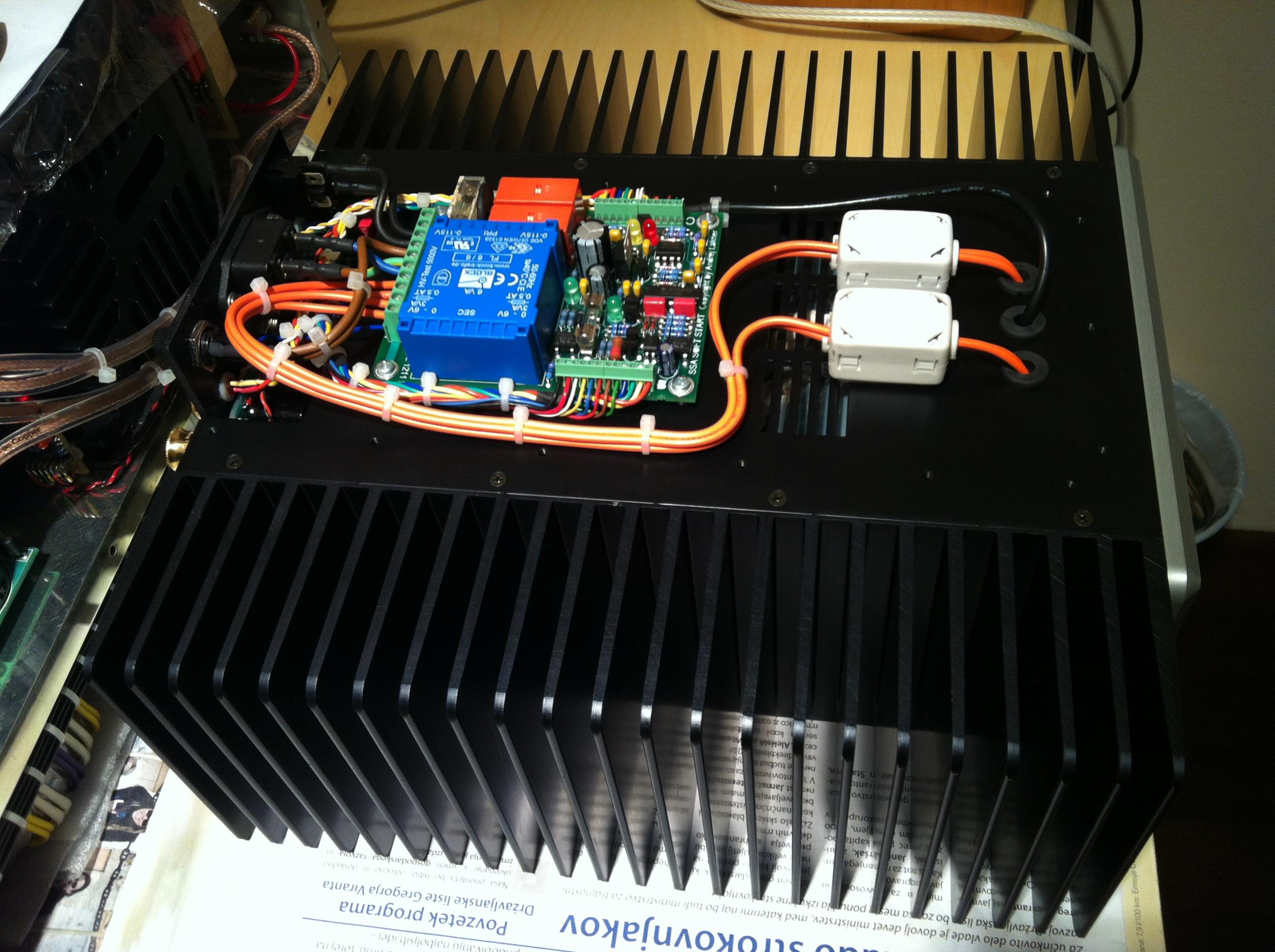

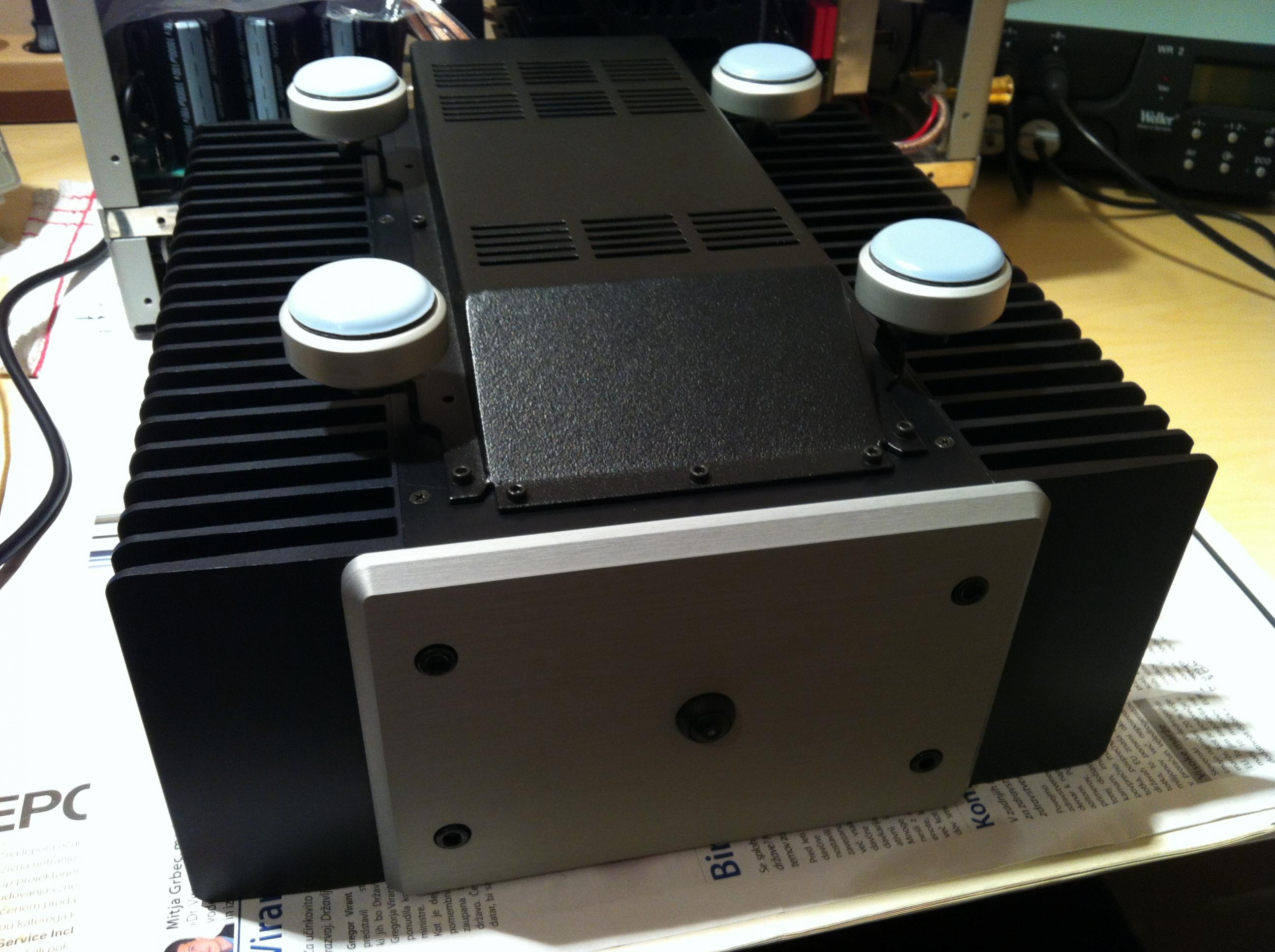

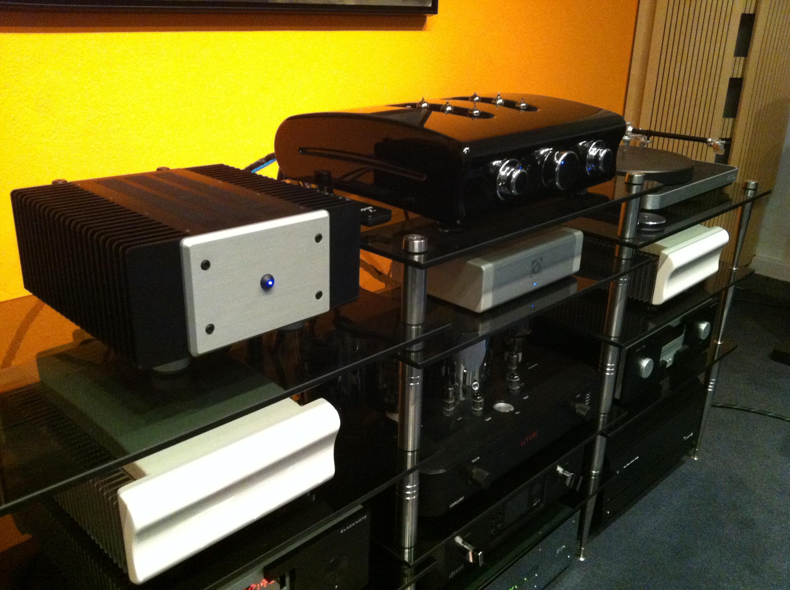

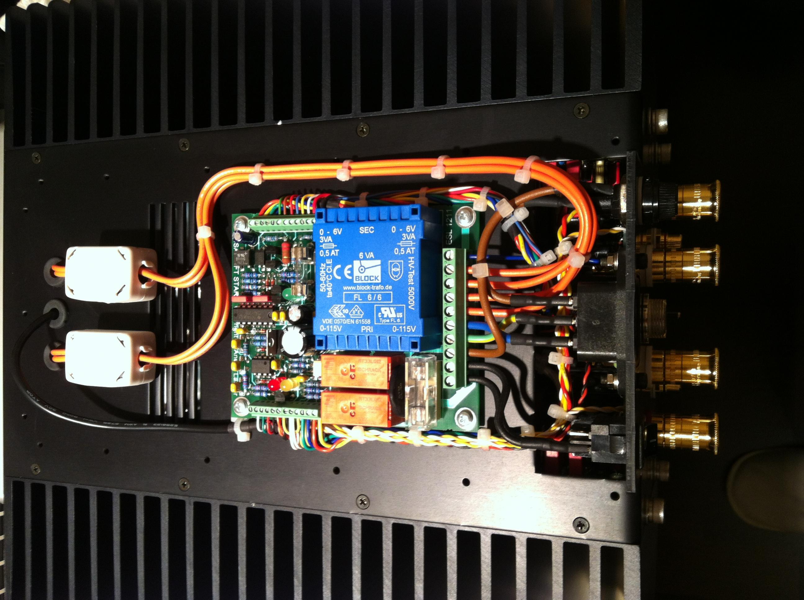

SSA BIGBT HP finished amplifier
I started this thread 9 months ago (how symbolic), continuing from here and today I finally made an amplifier that is finished, tested and auditioned to my friends.
It was a big pleasure making SSA BIGBT HP, learning process all the way, meeting new friends on the forum and continuing to develop new amps in TSSA thread.
Some pics from today's assembly and later music session in a system consisting of Clearaudio Ovation, MC Cartridge Stradivari V2, Nano Phono Preamp, Absoluta Talia stereo preamplifier, Magico V3 speakers, Ktema speakers.
Regards, Andrej 😉

BTW my latest iteration above, mounted on a proper heat sink is thermally well behaved. Driver bias goes quickly to 9.5mA, then over several seconds to about 11mA. Over the next few minutes it hits a maximum of about 12mA, then settles over the next few minutes back to about 11mA where it stays. DC offset changes a maximum of +/- 15mA, and settles within +/- 10mA. All quite acceptable.
Next is channel two, then plug it into the main system for a listen. Will probably take me a few weeks, between other things.

Thanks Sheldon 🙂
You see, SSA beast can be thermally tamed, now it's like a pat. :whip:
DC offset is OK, no need for servo at all. :up:
Just take it slowly, in that way you have firm control, plus no stress. 😎
