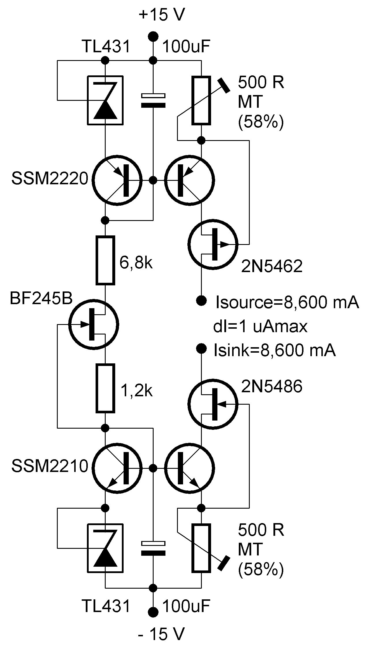

Since I was not pleased with thermal stability of this one, I tested improved CCS today. It looks that this one is going to end in SSA BIGBT HP. 😉
Specifications are quite impressive for home DIY conditions, especially DC stability, load current regulation (1 uAmax/25°C), thermal current drift dependency (5 uAmax/25-75°C). AC performance also get a little better from previous version, noise floor is still well below -100 dB, but signal rejection ratio went down to -84 dB/100 kHz/100 ohm (8 Vpp 100 kHz sine signal according to 0,5 mVpp ripple on 100 ohm load resistor). 😱
This one is confirmed, finally. 🙂

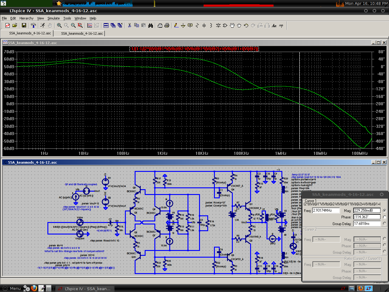

I was curious about an idea I had so I made a simulation based on the most recent reasonable schematic I could find in post 2383. I thought I would share. With some drivers for the outputs I think the GBWP could be increased. The open-loop gain is plotted without a resistive load. This was just for fun, I did not worry about thermal stability, so it needs thermal compensation before it could be built (probably facilitated by a CCS tempco).

3 MHz/-3db CLG is a real world repeatative result in many measurements I performed.
Did you find Q9, Q10 feedback buffers to be as improvement here, cause feedback loop is low impedance anyway. R19, R25 are also not necessary to my opinion and yes drivers makes a difference also. Not to mention VAS cascodes ... 😀
P.S. Are Ccomp+R better performer here than usual Miller cap compensation?
I copied the schematic as quick as I could, I could have left out those resistors including R14 but it didn't concern me.
The feedback network may have low impedance but it got eaten up quickly with the output stage capacitances. The Cjc of the cascodes and of the outputs are the biggest limits of my schematic.
I've found that RC shunt compensation like this does a much better job at stabilizing the amp, not just this one but most amps I've simulated. This is because Shunt compensation absorbs HF energy (like a snubber), not just relocating it, potentially creating pole-mania. If you look at Miller comp and take the VAS away, you can see the miller cap injects positive feedback into the output stage. If the VAS and OPS were perfect this would not be a problem, but it is. You can exaggerate the effect if you degenerate the VAS heavily. Shunt compensation loads the input stage less at HF and is therefore also more immune to RFI. Miller compensation as it is usually applied to the VAS also decreases PSRR; Shunt compensation usually avoids this problem.
But there are some good reasons this type of compensation is not used often. #1, most people don't understand it and it's more tedious to adjust than Miller compensation. #2, it causes more distortion. With high-impedance loads it actually distorts less than Miller, but with speaker loads it distorts more. #3, Miller compensation gives the appearance of making a faster amp. In the simulator AC Analysis it looks like it but we already know Miller compensation can have trouble with RFI, and the input stage will saturate with any significant signal at those frequencies. #4, a gain hump near the -3db point is an unfortunate side-effect of shunt compensation. This is not ringing, just a hump, and it will show up as overshoot on the square wave test with it's own unique shape.
VAS shunt compensation has many practical benefits, but it's a bummer to the distortion specs. It works great but it's an "ugly duckling". Even so, I prefer it sonically over Miller compensation. It seems to have more realism, better voice legibility, and more soundstage depth. Go ahead and try it.
If you want to see a hidden example of shunt compensation, look at Symasym.

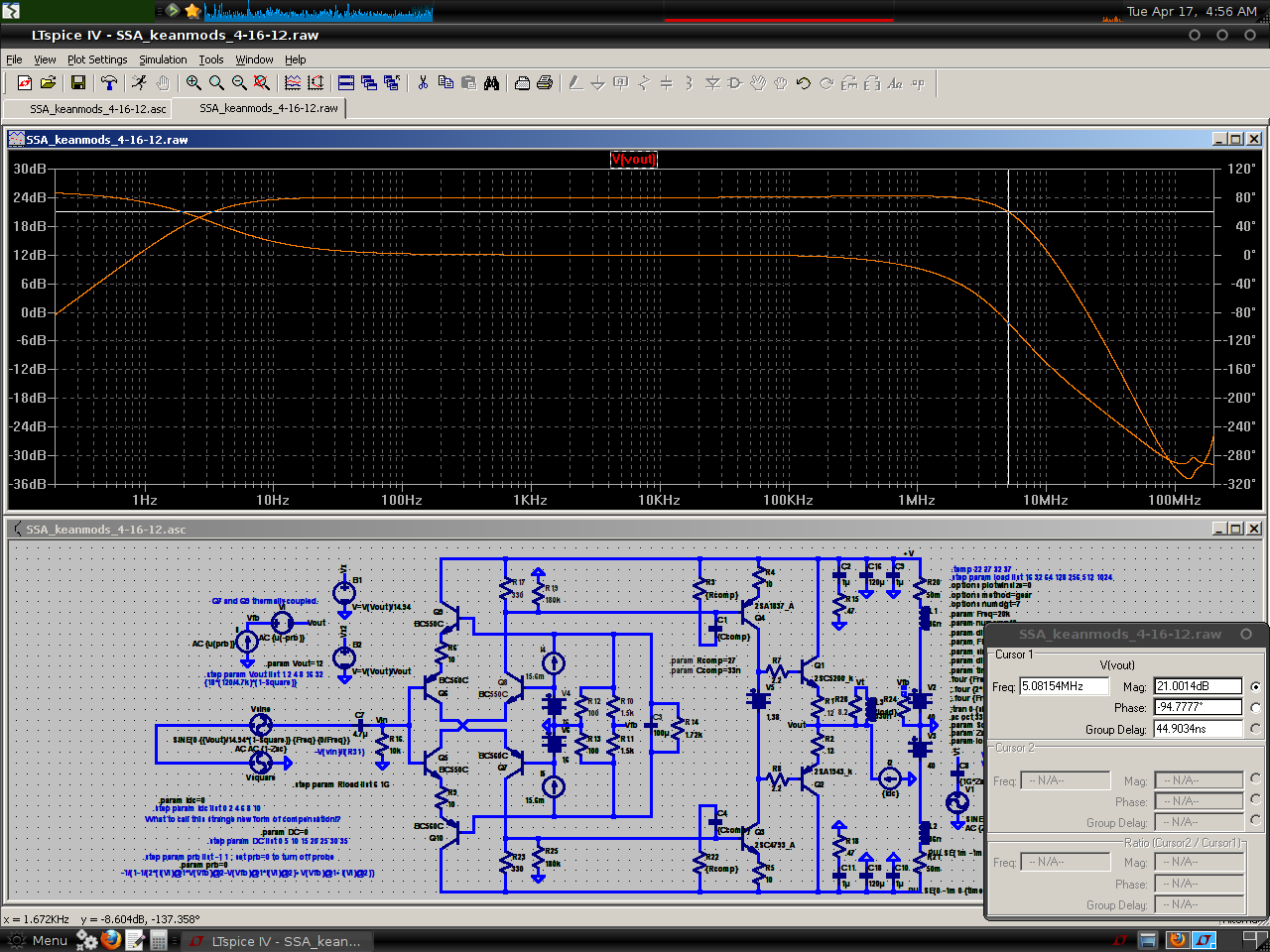

Attached is the simulated response of my circuit. Again without load. A load changes things significantly here, because the lack of buffering of the output stage. Still, it's an indicator of what can be achieved.
PS. The PSRR caveat with Miller comp could be solved by running the Miller caps to the IPS cascode emitters rather than the VAS bases. It is risky but it could perhaps be made to work.

Yes I know about this kind of serial RC compensation at input nod of the VAS. I used it already in my amps before and at a start I always put both R&C as trimmers, find the best spot in between lower and upper frequency oscillation, measure the values and solder fixed values RC parts on PCB. This kind of calibration is always fun and very acurate job, no problem to find optimum trimmers positions. 🙂
But you said that distortions are higher by this type of compensation, how much higher is that going to be? 🙄
Very nice response for both gain and phase shift, good enough for you to make it in real someday hehe
Will try it next time, thanks for the tip, regards Andrej 😉

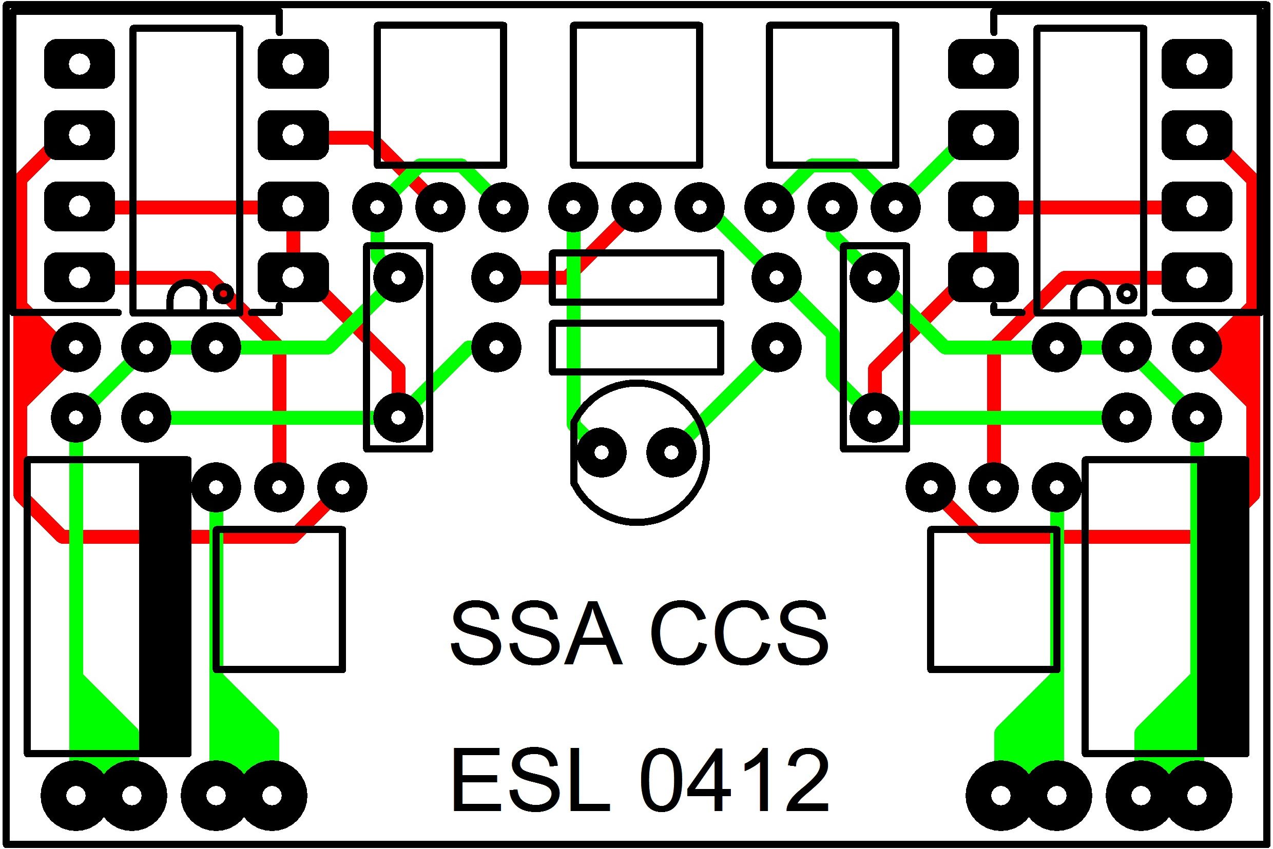

LazyCat, any progress with GB for boards? 🙂
Hi igor0203 😉
Well the amp is fully functional, playing music nicely, but it is still in R&D phase, so some more improvements will be tested before to go to conclusion of the project and say, this is the final SSA version.
What's happening now is an upgrade for CCS current injectors to SSA feedback bridge, since it was realized that the distortion spectrum is much more clearer with the use of high performance CCSs. And these are ready to build and installed into the amps. Both positive and negative CCSs are located on PCB size 30 x 45 mm (attached) and will be soldered to main PCB as add-on module. Will look quite professionally I tell you. 😉
At 10KHz, which I think is a frequency representing compensation quality, distortion increases from .031% to .064%. I don't know whether output drivers will bring these figures closer. Distortion at 1KHz changes only barely from .0305 to .31. This is at 12V into 6R.
That sounds good to me, but right now I am invested in my own design.
I found 100R resistors in series with each Miller cap damped a resonance around 50MHz; could be much worse in real life.
