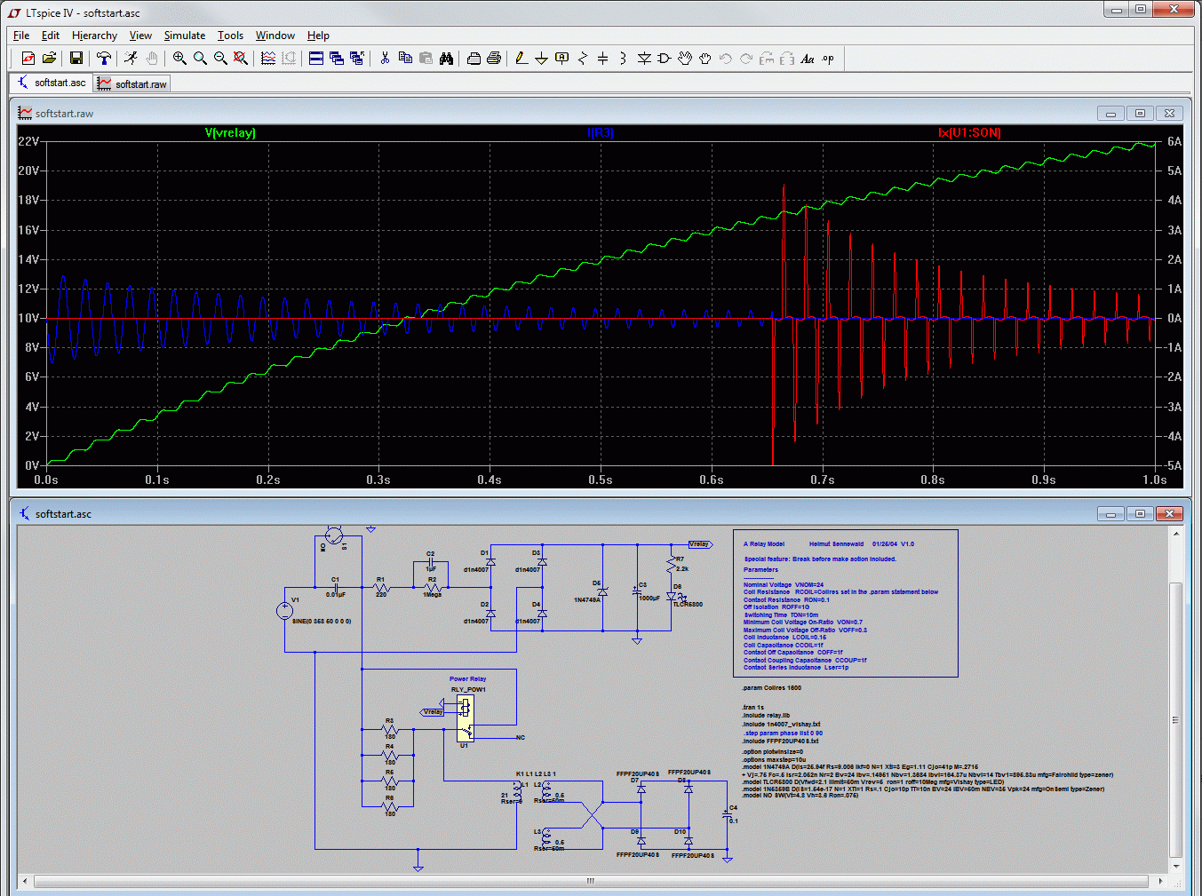

What do I do with all the other files in the .zip to allow the .asc to run with all the components in place?
I too like to run all the auxiliaries from a separate transformer or if suitable from separate windings on the main transformer........................Rod Elliott advises to use a small secondary transformer as supply for the delay circuit, and of course I have to use the 230Vac mains to switch-on the large toroidal transformer....but by 230Vac on the primary side and only 12Vac/100mA on the secondary, it is possible to use a soft-touch Swiss made quality switch to turn-on the delay circuit.
I like to keep a long distance from the 230Vac mains and low voltage circuits.........
Soft start and remote off/on using LV touch switch are but two examples that particularly suit a separate isolation transformer fed from it's own Mains fuse.
Is this question in relation to the zip I posted? If 'yes':
- you can just leave everything in the folder. If all .asc, .lib files and .asy symbol files are in the same folder then LTspice should run the models fine without change.
Here's what's in the folder:
- there are 4 .asc models in the folder. softstart.asc is a model of the DIYstore circuit. softstart-ntc.asc replaced the resistor bank with an ntc. The two 'hysteresis' models added Mark Johnson's suggested hysteresis to each of these. As you know, I really just continued to work with the softstart-hysteresis-ntc version to completion.
- the .plt models for each of the above is what is generated when you save the form of the plot output so that each time the model is run you don't need to add traces and set plot settings etc.
- the .asy files are symbols in LTspice. Non native (i.e. those not included in LTspcie by LT) need to be transported with the .asc file. Only rly_dpdt and ntc_resistor.asy are used in the hysteresis-ntc version.
- .lib or .txt files are model/subcircuit files that are linked to by .include statements in the .asc files. Saves cluttering the .asc file with .model statements. So if there is a need for a third-party model in the .asc model you need to describe it somewhere. You can see the .asc files are a mix of including sub circuit and model statements in external files via .include and some where I just included them in the .asc file itself.
So if ever you want to share your LTspice work with someone else (and as good practice anyway) it is important that all the necessary files are in the same folder as your .asc files. All the third party or self-created symbols, .model statements, .subcircuit statements etc. If they aren't all there, the .asc won't run properly. Never use local links to files stored in user directories for example as the person you want to share your work with will get an error that they can't link to the file on your computer.
Makes sense?

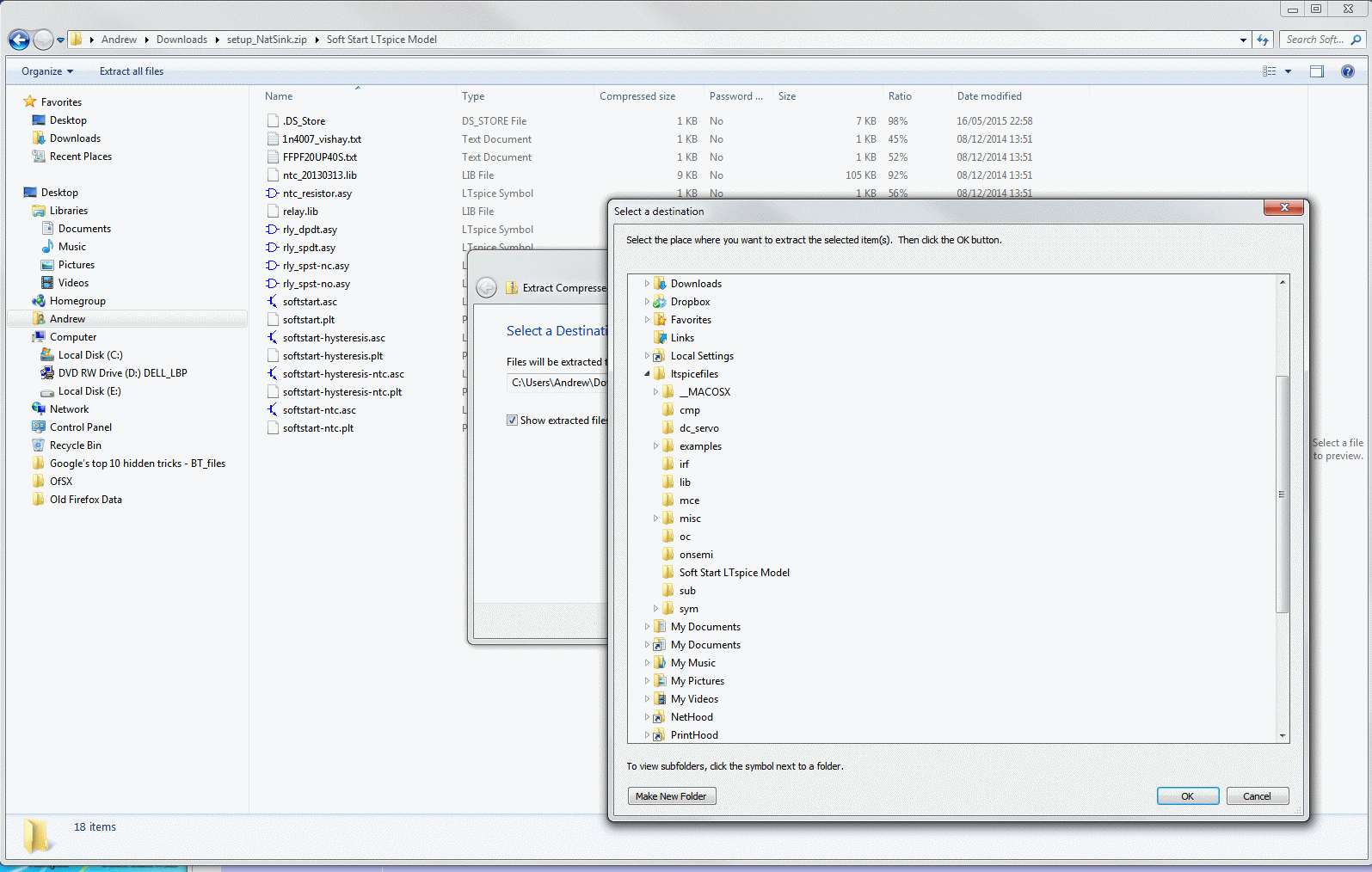

OK, I'll try again.
I could see the basic sch, but the relay and the NTC were missing and the warnings came up.
This is where the extracted files have ended up. "soft start LT spice model" just after the ONsemi directory
Is that right?
Note, I did not put them into the offered "download" directory.
Can I delete the Macosx directory?

It loads and runs.
Does the relay coil voltage (grn) rise like that?
It is desperately slow and will probably chatter as it reaches the first turn on voltage.
What is the red trace?
Where is the NTC?
Where is the NTC?
I can't see what's in the _MACOSX folder. If there is nothing in it then yes. I don't use Windows at home but I zipped a folder of files so you should be able to extract the folder as a whole (rather than the files individually). If not, the easiest thing is likely to select 'Make New Folder' which is perhaps what you did. (I can't see from your image what's in the folder Soft Start LTspice Model under ltspicefiles but the pane in the background has all the files in a folder under Downloads.)
In any event, just make sure everything is in the same folder. The error you got means the symbols files / .lib files etc weren't in the same place (or weren't extracted from the zip).
