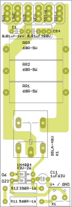

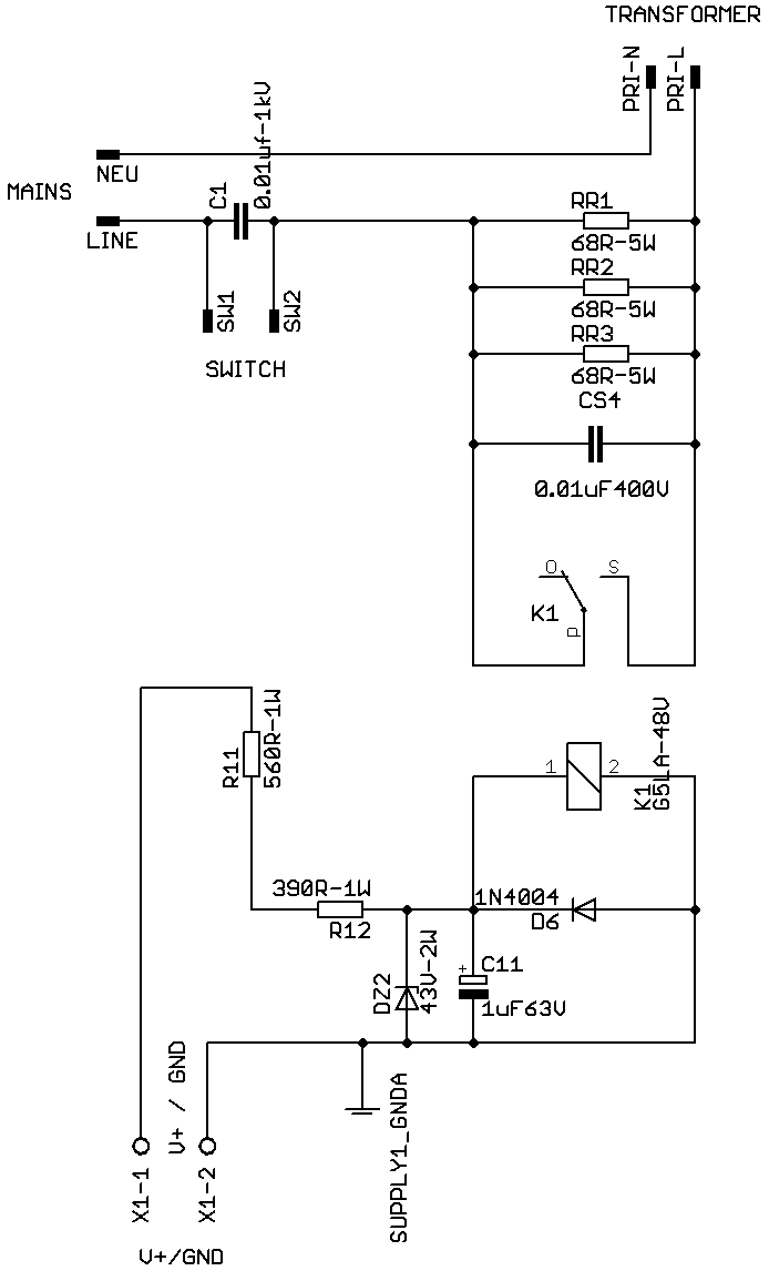

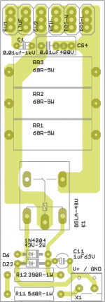

Hi all,
I am trying make a softstart for trafo(800VA with 60kuF downstream) using the TI app note http://www.ti.com/lit/an/snaa057b/snaa057b.pdf .
However, I am unsure of the clearances to be maintained for the mains application. I have currently kept the clearances as min 56mils between line and neutral and tried to separate the signals from mains as far as possible. Can someone take a look and comments?
reg
prasi
some designators are as follows
1. V+ is the signal of V+ from PSU and GND is the PSU ground.
2. PRI-N is the trafo primary wire where "neutral" is connected.
3. PRI-L is the trafo primary wire where "line" is connected.
4. SW1 and SW2 are the switch points for the "line".
reg
prasi
Also I want to be able to use this from +/-50VDC to +/-70VDC😀

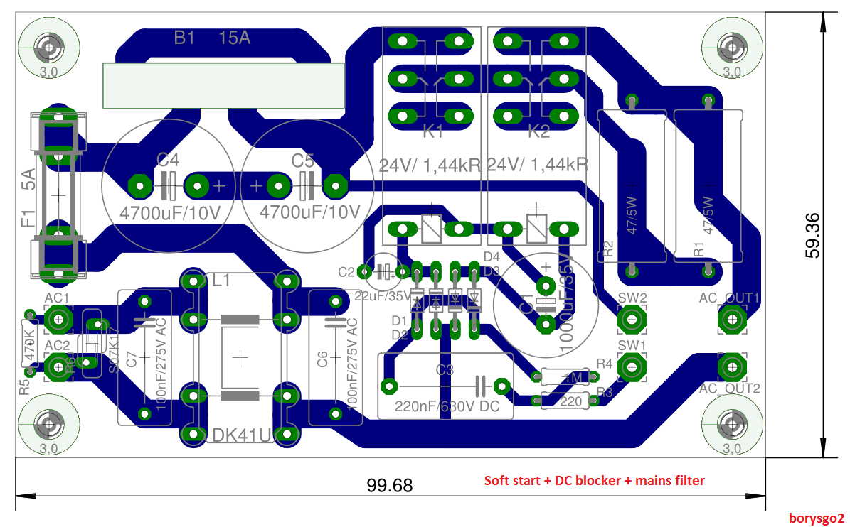

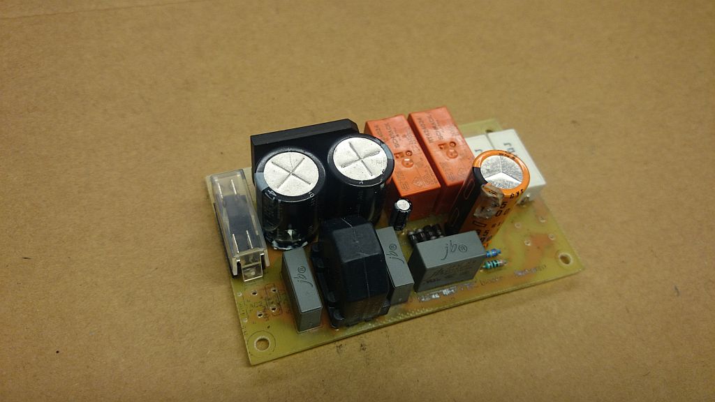

For a past few yeares I am using a bellow simple soft-start. Works really fine.
The power to the trafo can be switchen ON/OFF with a small current switch (approx 16-18mA). There is DC blocker and a bit of the mains filtration on the board.
The relays are powered by the reactance PSU (220nF capacitor). It may be usefull for someone.
But IMHO paralleling NTC with the triac is the modern way to go for.

Hi Borys,
Interesting implementation. Can you detail how the switch works? Also post layout? I would like understand the clearances used between mains and signal.

It works in very simple way. By shorting the SW pins (with small switch) you turning ON a small PSU for the relays. The PSU is made of 220nF capacitor, the reactance of that capacitor works like a constant current source, than voltage is rectified by the 4 diodes bridge and goes to the two relays connected in series. One of relays have 22uF capacitor and is switching the power ON to the transformer (threw the resistor network, reducing inrush current). After the big capacitor at the second relay is charged up the relay is shorting the inrush resistors and trafo gets what it wants.
I kept the clearances of 6-8mm in between the mains tracks on pcb.
I am going to prepare a new layout anyway.
Now it is very important to use 24V relays with 1.44kR coils. If differend relays are used the 220nF cap needs to be recalculated.
Regards.

Regarding my ckt posted (based on TI app note), Can some one guide me in selecting resistor values R11 and R12 and zener power rating for different supply voltages (from 50 to 70 VDC). I guess it will also depend upon the relay coil dissipation. I am thinking to use TE connectivity T90 relay that has 0.9W coil Power and res of 2560 ohms (36V pick up voltage).
reg
Prasi
